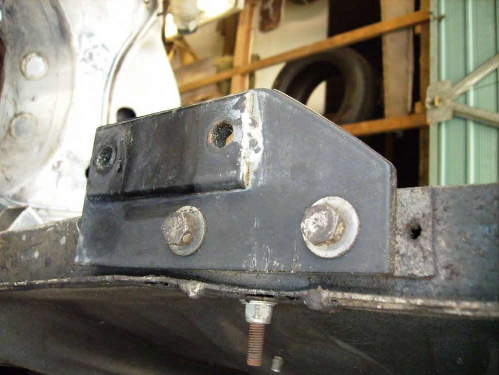

I have my suspension off my Mk2 at the moment, I converted it to R&P some years ago,
underside of ARB bracket,
Frame rail pic of ARB bracket,
Various X menber pics, I dont have any engine mounts fitted the X member as My engine is Chassis mounted
I hope these pics make sense. :rofl:
