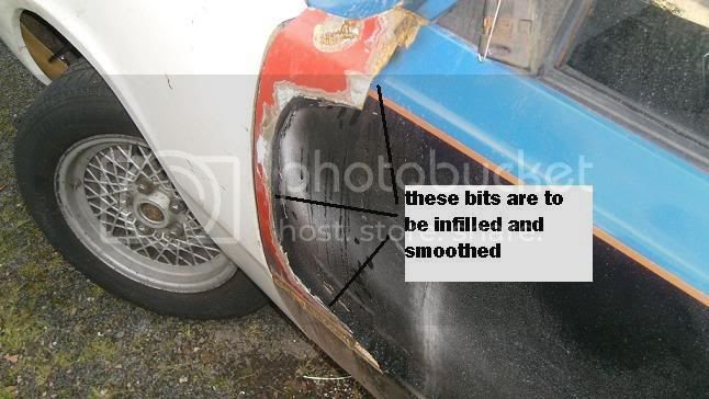

yes im doing it, its easy, wings, upper and lower front panels and bonnet, i dont put the slam panel on as i like to use bonnet pins and the screen panel beats into shape, im using the original doors and making dummy air vents from mk3 doors to blend in, the rad support panel is different and needs cutting and shaping to fit the mk3 front panel
the original pile
my new project
