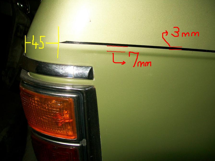

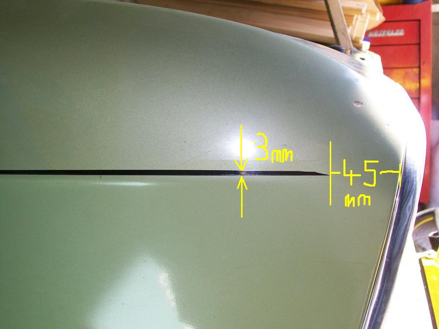

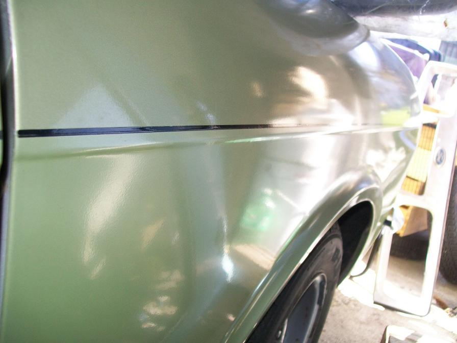

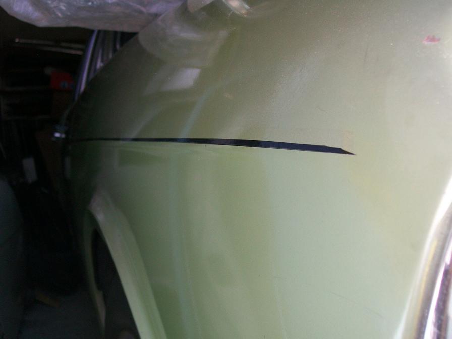

ok Steve, took a bit longer as intended, as i had to borrow my sisters notebook (my computer is again out of order, i really should invest in a new one, but with this stuff i m always very thight with money ;) ). measures are approximately taken from the upper edge of the pressing and the bottom of the trimline, as the red mark should show.
i hope the pics are useful and do come in time:

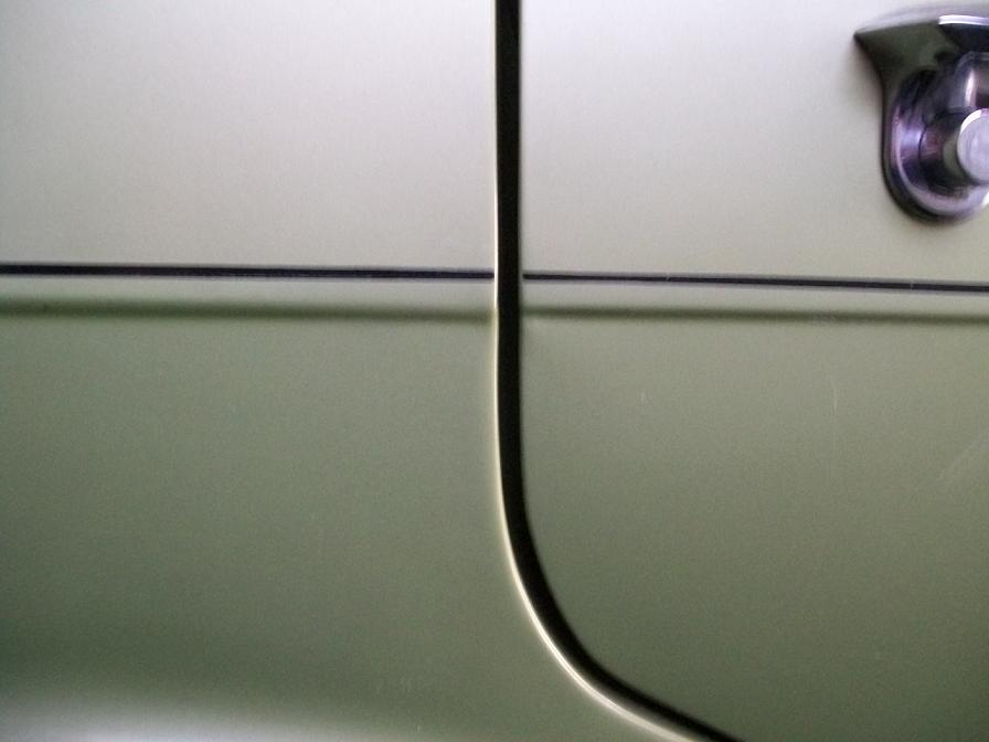

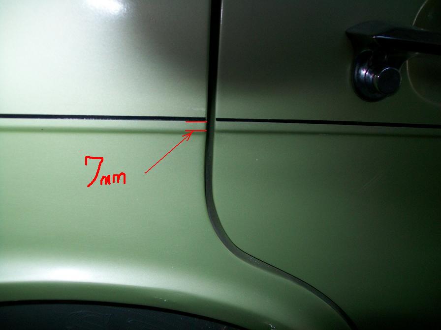

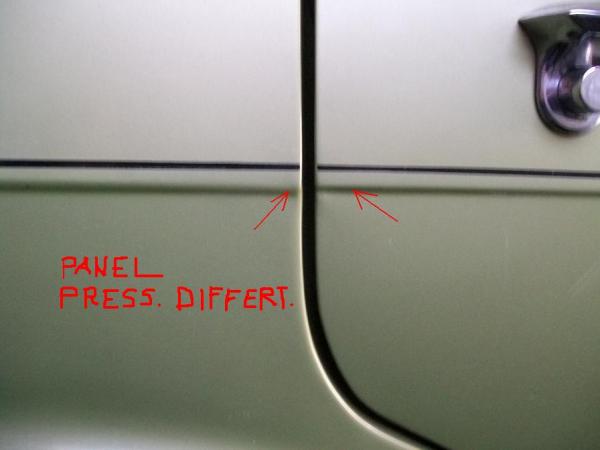

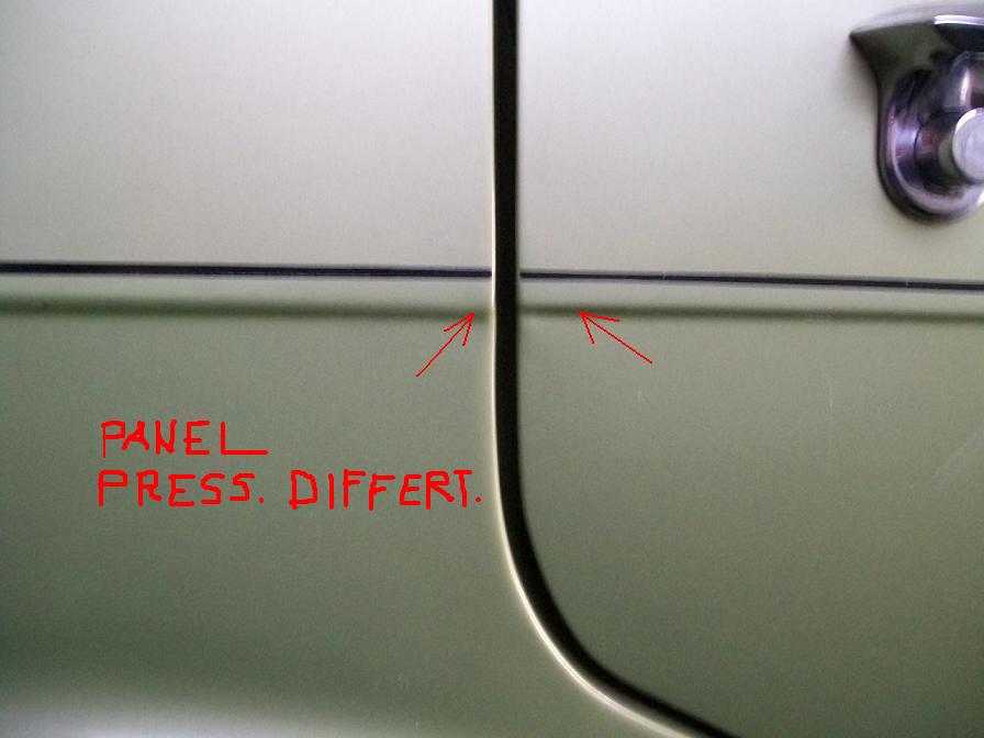

i have noticed that the panelpressings are a bit inaccurate if you view the moulding of the rear door compared with the rear 1/4panel but off course the stripe should run straight, if you know what i mean:
