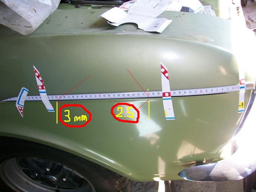

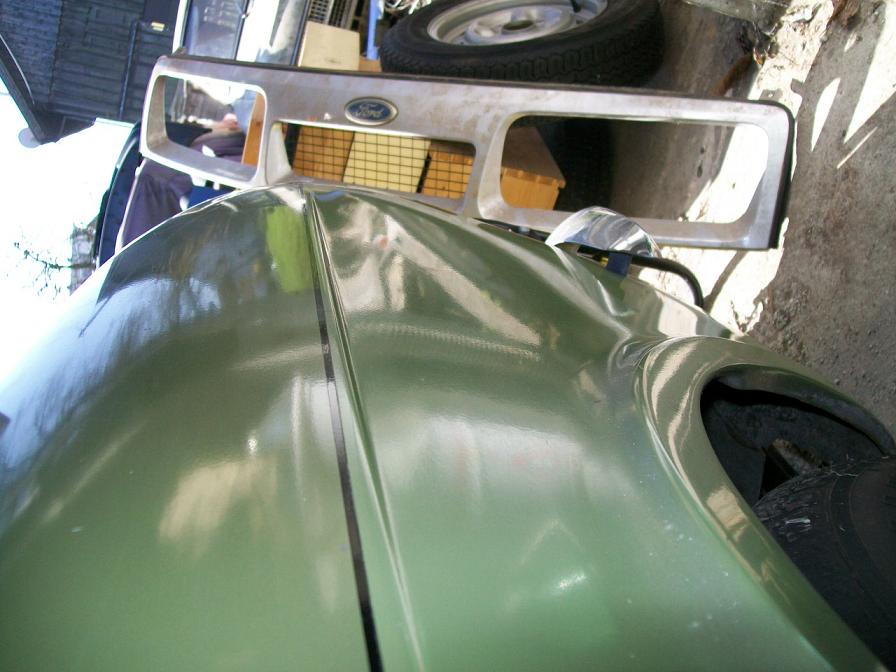

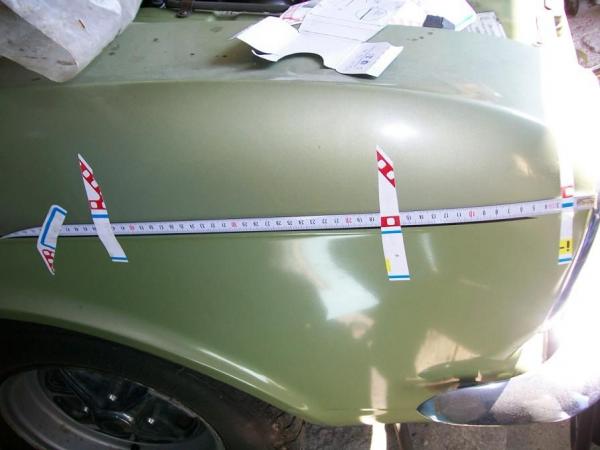

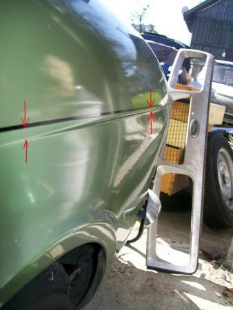

on the front wing the pinstripe runs narrower to the edge of the pressing (don t know how to express in English) the more it goes to the front:

Hans, what can I say??
You have obviously gone to a lot of trouble to obtain these measurements for me and I'm very, very greateful for your help. ;)
These piccys and measurements are perfect and I understand exactly what you mean about the stripe going closer to the swage line at the front of the car.
Thank you very much indeed mate ........ you're a champ :icecream:

you are welcome Steve and i hope you can use the pics for the paintshop.

I have to say those pics that chap put up with the measurements just don't look right, i'm sure it sits 3mm above the crease right the way along the car, it does'nt rise and fall at any point !
