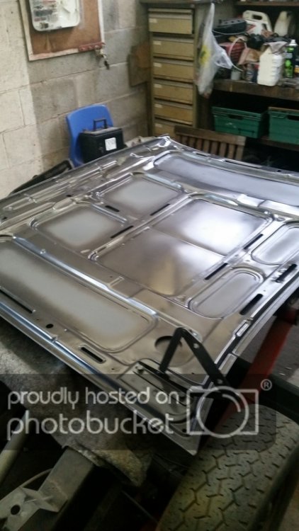

Bonnet underside coming on. Rust removed, Kurust applied, primer on and filler primer where needed:

Bit more on the underside of the bonnet:
I did this with rattle cans as I only just have enough left of my origional can of paint to cover 1 side of the bonnet, so I want it to be the top so it matches lol. Ran out of cans so I am going to put sound deadening on the flat bits that I have left unsprayed.
