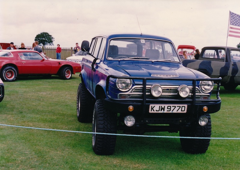

markie2 0 Posted August 23, 2014 mk1 sitting on scooby floor plan Quote Share this post Link to post Share on other sites
RLH487W 0 Posted August 23, 2014 mk1 sitting on scooby floor plan Any more info or photos? Quote Share this post Link to post Share on other sites
Pete-H 69 Posted August 23, 2014 Yes start a forum thread on your Car please? Quote Share this post Link to post Share on other sites
Captin Crayford 2 Posted August 26, 2014 Hi All Not sure if this one has been posted before buy been in the archives box for a while. Quote Share this post Link to post Share on other sites
