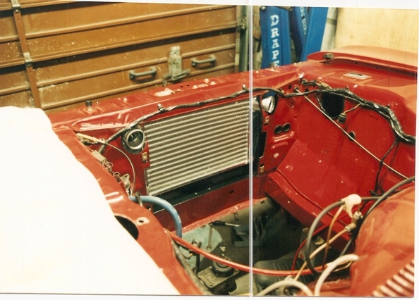

any one help with pictures for rad and inter cooler what i need to cut out for it to fit in
Thanks
It's good to see you are getting on with your car.
My engine sits in about the same position as yours about inch off the bulk head, I placed my intercooler under the slam panel and cut holes for the pipe work in the rad panels and the rad sits in the original position. Serc Marsden made the rad and intercooler. A cheaper way to do it is to get two 2wd coolers place one on top of the other and fabricate two longer ends, this has the same capacity as a 500 one. I didn't have to cut the shell to much as it is a auto car and has a wider trans tunnel.
Cheer Pete.
Cheer Pete.
i was thinking of getting one made to fit my mk2
im looking in to it this week got a rad place near me to make me one just got to give him size :thumbup:
Thanks for pictures looks good and has give me a better view on this so ill se what it cost :icecream:
