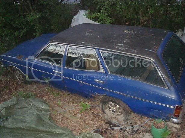

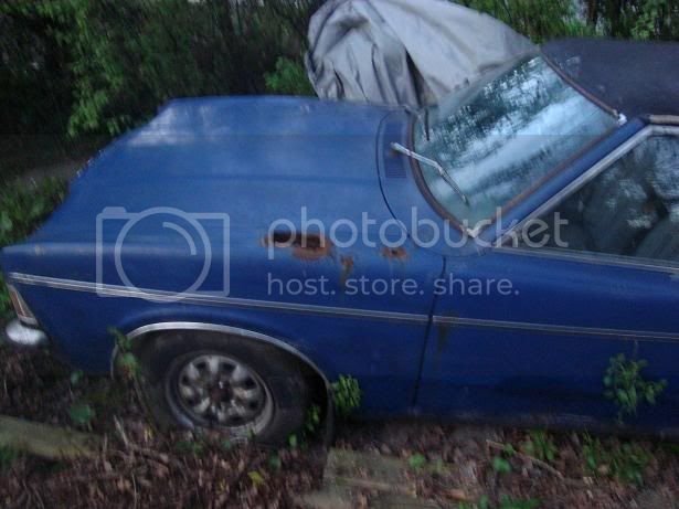

JimbobX 0 Posted April 21, 2011 Here she is. Looks much worse than I thought. Is there any good news at all? Quote Share this post Link to post Share on other sites
FKLGLS 44 Posted April 21, 2011 You sir are a brave man indeed ! How long have you had it ? A 2000E estate must be a pretty rare thing now. I'll watch this thread with interest. :thumbup: Quote Share this post Link to post Share on other sites
JimbobX 0 Posted April 21, 2011 You sir are a brave man indeed ! How long have you had it ? A 2000E estate must be a pretty rare thing now. I'll watch this thread with interest. :thumbup: I think rather clueless than brave :)Had it since 1999ish. I plan to do just the simple bits and then hand any welding & bodywork over. I really need to know all the bits that a novice can do. What can I do to prep it for the guy who's doing the tough stuff? The wings/front fenders? (the bits either side of the bonnet) they appear to be bolt on. I think I can handle that if someone points me to some repro parts. Quote Share this post Link to post Share on other sites
FKLGLS 44 Posted April 21, 2011 Thats right mate, the front wings do unbolt. You are in a similar position to me in that I have a mk3 that needs the front wings replacing. Smith and Deakin supply fibre glss wings for £90 per side plus carriage, and from what I have found so far in my search for wings, you can expect to pay a similar amount for a second hand steel wing that needs work. As for new pattern wings, they will fetch approx £250+ (a pair) and for new, genuine Ford wings anything between £400-£500 for a pair. A friend is helping me out with some steel wings so I may have a pair of good used fibre glass ones if you are interested. The good thing about your car is that the doors are bolted on too. I am looking at each door, one at a time and if they are too far gone, sourcing a good replacement and doing all the preparation work off the car so that I can still use it and then swop over each door as it is completed. I'm doing it this way so that I can still use the car. I would assume that your car isn't quite roadworthy yet, so you could remove the doors and work on them at your leisure. :thumbup: Quote Share this post Link to post Share on other sites
