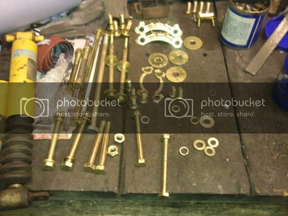

replated xmember bolts

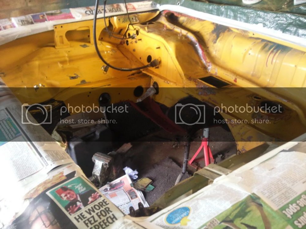

engine bay before
and after

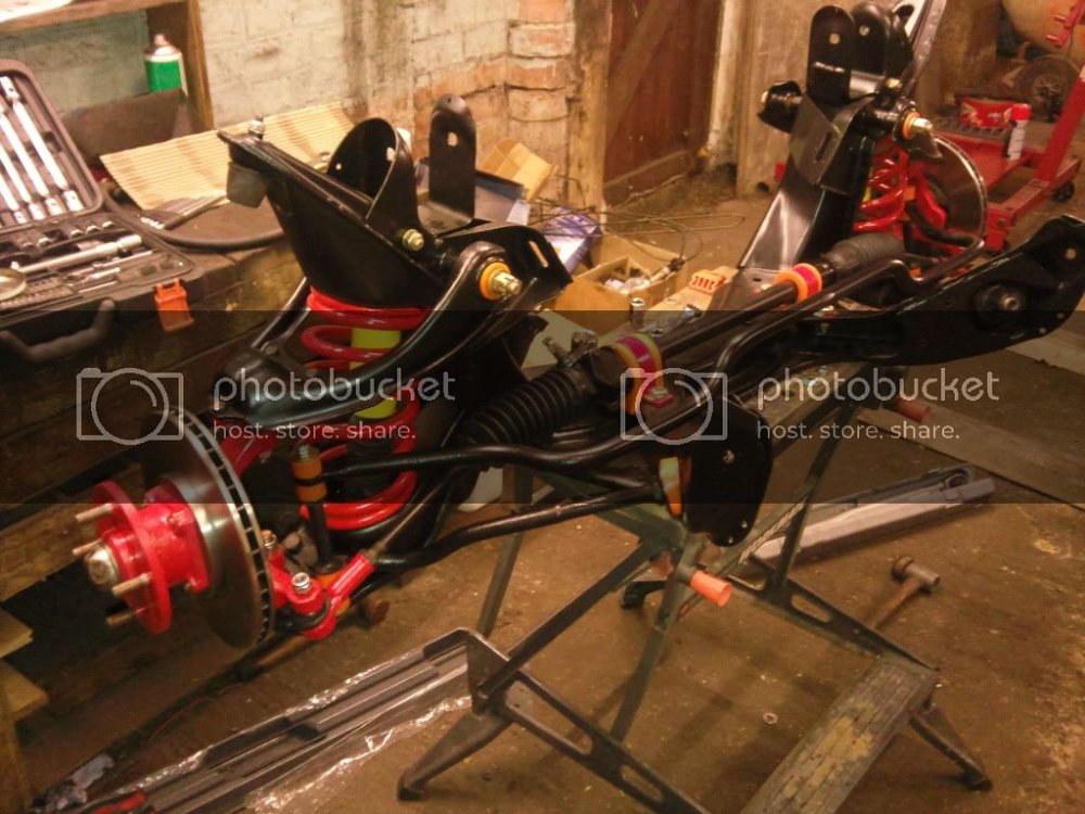

x member all built, well nearly
engine bay before
and after

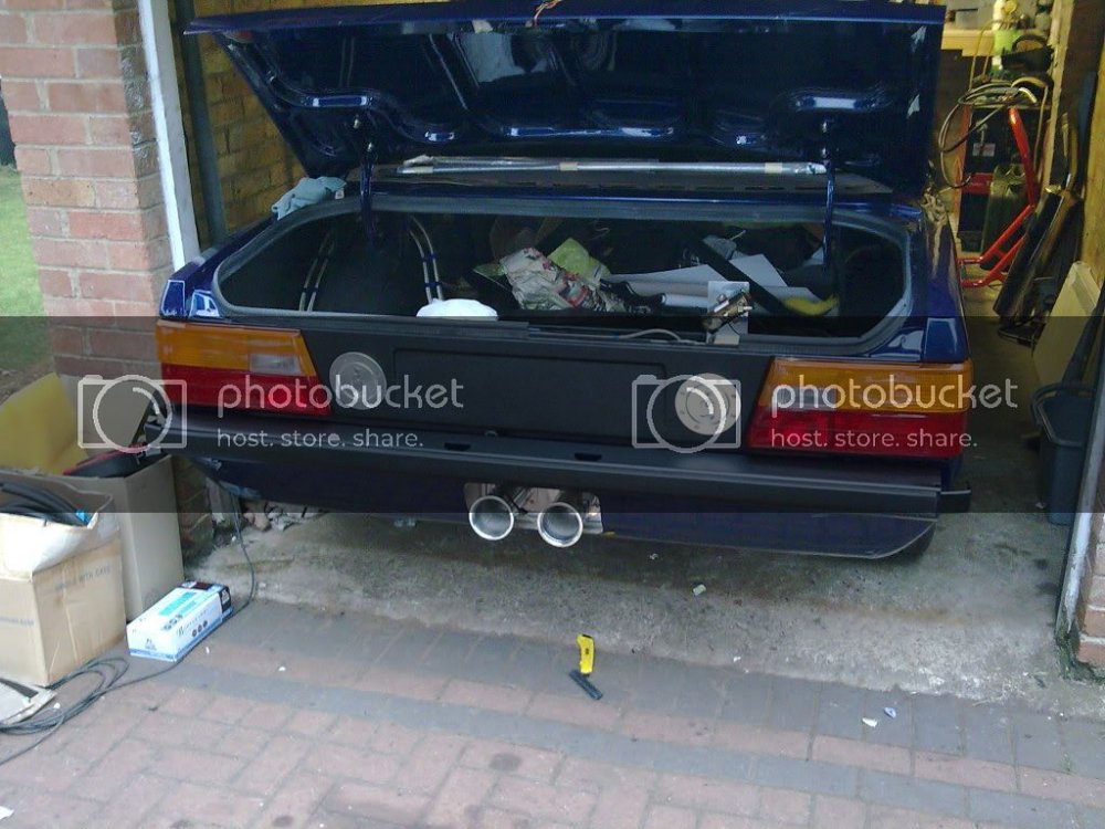

love this car mate love the tail pipes :icecream:

thanks jaymk5, i made the tail pipes about 13 years ago, all stainless steel and polished, will be the next job to connect em to
the engine once i get it back in hopefully in a couple of weeks :thumbup:
