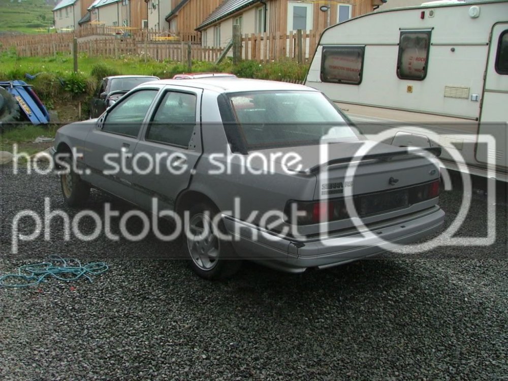

After the last disaster when looking for a Sierra Shell I kind of held back untill after the winter. Spring is Here and this is mine.
So it looks like full steam ahead at last.
You've butchered and murdered this Sierra :D
:rofl: Believe me the engine bay is the only good bit of the floor i can provide photos if you want.
