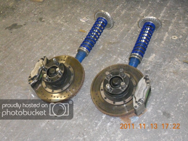

Update on progress of my MK2 as it has been ages since last posting.
I have done away with the 4 link, and put back on leafs (Escort MK2 1500lb) and made up tramp bars and mounts and softer springs on front, to make it a bit more easy going on me!
Also strenghend both chassis rails over axle, welded bars on boot as there has been a bit of flexing in the rear of the car. If you are going to use 4 link setup the car needs to be full caged. I have repaired the rear wing, and other bits on the shell ready for repaint soon.
Pete.
Will post up some photos tomorrow.
Have you made up your mind whether or not you are going to keep it or sell it on Pete .
Here is the pictures as Pete was having trouble uploading them...
More to come
More
and theres more
More
Thats it for now...

I would like to get it back on the road again, enjoy it for a little while, but will sell it in the end.
