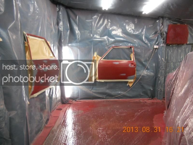

Due to helping my mate work on his Sunbeam Tiger which from a rear arch repair bottom corner turned into a major rebuild! It look ok before we started. This put me back the first part of the year, but now the Cortina is finally in paint. Had a nightmare with silicones. I think due to autoglym super resin polish I used a few years back,it's a right to remove it all.

Superb :thumbup: , what did you do to get rid of the sillycones, got problems with my GT, and that funnily enough has had the same polish treatment, have panel wiped and Barcoated, but still some areas aren't right for painting :headscratch: any advice appreciated as it looks like your issues are far behind you now, do like the look of your motor and the wheels are perfect :winner:
Thanks for the comments,sounds like you have the same problem as I had. What I did was wet flatted the affected panels first,cleaned down with brake disc cleaner,then with Wurth silicone remover, and lastly panel wipe. I presume you are using 2K paint, you can get silicone additive to put in the paint. I've used this, and sorts the problem out.
Pete :cheers: .

Cheers for that info, yes I am using 2k products, will get some additive, feel like I've been flatting down for months, nearlly there though, :thumbup:
Just a update and progress on my car so far. All painted,mopped and polished and started fitting back together.A few more jobs to do. Hope to be at Enfield Pagent next year.
