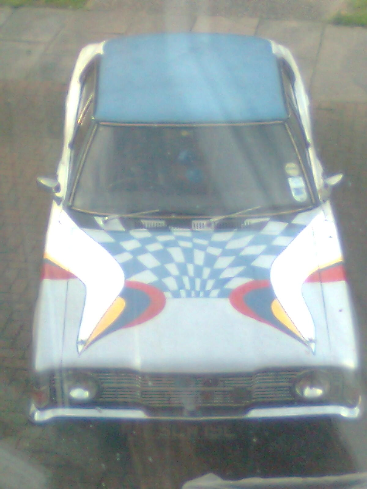

You can always use a big brush :thumbup: till funds are available.
If I end up having to paint the car myself then going to have to be in a hard color. I've never painted a car before and after spending time surfing the net. I can see Nowt but problems should I try to spray the car in met colors. As for using a paint brush. :)
Naaaa mate. Nice pic though.
