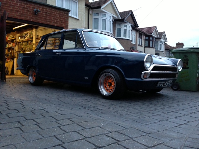

Its getting there, hopefully be in primer this week.
Edited by escort21
Looking good
