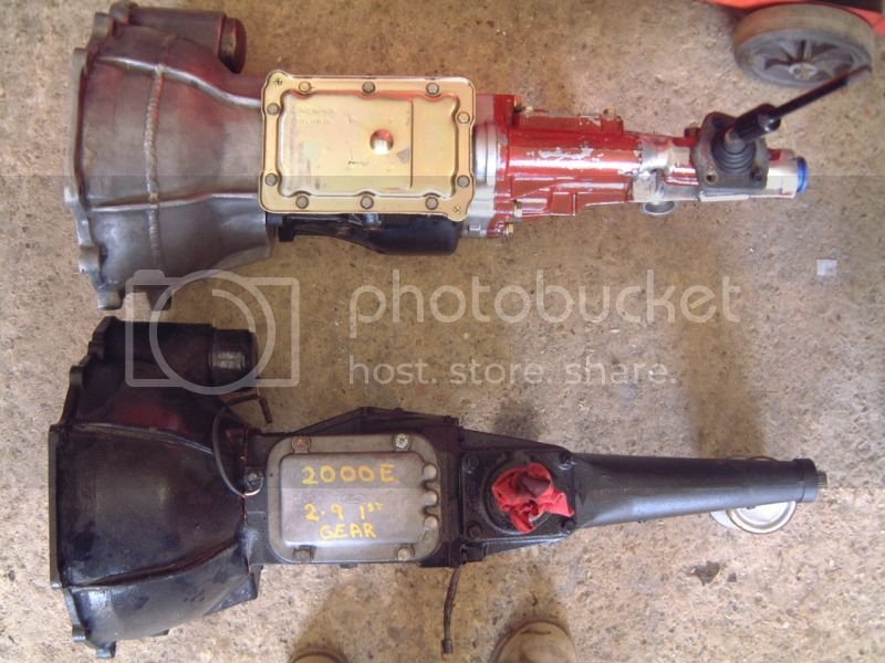

No, a 1500/2000e (3 rail) box is 1/2" longer than a Type 9 believe it or not. The type 9 yoke is 1/2" longer in the body of the joint( not the long slidy bit). So takes up the difference, if of course you are putting everything exactly as it was.
This pic shows them side by side. I took the 2000e out of my Anglia and changed it for the type 9. The engine position stayed exactly the same. I just changed the yoke on the 105speed propshaft and it all matched perfectly. At the time I didn't realise the 2000e was longer either. Always thought the T9 was longer. Thats not to say about any other boxes, I've not tried those.
well i'd never of thought that! the series 2 single rail must be the same length as well, i must be thinking like the mk2escort box with fixed bellhousing is shorter the mk2 cortina boxes were aswell. thanks for that :thumbup:
