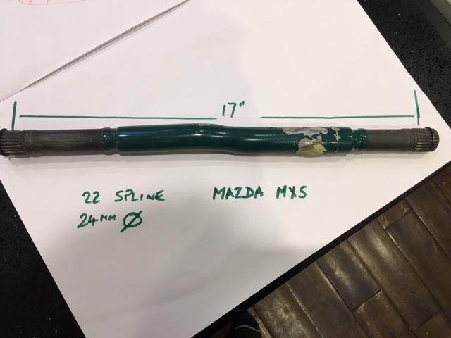

What did you make those shafts out of ?
Thought those type of shafts were solid steel ?
I have some Mazda rx7 shafts, I'll try and measure etc

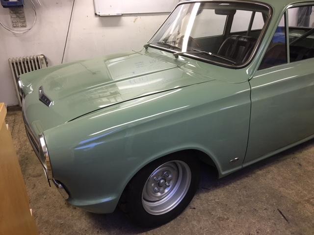

A little update, car is nearly finished, just waiting for the driveshaft's and gearbox tunnel cover to arrive and then its a quick job to fit them..

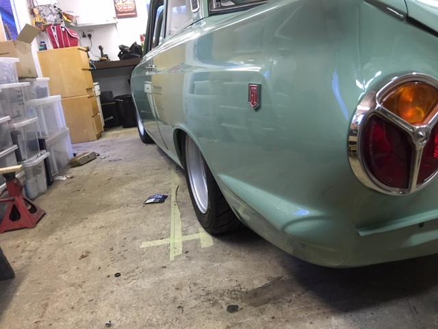

I also raised the suspension by 20mm as after driving it to the failed MOT journey I found it was way too low, especially when avoiding pot holes. I think the car looks better.

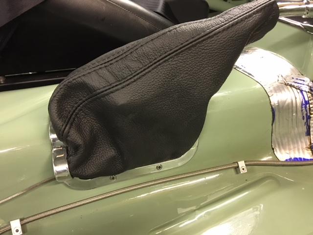

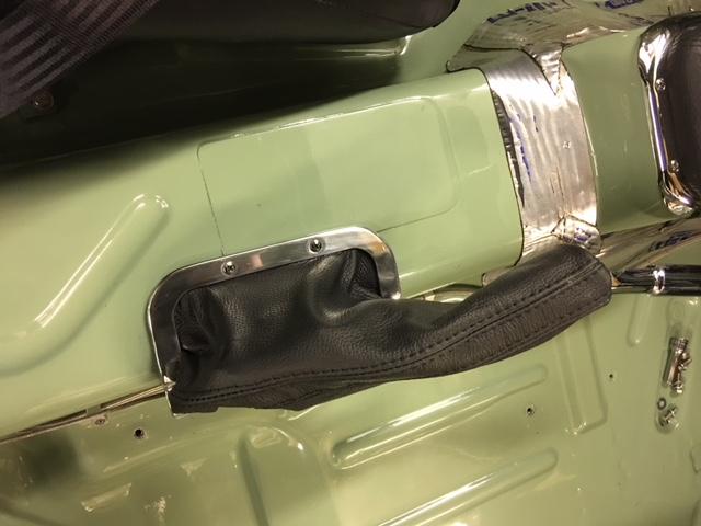

Handbrake works well and here are some pictures of the lever all finished.
