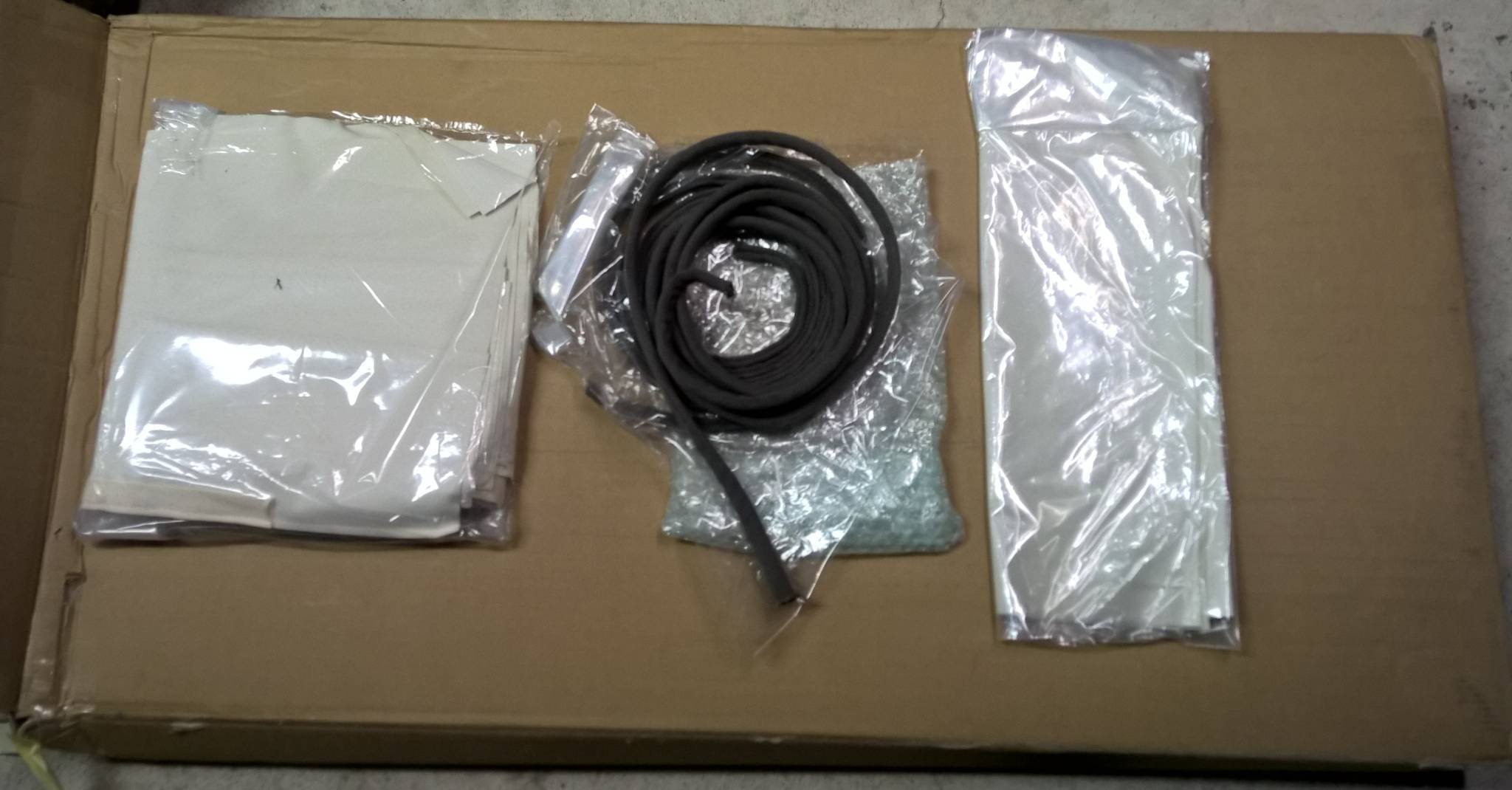

I went with Aldridge trimming based on their reputation and indeed they were a pleasure to deal with. Seemed genuinely nice and accomodating people.  No real issues on the goods delivered either, let's take a closer look:

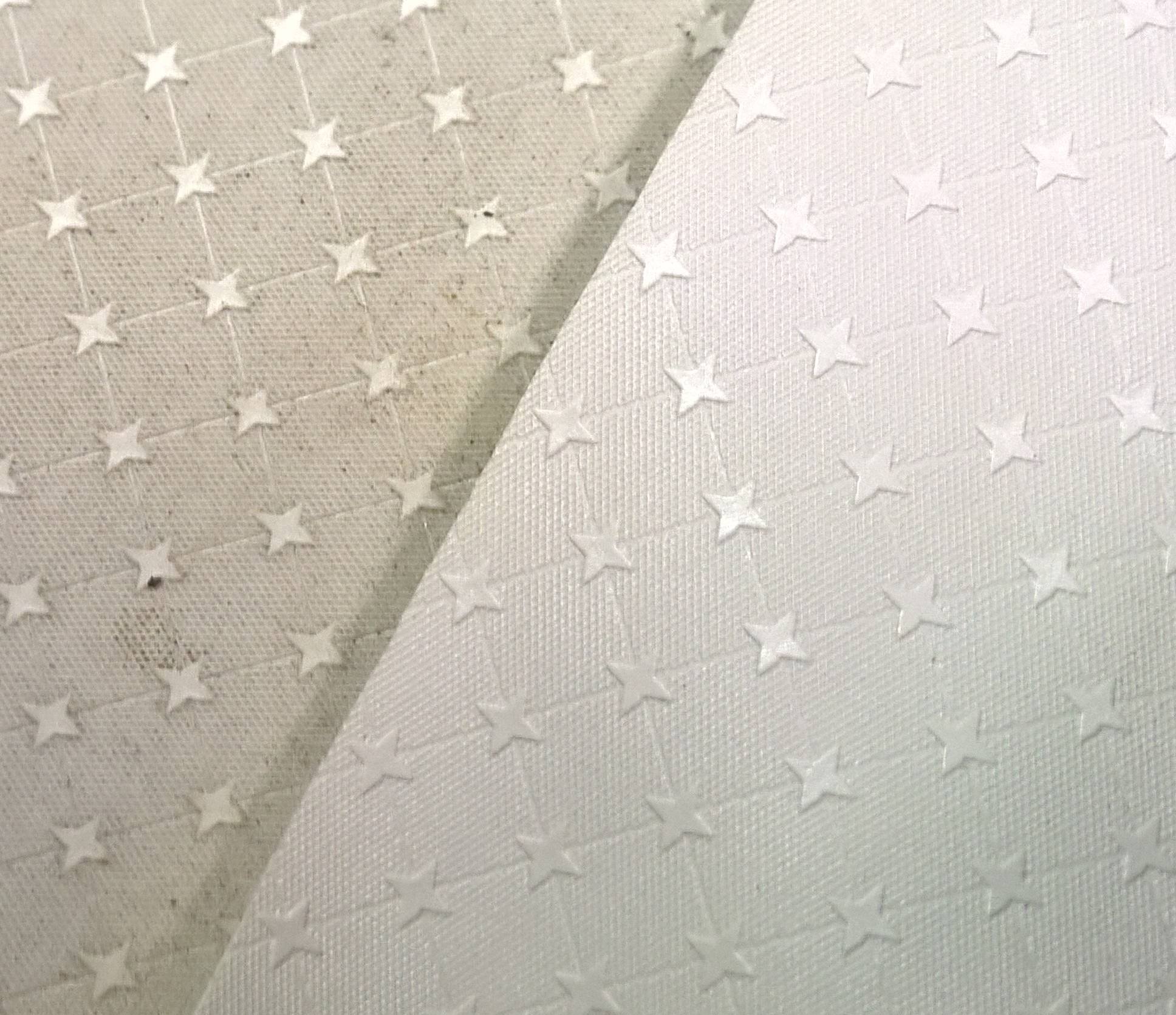

Original Headliner on the left. Spot on. Nothing that even the most ardent rivet counting anorak can complain on :smile:  I did not unravel the whole headliner but i have all the confidence that the measurements are right.
My original door edge trim was blue but that is not available so on Aldridges recommendation i went with the grey. Looks great and the length is correct with a little to spare. I did not like that they were taped together with masking tape but since i removed that right a way there was no harm done. We all know how well masking tape ages..

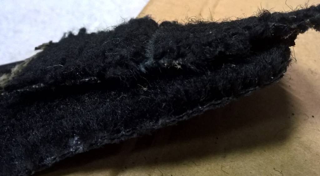

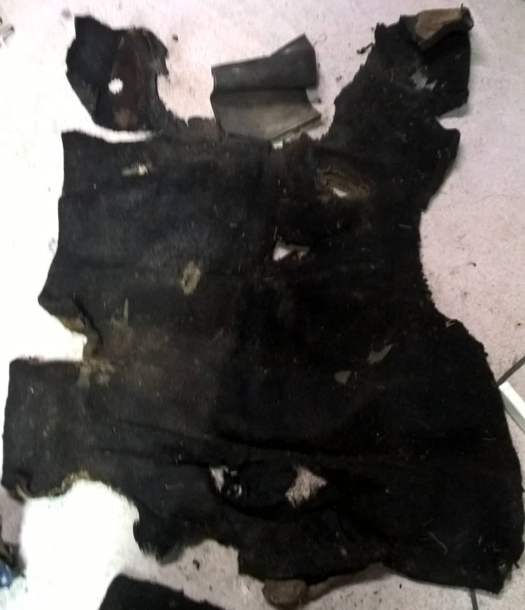

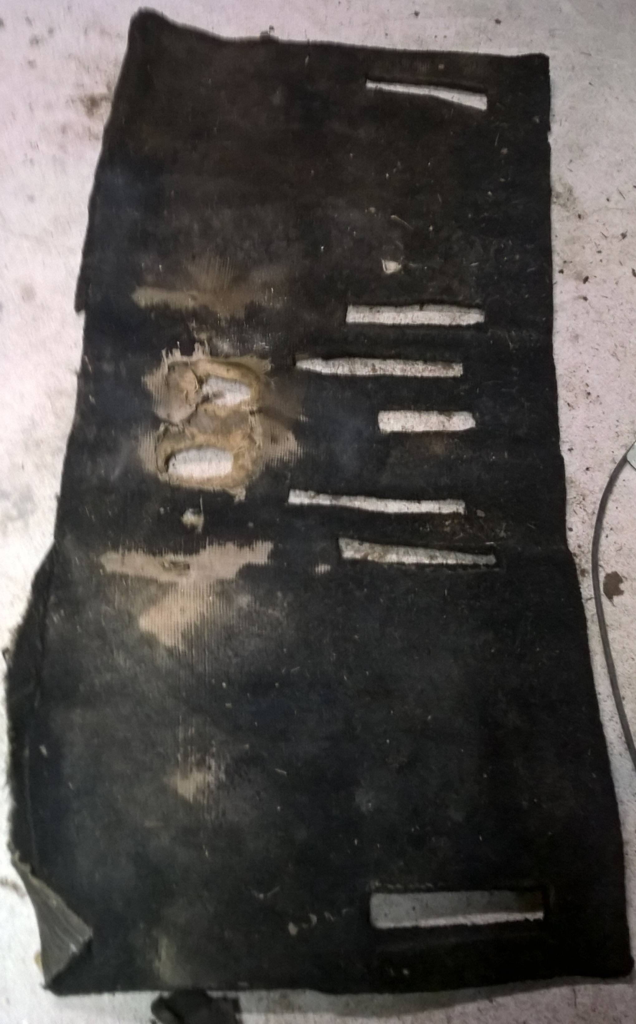

Here is what was left of my original carpets. There are small differences compared to new carpets. On the old carpet edges are folded over underlay which the new carpet does not come with. Instead on the new carpet visible edges are piped. This will allow better synthetic underlay materials of my choice to be used.
To nitpick a little the wear protector under the pedals is vinyl instead of molded rubber but that is completely understandable.
Original underlay is ca. 6mm thick, little thinner in select areas.

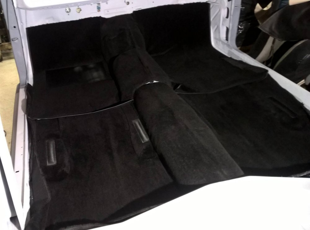

Could not resist on doing a quick test fit.
Looks a bit baggy since there is no underlay present and i only threw it in there. Should be just fine when properly installed.

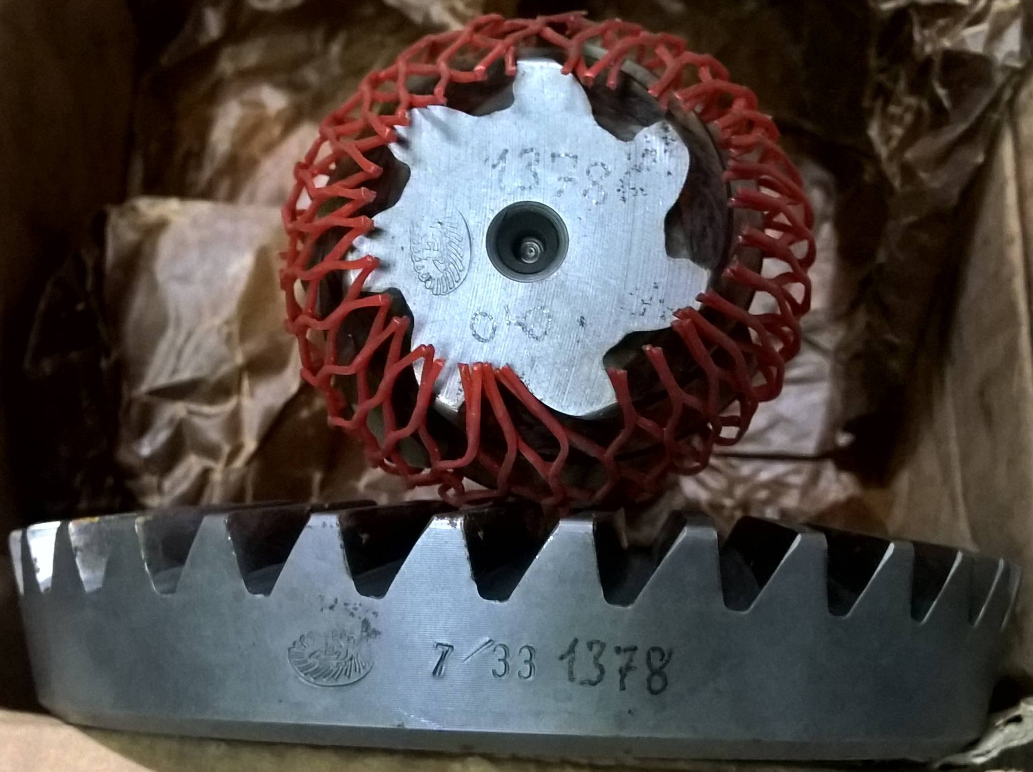

A little while back i bought a second hand pinion and crownwheel set, was sensibly priced at 30€ and in very good condition.
Because i was in a bit of a rush i did the calculations later at home, the axle ratio with this set would be 4.714:1 (7 teeth pinion, 33 teeth crownwheel, headspacing electro pencilled on the gears?). With these the engine would scream like a banshee on the highway, Oopsie!
Original ratio on mine would be 3.889:1. Not a big loss though, these should be easy to resell .
