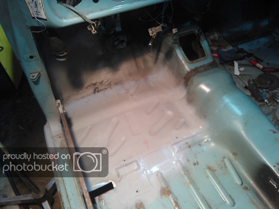

LagoonBlue 146 Posted April 18, 2014 Thanks to everyone for the kind works here at BSC and in real life, slowly getting the hang of all this diabetes stuff... On the upside of things, finally managed to get a good full day working with the car and got the drivers side floor panel sorted, no more flintstones mobile for LagoonBlue :D Even managed to replicate the swaging (if that's the right word for it?) on the floor panel. Used a ballpeen hammer, some scraps of wood and a bag of sand. Not perfect by any means but secretly i'm kinda proud of it as this is the larges and most intricate panel i have made to date ^_^ Paint is only temporary, i'm thinking of having the car hydroblasted after welding is done. Quote Share this post Link to post Share on other sites

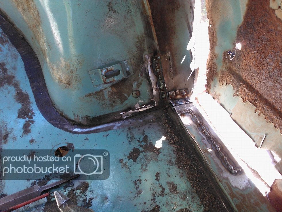

LagoonBlue 146 Posted May 1, 2014 Some more work done with the cortina B) I made a path panel to passenger side inner sill and welded it on. I had done this bit in the beginning but it had distorted quite badly when welded, this time around i made sure to brace the sill with angle iron and clamps and made only small welds. Came out ok. Shame that i have only 925mm wide sheet in stock as i would of rather made this bit with only one piece. Still loads of more to do, before even thinking about a rotisserie i will complete the sills as the shell will be stronger that way, maybe even add some more bracing inside before that :headscratch: Not pictured are all the small bits and bobs that i have done, got a shelf full of those ready. Progress is slow as i'm learning as i do and having to pace myself so that my BG levels don't go too low. But i'm not in a hurry with this resto, quite good therapy in fact :lol: Quote Share this post Link to post Share on other sites

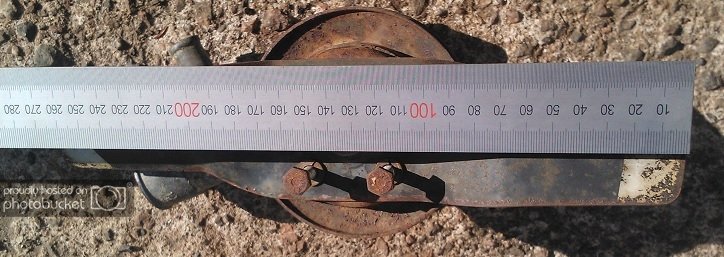

LagoonBlue 146 Posted May 25, 2014 A wee bit of progress again.. Cleaned the tank, and what a pig of a job that was :angry2: But under a generous layer of underseal, dust and crud was a nice solid unit, albeit slightly dented. Washed the insides with petrol, diesel, turpentine, denatured alcohol, Würth pineline and water. Basically with everything that i had in hand :lol: Denatured alcohol seemed to work best for cleaning the solidified petrol remains (luckily there had been a sniff left as that had keeped oxygen away) Fuel sender seal is a standard size O-ring, but i lost the receipt and allready forgot the dimensions :blush: Wirebrushed; I removed underseal with heat gun and scraper, and after that sprayed with turpentine and cleaned with a rag followed by light wire brushing. Primered with 2-pack epoxy compatible with zinc plating; This was my first time spraying with epoxy primer and i most likely thinned the paint too little or had a too small nozzle as the result was somewhat rough. I'll finish with hammerite gloss black. Inner sill work; I finally found the right recipe for not warping the metal while welding :thumbup: Brace with angle iron where ever possible, keep the welds short (1,5-2cm) working in different sections at a time and follow each weld with compressed air to cool it. Quote Share this post Link to post Share on other sites

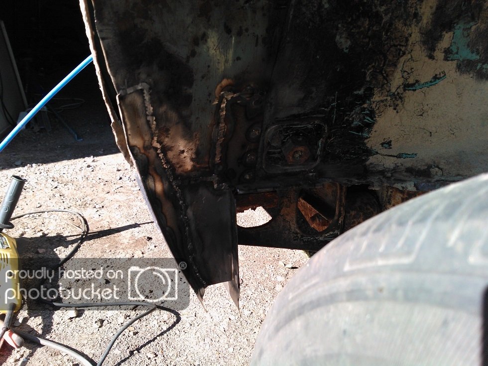

LagoonBlue 146 Posted June 1, 2014 Work continues... Managed to fabricate right side sill end, this was fairly complex piece to make so i had to patch it together from several pieces. This section had been hacked previously which did not help. Gotta love those 80's bodges for MOT :thumbdown: Rear arch had been repaired (pop riveted in place :huh: ) at some point and did not seem to fit properly. At that point i noticed that they are not even form a Cortina but snipped from Escort or some other car. So i have to source those too before i can finish the sill end :angry2: Maybe i should change my username to BadLuckPete :lol: Ah, the joys of restoring old cars. Quote Share this post Link to post Share on other sites
