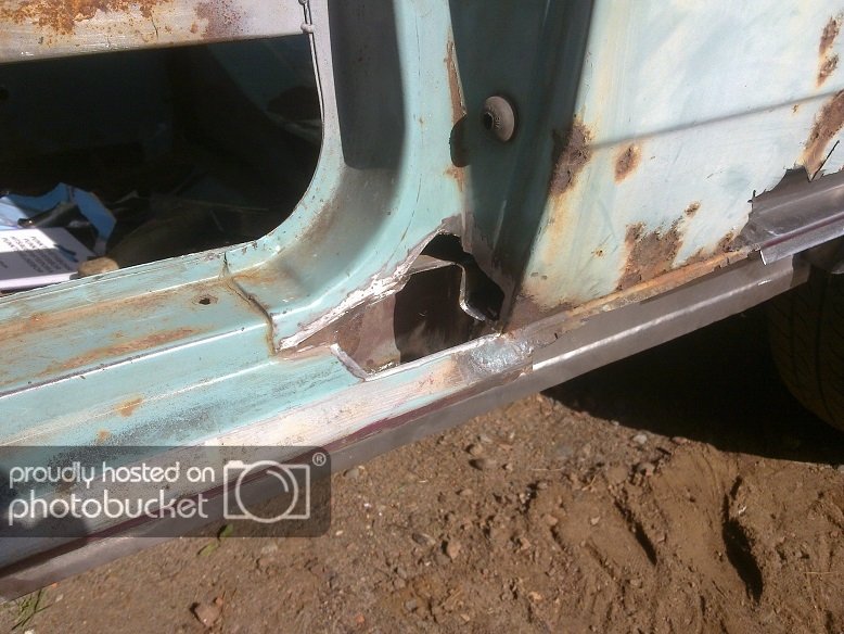

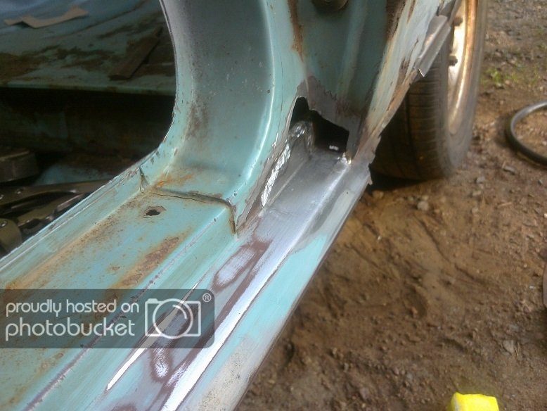

LagoonBlue 146 Posted June 6, 2014 Another couple evenings with the Cortina. Still undecided what to do with the spare front fenders, are they too far gone to save? Suggestions, opinions anyone? In the meantime fixed rot in the bottom of B-pillar, seems to be a problem area in these. And here some pics :thumbup: A lick of weld-thru zinc primer between the panels That shiny spot in the middle is my first attempt at lead filling, not too stellar looking that :unsure: Some primer for now, needs filler though. I'm getting better at welding as i go along, might visit some previously done areas at some point. And why on earth are there tire valve stems on the pillars :headscratch: Also painted the tank with Hammerite. Drying time is around 3-4 weeks from previous experience... Quote Share this post Link to post Share on other sites
the-ford-cortina.com 226 Posted June 6, 2014 And why on earth are there tire valve stems on the pillars :headscratch: because someone didnt have the proper rubber buffers to go there and improvised Quote Share this post Link to post Share on other sites
LagoonBlue 146 Posted June 13, 2014 because someone didnt have the proper rubber buffers to go there and improvised Well that makes sense :thumbup: Might even leave those there, period mod you see :lol: Quote Share this post Link to post Share on other sites
