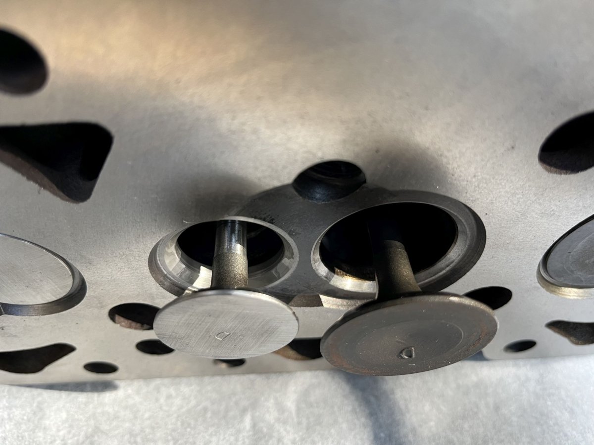

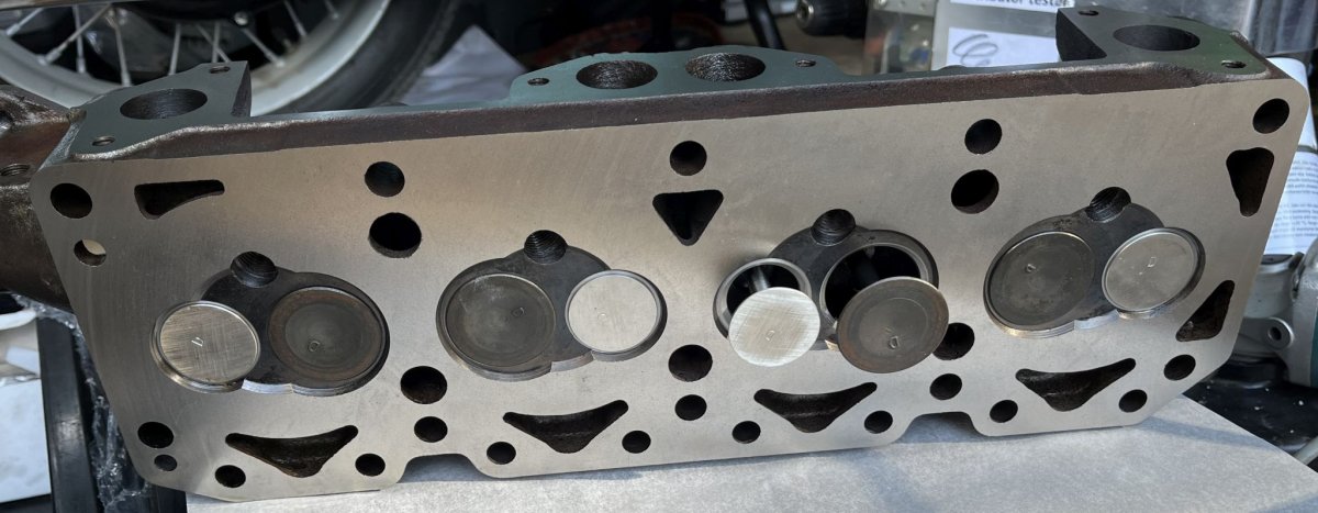

Anyhow here is the underside of the head;
And here you can see the hardened exhaust valve seat;

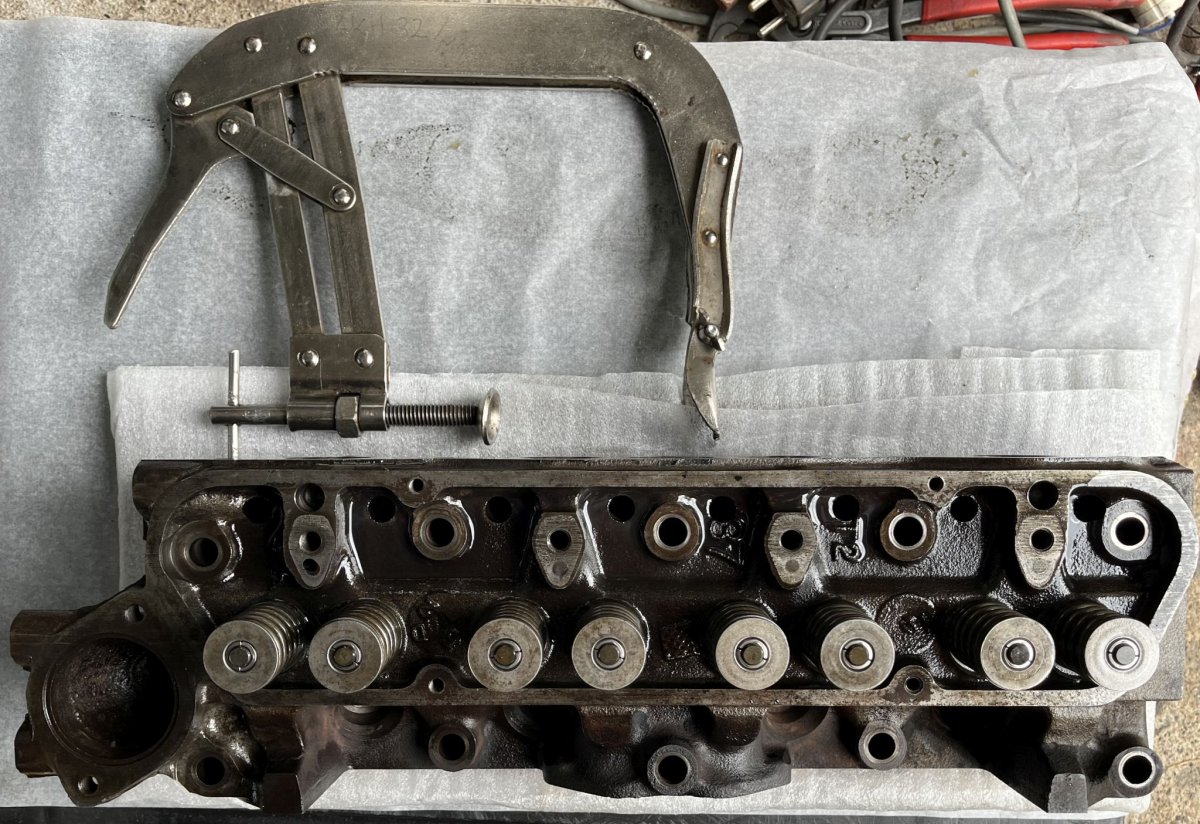

So good time as any to put some bits back together;
Used some rather primitive tools but then again so is the Xflow.. Had to do this twice as there was still some crud left in the nook and crannies of the casting. I used the best set of stock springs and retainer plates I had. New valve retainers and (obviously) new valve stem seals. Somehow i forgot to change the core plug at the end of the casting, seemed to be just fine but would be a pain to change later if it starts to leak. Should have couple in the shelve so will do that next time.

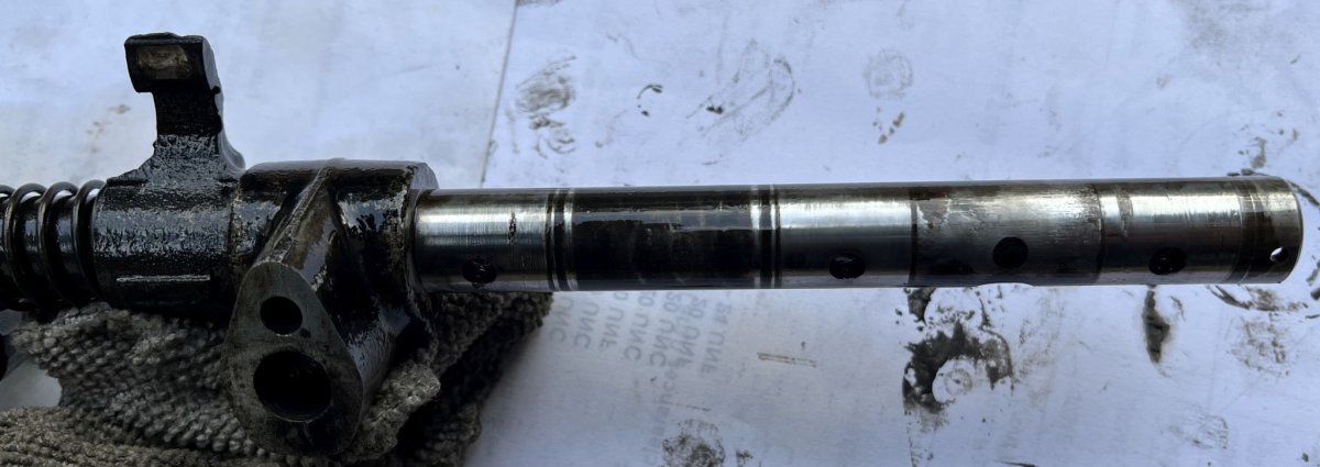

Since I had a little bit time left I took a quick look at the rocker shaft;
Too worn:thumbdown: I might have a spare hidden somewhere though probably as worn as this one. Luckily not overly expensive to replace provided that the arms are good enough to reuse.

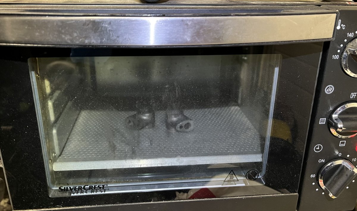

I really did not want to scratch my shiny new rocker shaft so I warmed up the aluminium post in a toaster oven before assembly;
This really did help. Only twice I managed to get the rockers on in the wrong orientation.. New cotter pins were fitted at the ends.

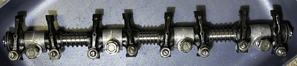

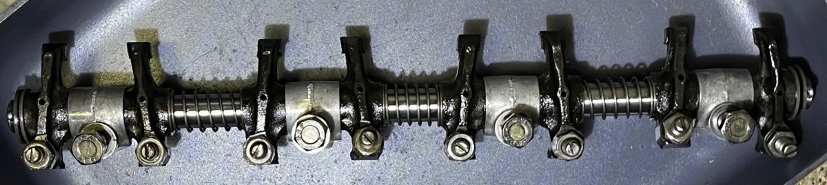

And the finished product;
Usable:rolleyes: No excessive play in the rockers, everything moves as a machined part should. Bolts fit through the posts easily but these will need to be tapped to their right places when assembled to the cylinder head. Not be a big deal. Assembly was well oiled, shrinkwrapped & squirreled away for safekeeping.
