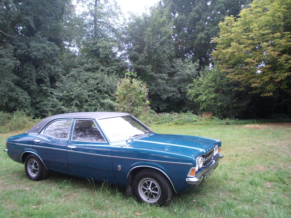

chris mk3 325 Posted September 20, 2018 (edited) .....Maybe selling this beauty, im not 100% guess im testing the water, but anyway its out there, (only on here at the mo) Edited September 20, 2018 by chris mk3 Quote Share this post Link to post Share on other sites
Mk3GXL 9 Posted September 20, 2018 Barmy Chris, you've only had it 5 minutes.. lol Maybe I should buy it back and keep it with it's sister :D Quote Share this post Link to post Share on other sites
chris mk3 325 Posted September 20, 2018 ....yeah you maybe should! Quote Share this post Link to post Share on other sites
