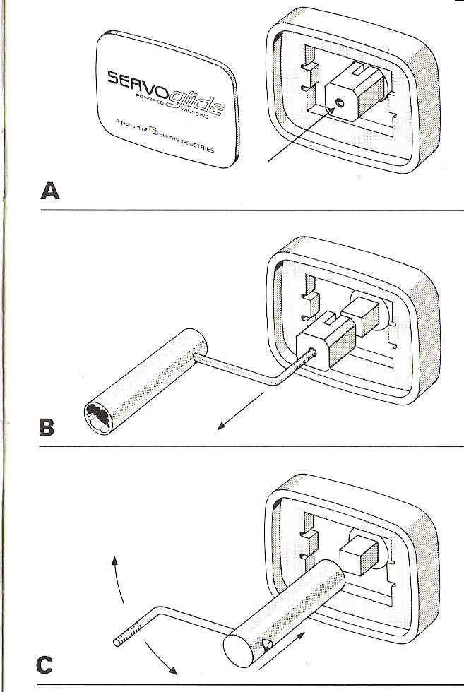

bortaf 96 Posted August 12, 2015 They wernt offerd as a factory option but over the years i have fitted loads of granada windows and switches i've even owned a few dealer fitted options both the box over the window winder spindle (servoglide) and adapted granada lifters. Usually the switches ended up between the gearstick and H/B lever, on Mk4's the switches were usually on seperate brakets but they could just as well have been cut into the consol. I still have a few bits of the servo glide system, it was rather complicated with travel limit switchews at the top and bottom of the window trravel, i also have some alterd mechs from a Y reg Ghia i had with dealer fitted E/W and C/L but they are just cut down granada (pre face lift Mk2) window mechs and C/L locks which bolt straight in. You can fit a granny consol in a cortina but it doesn't fit quite right being too wide and not a snug fit under the dash. Quote Share this post Link to post Share on other sites

the-ford-cortina.com 226 Posted August 12, 2015 They wernt offerd as a factory option but over the years i have fitted loads of granada windows and switches i've even owned a few dealer fitted options both the box over the window winder spindle (servoglide) and adapted granada lifters. Usually the switches ended up between the gearstick and H/B lever, on Mk4's the switches were usually on seperate brakets but they could just as well have been cut into the consol. I still have a few bits of the servo glide system, it was rather complicated with travel limit switchews at the top and bottom of the window trravel, i also have some alterd mechs from a Y reg Ghia i had with dealer fitted E/W and C/L but they are just cut down granada (pre face lift Mk2) window mechs and C/L locks which bolt straight in. You can fit a granny consol in a cortina but it doesn't fit quite right being too wide and not a snug fit under the dash. I broke a Scimitar with that servoglide system on and electric windows were a common Reliant fitted feature from new - NOT using servoglide Quote Share this post Link to post Share on other sites
