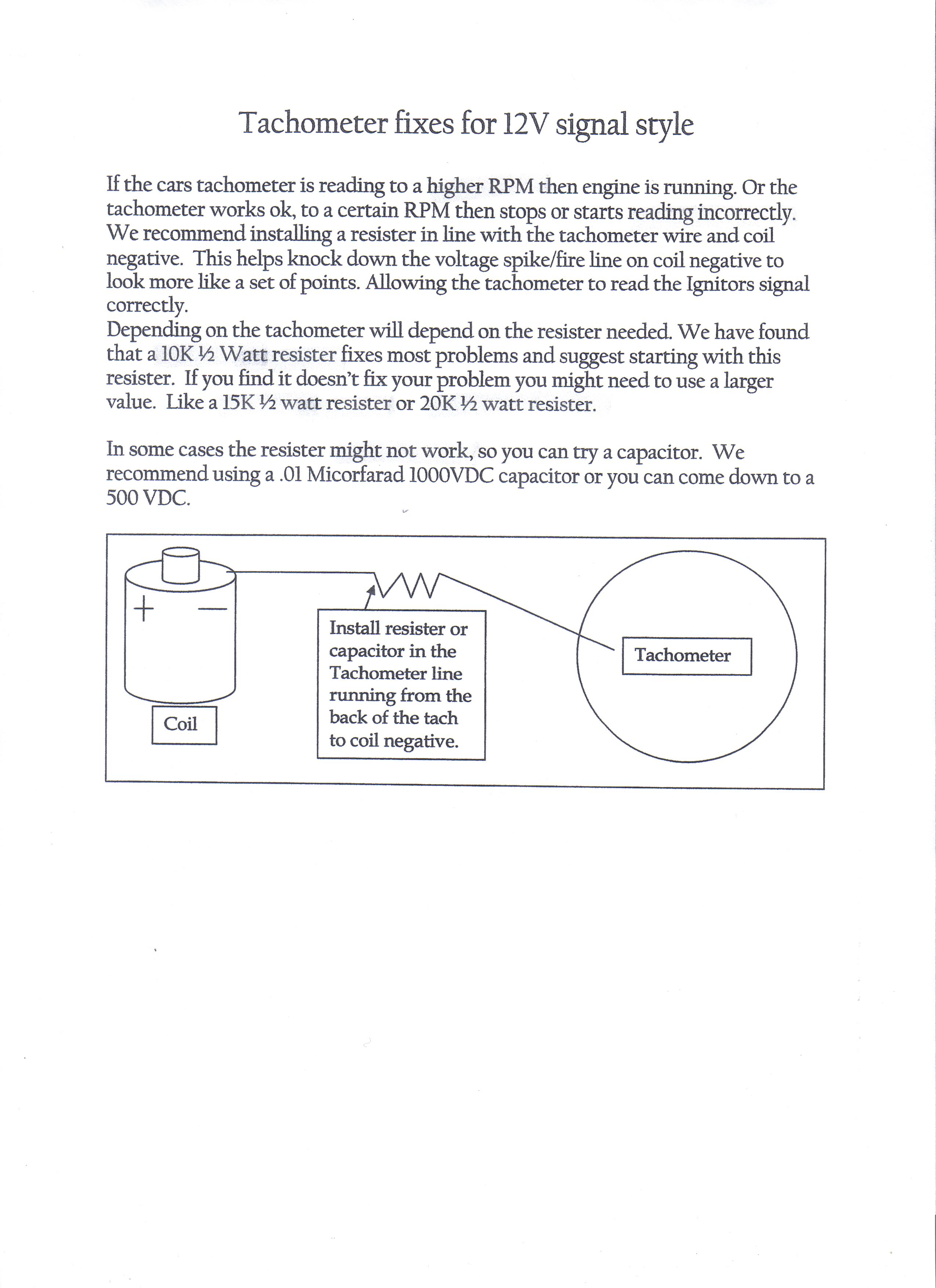

The tech support at Petronix sent me these on this subject.
Tach.pdf
I have not tried them yet though.
