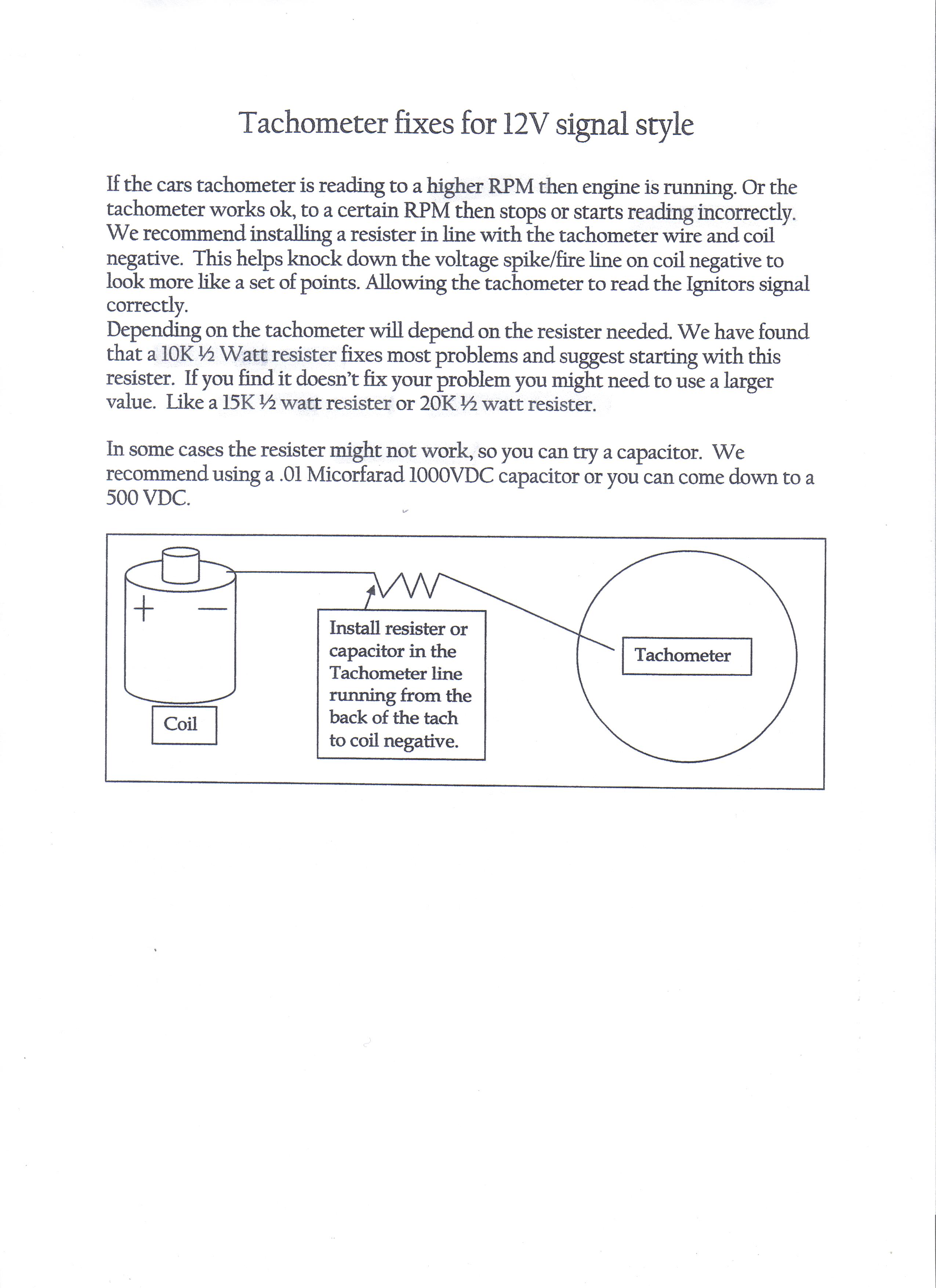

My tach is showing exactly double the actual RPM's. It works pretty well though, not jumpy.
Best way to fix?

Have yoy got electronic ignition fitted? If so sounds like the same problem as I have series 1 have RVI Tacho's fitted (curret sensing connected in series)) ,later models are fitted with RVC Tacho which are wired differently (connected in parallel) and work with electronic ignition. Hope this may be of some help
Yes, I have the Pertronix fitted and it's a Series 1.
These two solutions for that problem were sent to me by the Pertronix Support team.
Tach.pdf
