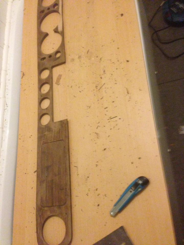

Heres My Progress pics so far, must say im very pleased with my effort!

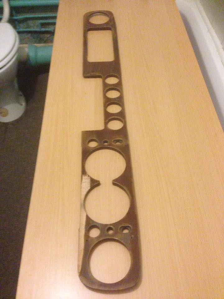

Have the before pic,
then once the veneer was removed and sanded down ,

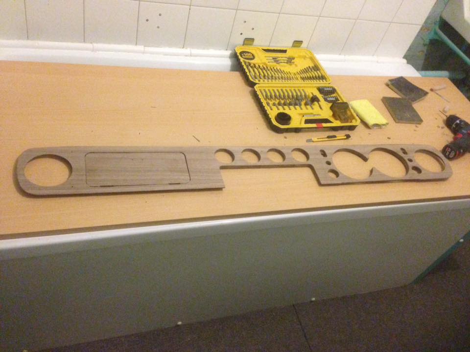

then the veneer complete and screw holes drilled

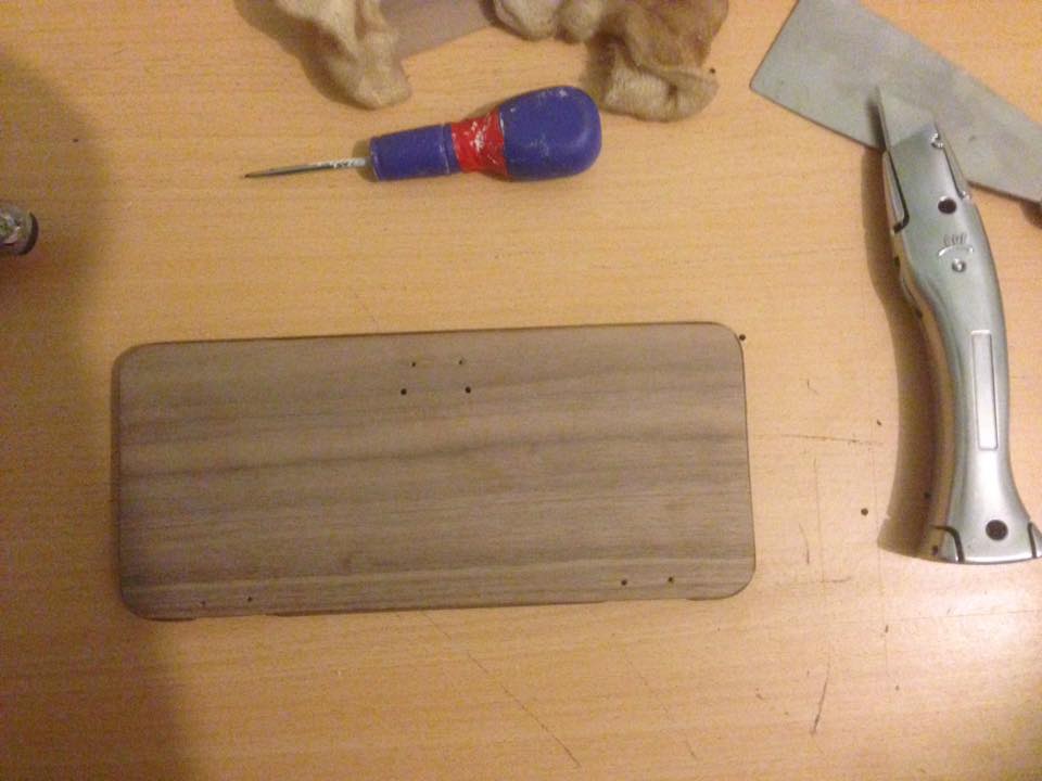

and finally the inside of the glove box door and screw holes drilled.
So far Ive spent £25 on the dash itself, £30 on the veneer , £10 on a heat gun , £5 on sanding pads and tack cloths
and time wise about 5 hours so far, once on the car I may then refurb the one currently on there to sell or keep as spare.

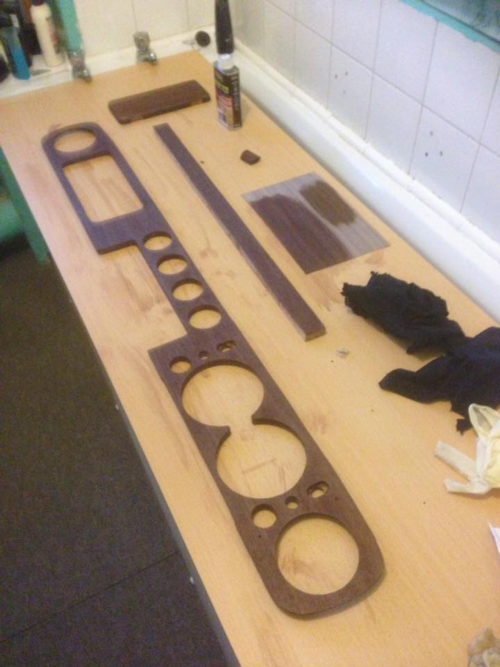

Pharaoh what colour did you stain the bits you sold?
Couldn't tell you now, too long ago, but i remember going to B&Q and buying a few small
sample pots of stain to try out first to see which got the best result, i bought enough veneer
to do two lots and noticed that it was light and dark and this had a bearing on the stain i bought,
another thing is put the stain on with a rag rarther than a paint brush i thought it gave a better finish..

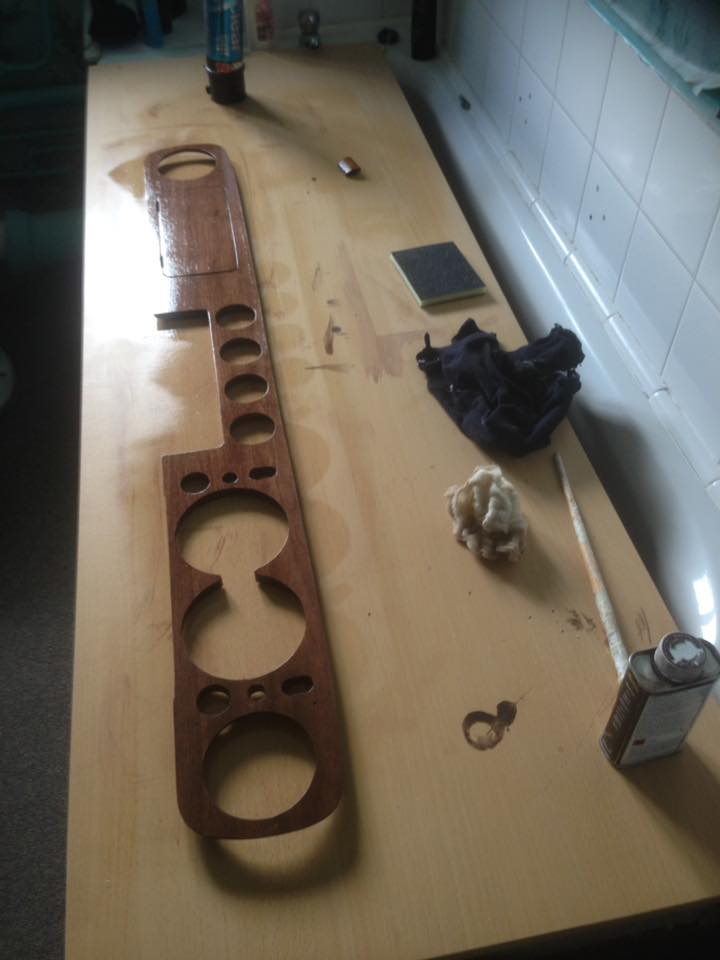

heres the current pic of the dash, 4-5 coats of dye (cloth applied)
deciding on my next move

That's looking nice. What glue do you use, and what was the heat gun for?
hi mate, thanks, the veneer i bought had a sticky back on, so just peeled the paper off and stuck it, anything to avoid contact adesive has to be good lol saved alot of time and mess tbh
The heat gun i used to help remove the old veneer and finish, took about 10-15 mins.

4-5 coats of lacquer later and i think im happy now! time to put it back together ready to go on the car, giving me another one to do along with the door tops.

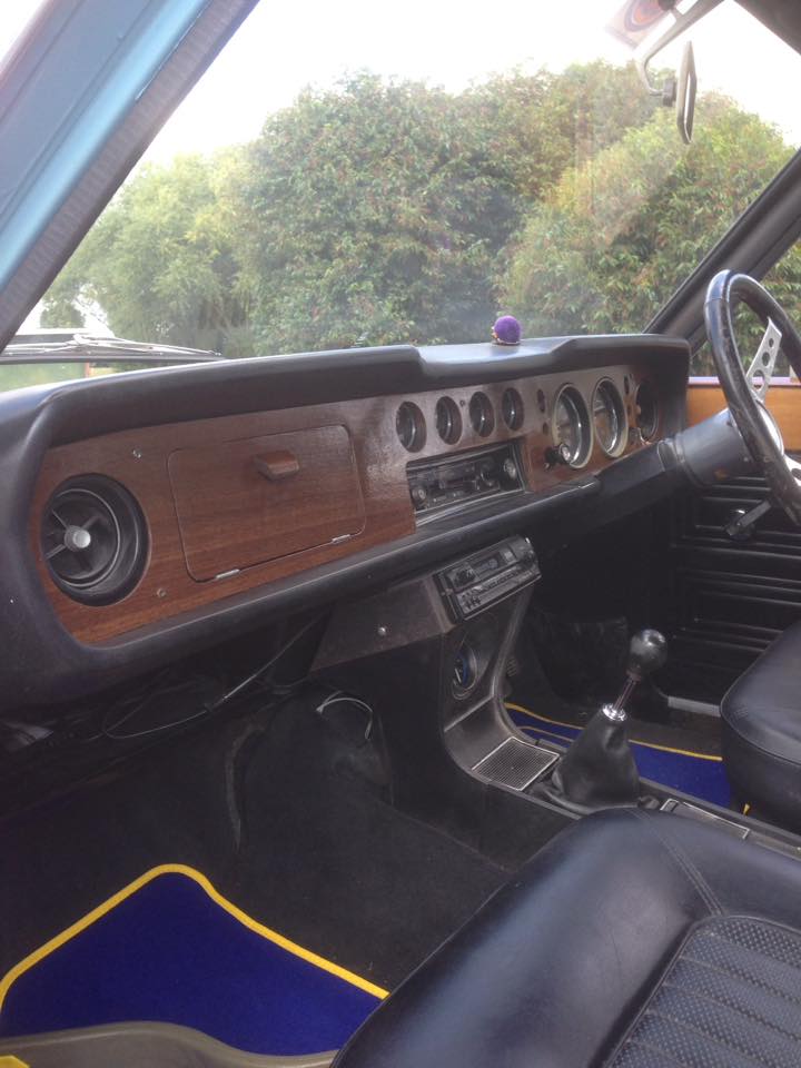

well the Finished Dash is finally on the car! Must say i am pleased with the results, i will now gladly give the door tops ago to match.
You have done a good job, always looks better when the veneer runs through with
the glove box lid, i found the cappings a lot easier than the dash to do...
