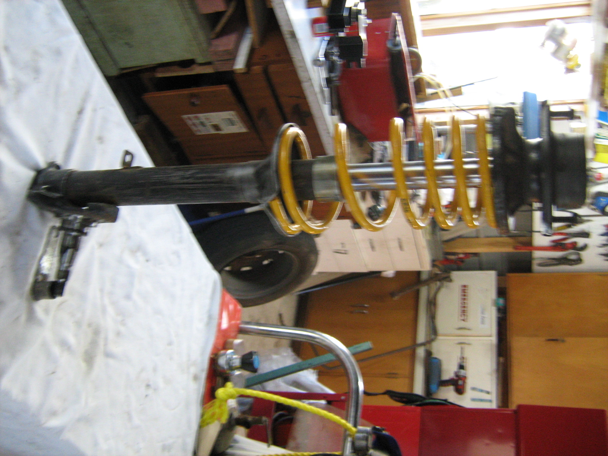

post-2810-095395700 1502078965_thumb.jpg made these bilsteins for my s1 anything is possible just takes a bit of time machining.
