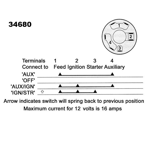

Hi all, I've at to remove the igniton switch fault finding. Before I removed the switch I numbered all the wires and numbered the terminals, plus done a diagram. Well, it turned out the permanent marker I used to number the terminals wasn't so permanent, they have all rubbed off. On removal of the switch I noticed that there are numbered stamped on the card around the terminals. So, can anyone tell me witch wire goes to what terminal please.
Thank you
This may help?
