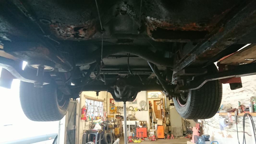

Well finally getting started on this bad boy, only been in the garage a year lol Had her on the ramp and she is quite good underneath, 2 large holes and one smaller one to sort but otherwise pretty good. Doors need patching and probably some work round the front window but she's not as bad as I was expecting

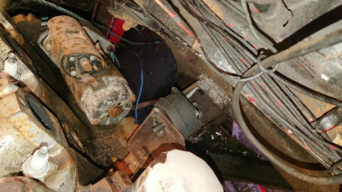

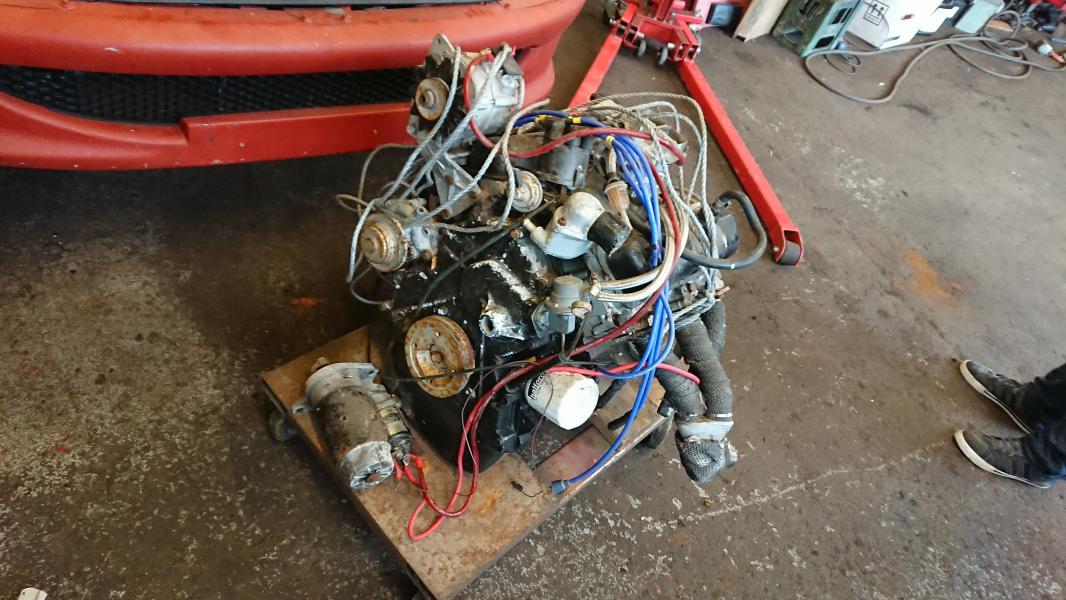

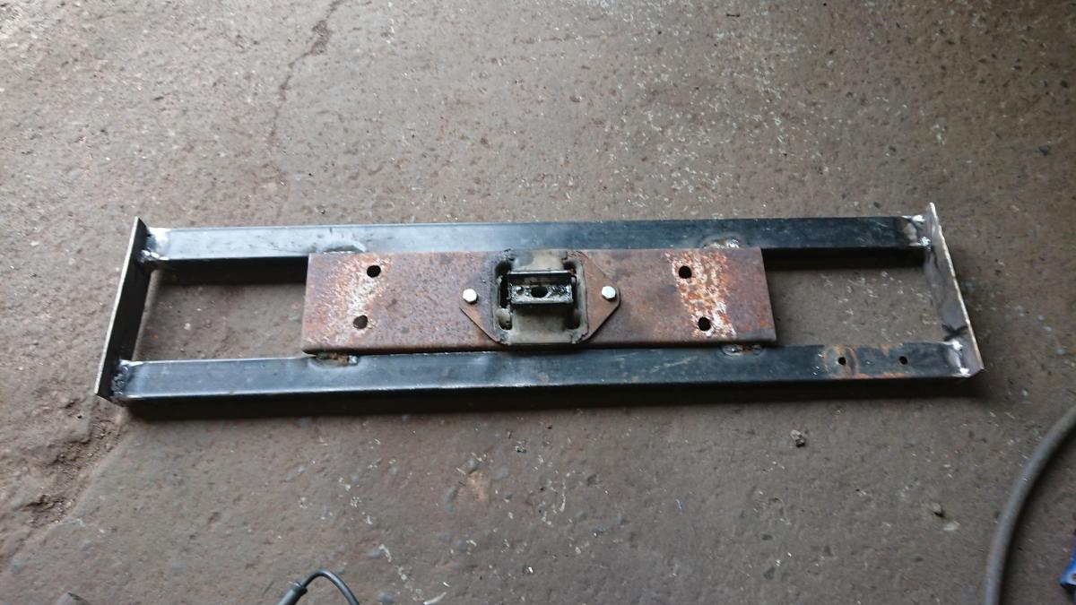

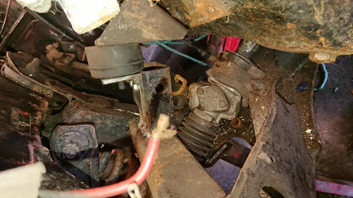

Got an Essex V6 with 4sp box to go in and lifted that in today to look at making some engine mounts, goes in well so hopefully have it sitting in there by the end of the week ☺️ Will get some photos up in a bit. Sent from my G8441 using Tapatalk
Edited by Smithaam

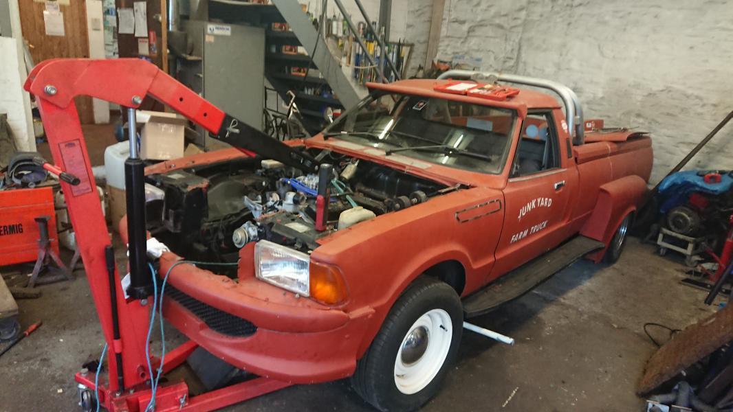

A few photos, hopefully a lot more to come :)
Engine mounts on a fitted, still need to add a strengthener to the front mounts but that is easy done.
Edited by Smithaam
I like the American look you've got on your truck - running boards, extended rear arches, etc. :thumbup:

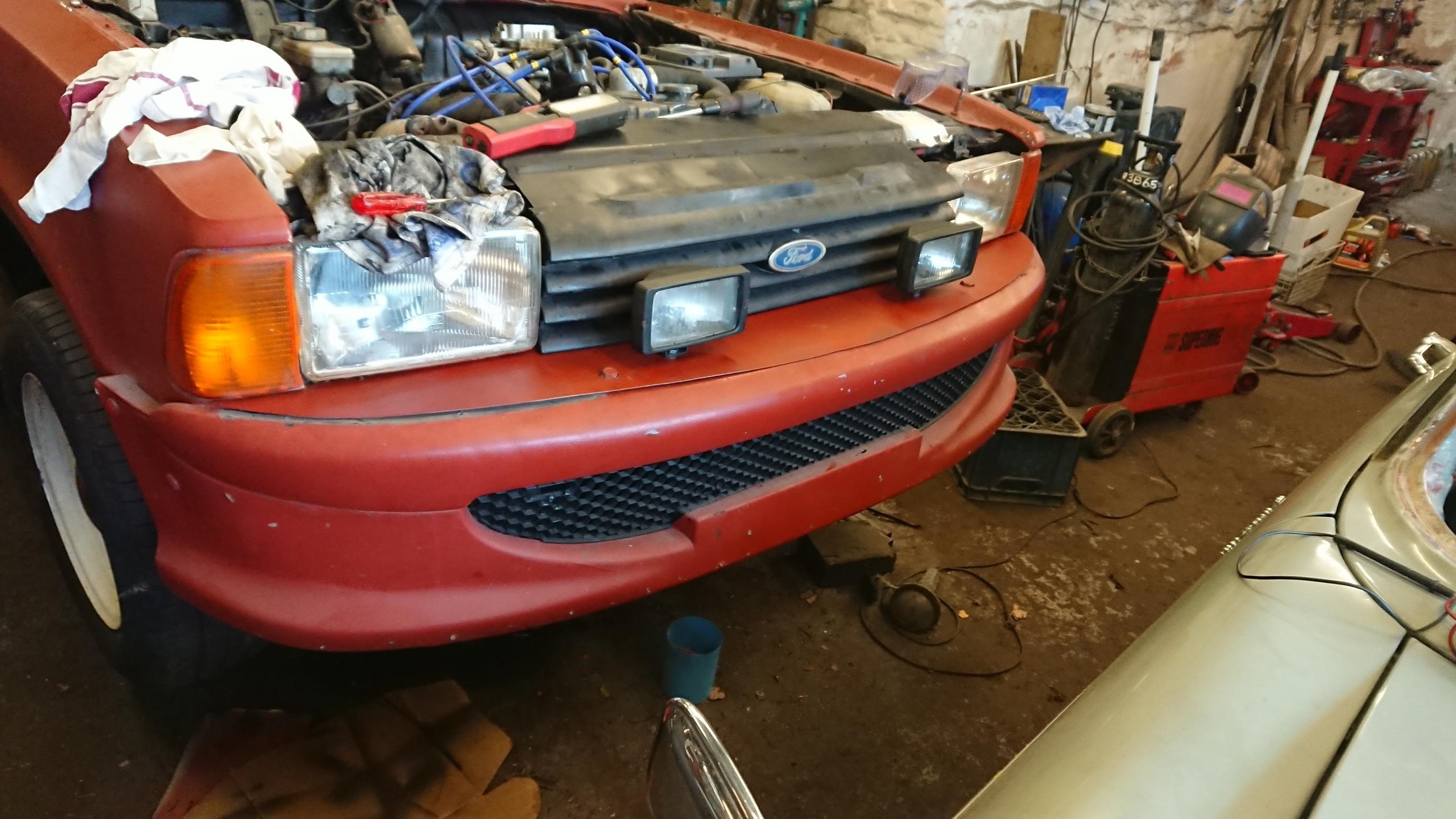

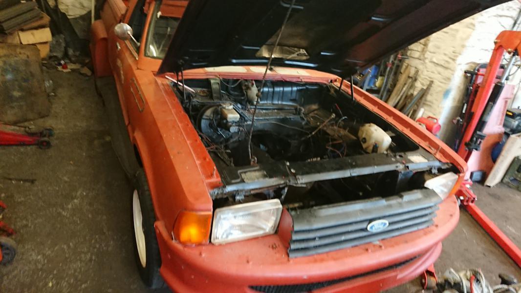

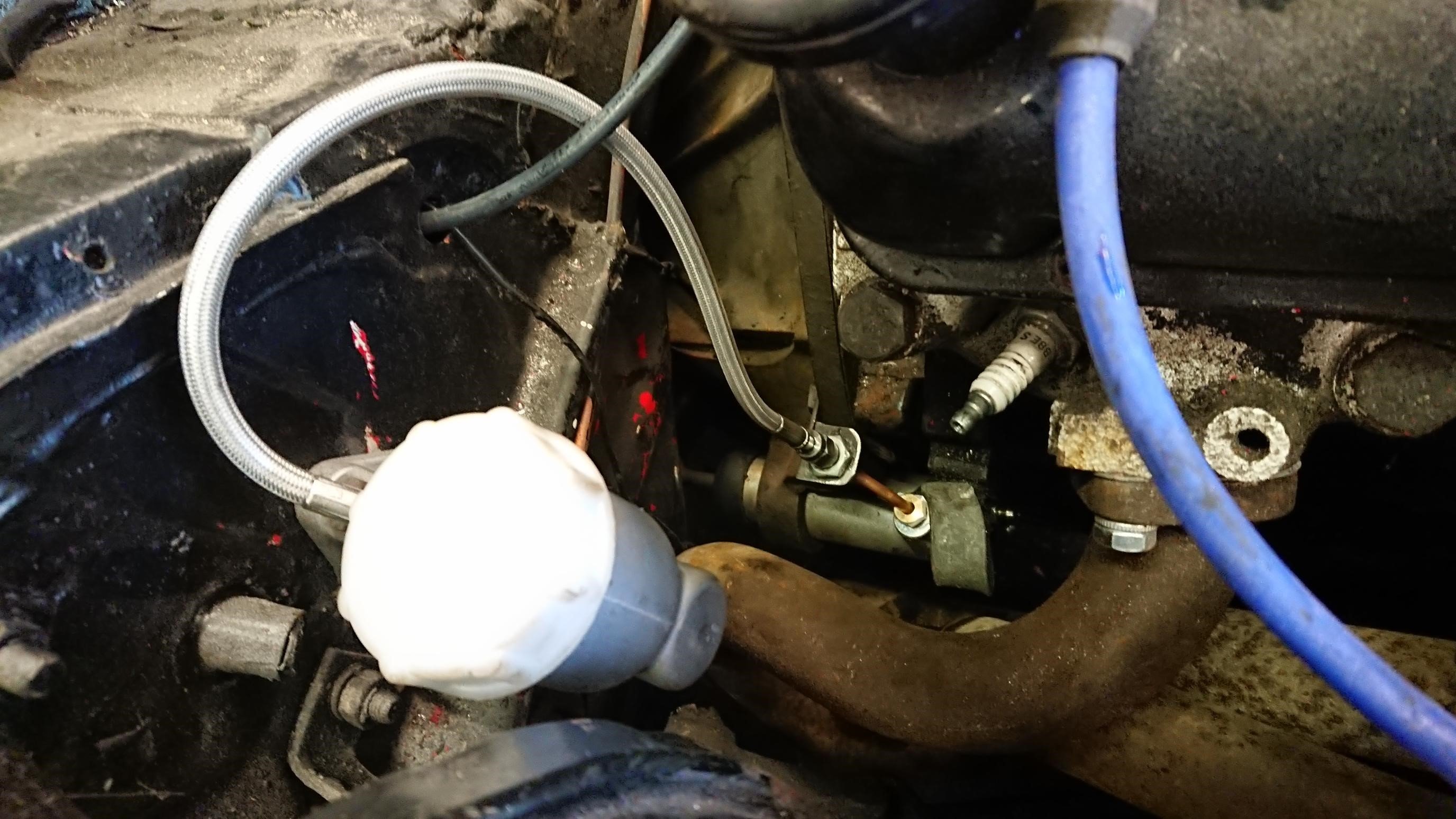

Bit more work done this weekend! front end has been strengthened and lights fitted. also clutch all working now as had to convert to hydraulic to match gearbox 🙂
Going to start on rear of the car this next week as need to lift the back end up, once that is done i can get a prop made and she should be mobile then.

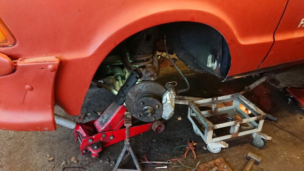

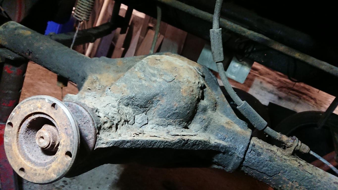

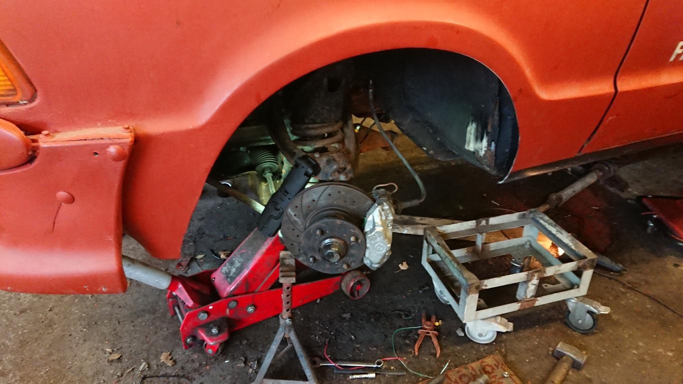

About time i put an update up! I have come across a few issues on the rear end. 1st was the prop, first i assumed it was a cortina prop! same as mk3/4/5 but the diff flange did not match.... found a Corsair V4 prop flange matches up so just need to get one made now .
2nd problem has been a major issue in realising the rear wheels are not the right fitment for the car, previous owner looks like to have filed the wheels slightly to match the stud pattern! this is obviously a big no no for a road car!

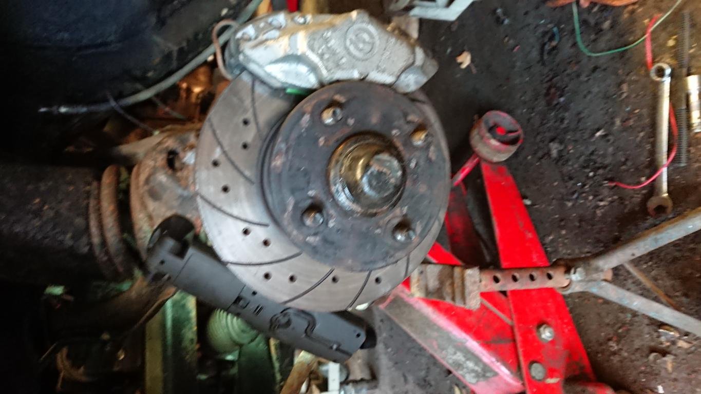

3rd issue has been unable to find front brake disks as they are no longer made so i have changed the front hubs for Cortina mk3/4/5 ones. on the plus side i do have the Granada brake upgrade off my mk3 i have been able to fit. This however requires new wheels for the front!
All in all its taken a lot more work than expected but i can now see light at the end of the road!
New wheels for front and rear have been ordered from the US, going to take 2/3 weeks to get here but could not get the correct offsets in the UK.
