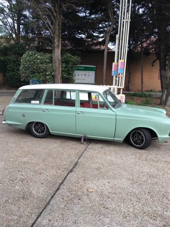

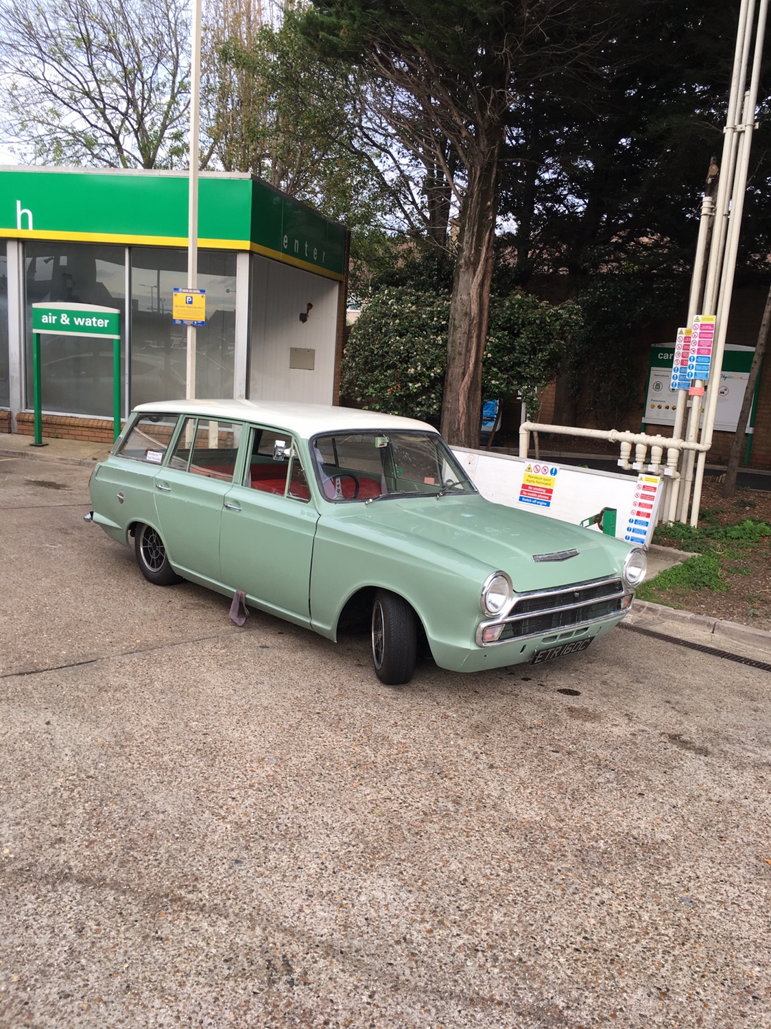

smudger 2 Posted November 3, 2017 Mine is about 4 inches lower than standard. Lowered with decambered leaf springs You can't go much lower without serious mods to the chassis. Eg the prop shaft will start making contact with the tunnel Sent from my iPhone using Tapatalk Quote Share this post Link to post Share on other sites
chinkamon 14 Posted November 3, 2017 (edited) .... Easiest thing is have a look at what size lowering blocks are on the back axle. They'll be 1,1.5 or 2 inch blocks Yea problem is, there isn't any! The front springs are cut and the back leafs are slack so hang a bit low anyway I have lowering blocks but thought if I lower it too much it'll bottom out haha Edited November 3, 2017 by chinkamon Quote Share this post Link to post Share on other sites
chinkamon 14 Posted November 3, 2017 (edited) ......>Mine is about 4 inches lower than standard. Lowered with decambered leaf springs You can't go much lower without serious mods to the chassis.Eg the prop shaft will start making contact with the tunnel Hell that's good looking!!!! <br /> How did you lower yours at the front Edited November 3, 2017 by chinkamon 1 Quote Share this post Link to post Share on other sites

smudger 2 Posted November 3, 2017 The front is lowered with cut down springs. Wired into the cups to keep the mot man happy Sent from my iPhone using Tapatalk Quote Share this post Link to post Share on other sites
chinkamon 14 Posted November 3, 2017 That's perfect thanks lotuscops Cheers Pete I been eyeing them up an wasn't sure if they'd fit! Cheers smudger how'd u no how much to cut out though lol 1 Quote Share this post Link to post Share on other sites
