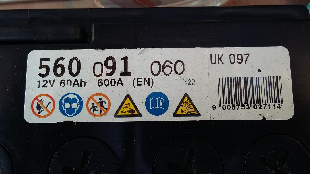

Anyway just looking at the number on the current battery I can't find an exact match, I'm assuming an exact isn't necessary but again just playing safe. Also the terminals are the bolt style not the rounded style and all new batteries seem to have the rounded connectors so need to convert the leads to those.

Not sure about NI but over here you can generally get your battery supplier to order in a 097 or a 095 with the correct square terminals (T4F).
If you go for round terminals a 075 or 075T will more than do the job. :)

I've done the same and swapped to round terminals (2 litre pinto) Can check my battery tomorrow if that would help
