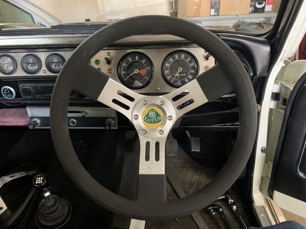

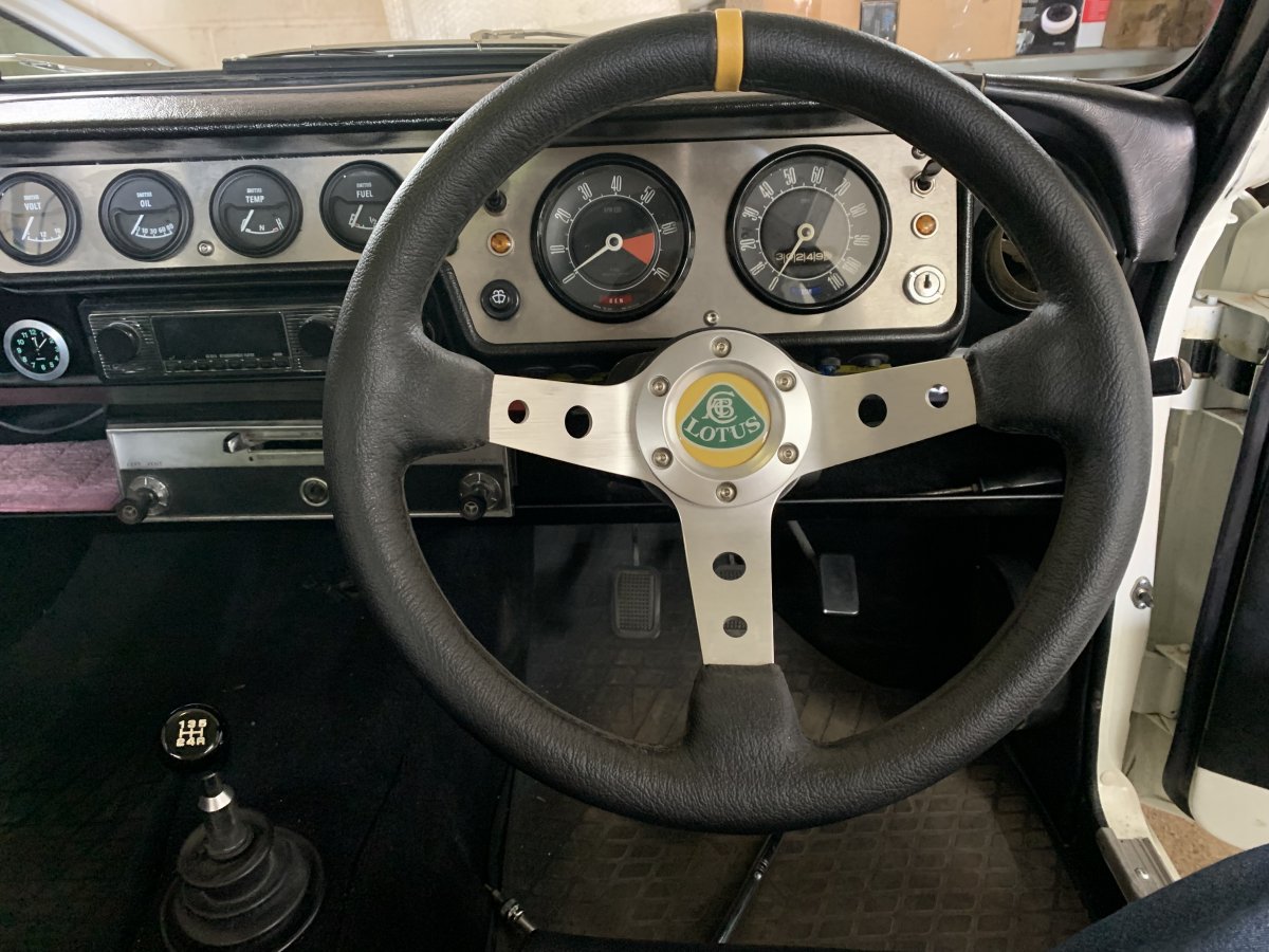

johnny boy 164 Posted June 26, 2022 Today I’ve changed from a 13 inch to a 15 inch steering wheel , to see if I like it better 🙄 got to drive it now, see how I like it. I like the design of the smaller one better, but don’t like the yellow drift marker, and it feels a bit small. I’ll see how I get on😀 Quote Share this post Link to post Share on other sites

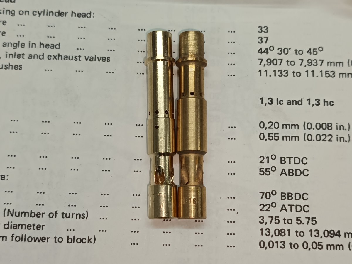

johnny boy 164 Posted December 16, 2022 (edited) I've been trying to get rid off a weak condition on the 40 DCOE's , on light throttle, on the transition from the idle jets. Fixed it by changing the emulsion tubes from f16 to f7. I thought I might need some 5 progression hole 40 dcoes, to cure it. Turns out I don't Edited December 17, 2022 by johnny boy Quote Share this post Link to post Share on other sites
johnny boy 164 Posted December 17, 2022 Here's the difference between F16 and F7 emultion tubes.😀 Quote Share this post Link to post Share on other sites

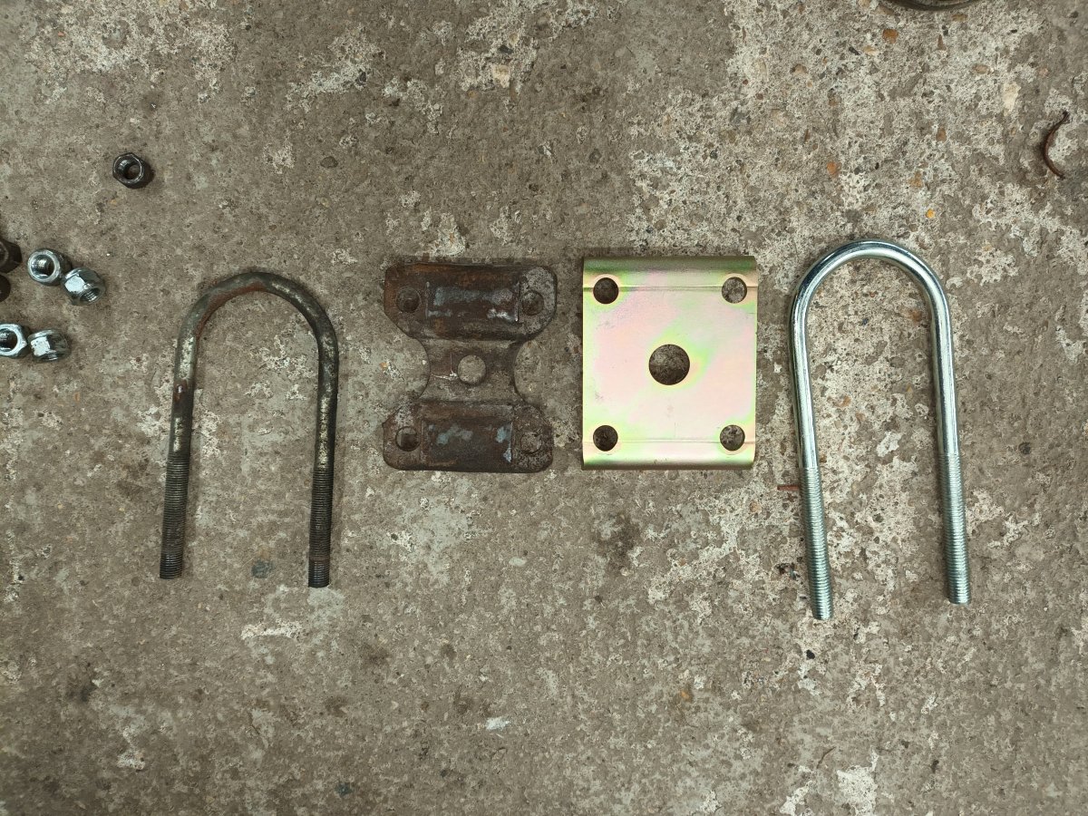

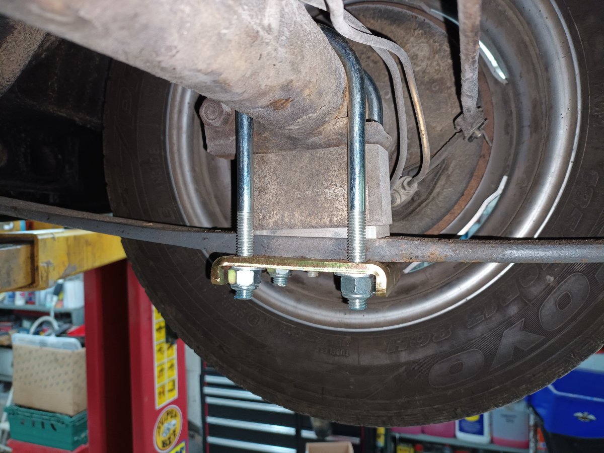

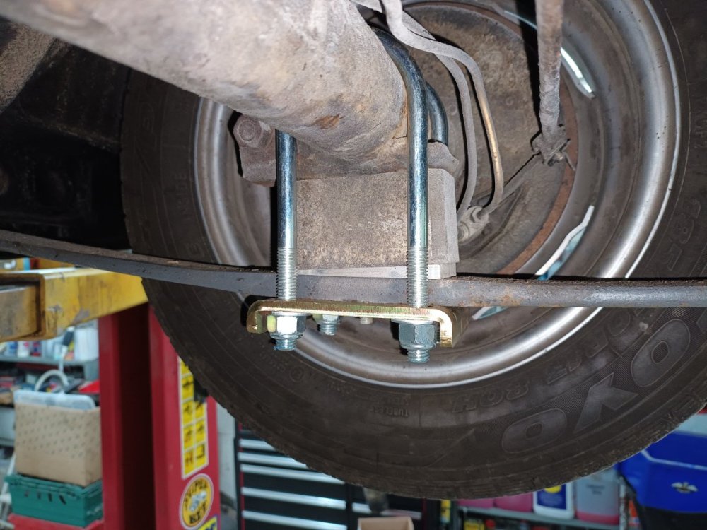

johnny boy 164 Posted January 12, 2023 Just replaced the weedy U bolt plates with some heavy duty one's , Also gone to 12mm capri u bolts. 2 Quote Share this post Link to post Share on other sites
