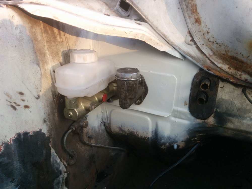

johnny boy 164 Posted March 30, 2019 (edited) I managed a bit more time today, and started the LHD to RHD conversation today, also converting to duel circuit brakes. I'm looking for a RHD behind dash wiring loom, and a RHD throttle pedal,if anyone has them for sale. Edited March 30, 2019 by johnny boy Quote Share this post Link to post Share on other sites
littlenewt2067 33 Posted March 31, 2019 What master cylinder have you used? Just caught up on your build, looking good! Quote Share this post Link to post Share on other sites
johnny boy 164 Posted March 31, 2019 A land rover series 3, but it wasn't an easy just job.🙄 Quote Share this post Link to post Share on other sites
Dave A 17 Posted April 5, 2019 Nice choice on the girling master cylinder. Reservoir looks just like my mk 2. What bore size is this cylinder? Quote Share this post Link to post Share on other sites
johnny boy 164 Posted April 5, 2019 4 hours ago, Dave A said: Nice choice on the girling master cylinder. Reservoir looks just like my mk 2. What bore size is this cylinder? If I remember correctly it's 7/8 Quote Share this post Link to post Share on other sites
Lotuscops 80 Posted April 5, 2019 1 hour ago, johnny boy said: If I remember correctly it's 7/8 Normally 5/8" for the clutch master cylinder. Quote Share this post Link to post Share on other sites
johnny boy 164 Posted April 5, 2019 1 hour ago, Lotuscops said: Normally 5/8" for the clutch master cylinder. Yes, the clutch cylinder is 5/8 The brake master is 7/8 Quote Share this post Link to post Share on other sites
mk2sav 44 Posted April 5, 2019 15 hours ago, Dave A said: Nice choice on the girling master cylinder. Reservoir looks just like my mk 2. What bore size is this cylinder? Dave - the reservoir is the same and Britpart do just the reservoir if you need a fresh one ( Britpart being Land Rover parts dealer ) Steve 1 Quote Share this post Link to post Share on other sites

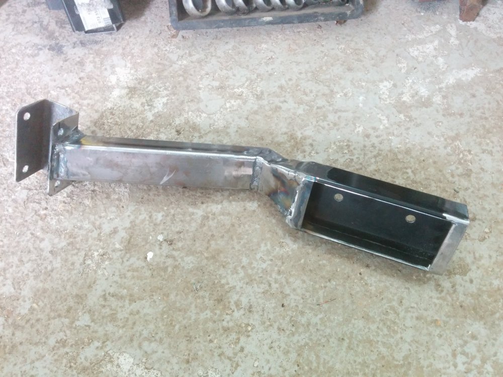

johnny boy 164 Posted April 6, 2019 I had the morning in the barn today, and managed a bit more 😀 I started making up the gearbox crossmember, as I'm doing an engine a box dry fit. I only had enough material to fab up one side, need to get some more next week, bit of a ass really , as I wanted to complete it 😬 Quote Share this post Link to post Share on other sites
nascar66 74 Posted April 6, 2019 Great stuff! Quote Share this post Link to post Share on other sites
johnny boy 164 Posted April 12, 2019 Finished 😀 Quote Share this post Link to post Share on other sites
GhiaMk4/5 207 Posted April 12, 2019 That's neat, shame it's going to be hidden underneath. Quote Share this post Link to post Share on other sites
johnny boy 164 Posted April 12, 2019 45 minutes ago, GhiaMk4/5 said: That's neat, shame it's going to be hidden underneath. But I will know it's there 😁 1 Quote Share this post Link to post Share on other sites
