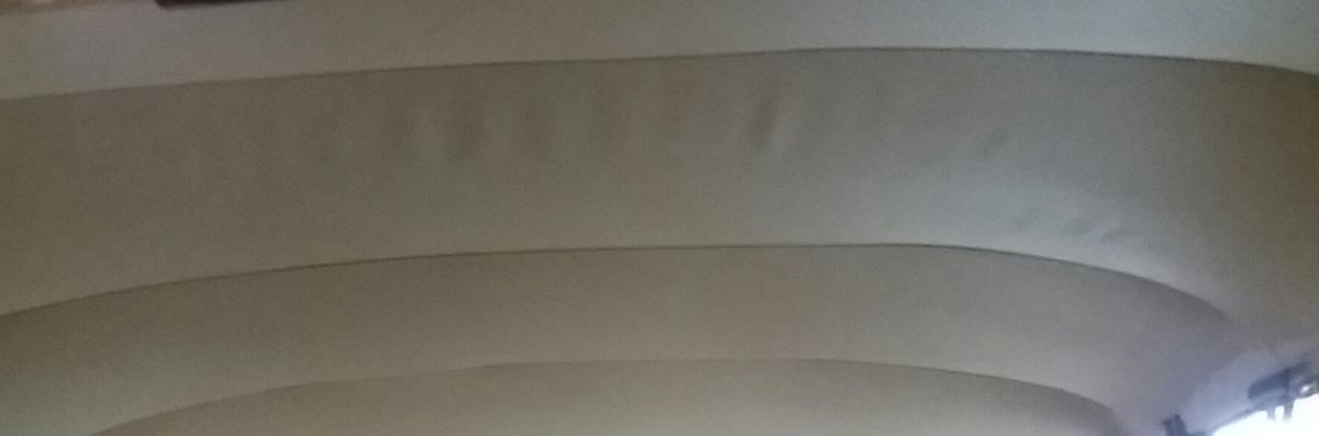

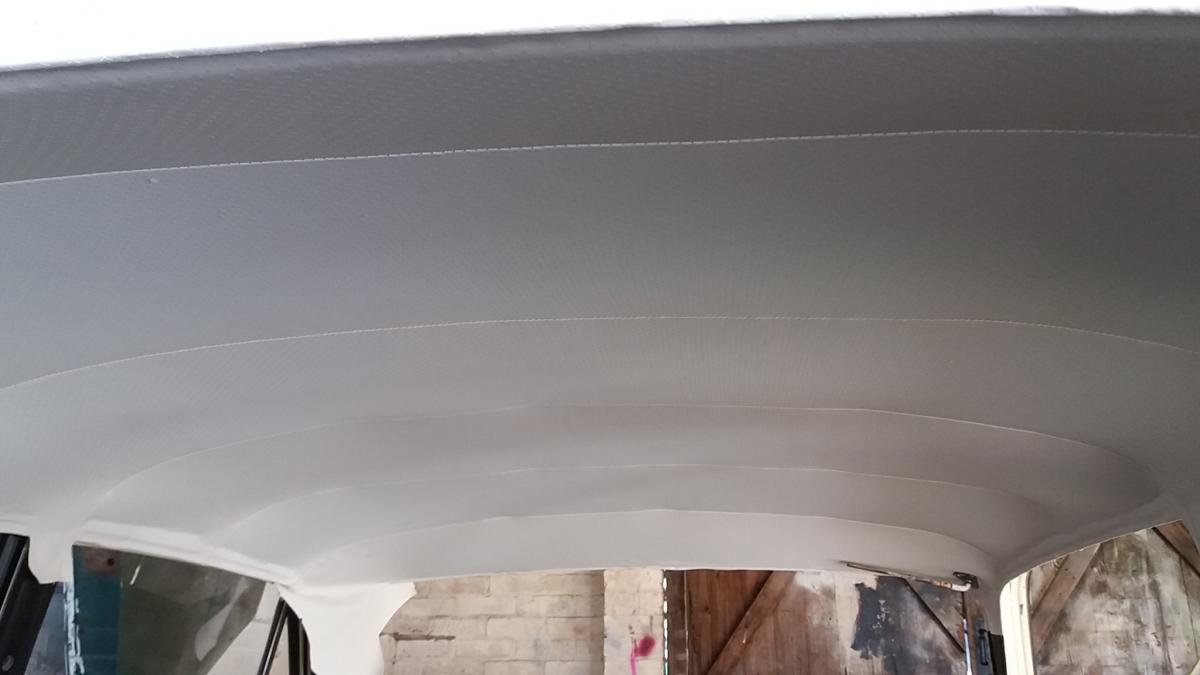

When I fitted a new one to my Corsair I had several wrinkles around 10. I got a small syringe and injected each wrinkle with a very small amount of water as recomended in work shop manual and then with a hair drier warmed them up and within seconds they vanished. The backing is cotton and the water/heat shrinks it and draws the plastic lining tight. Pictures before and after
