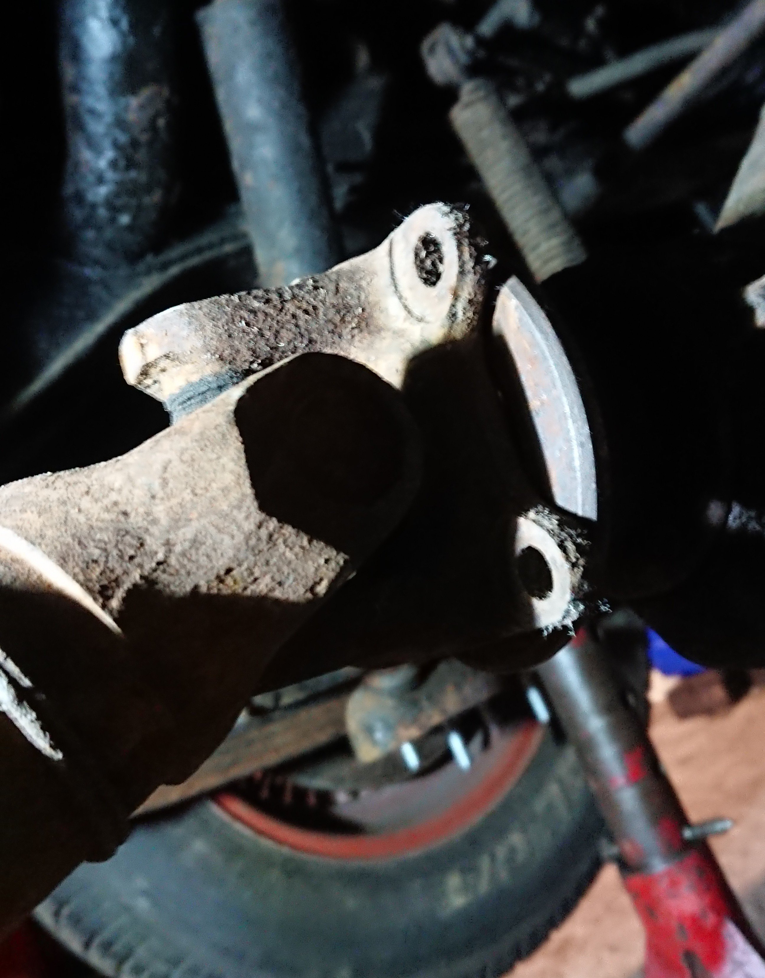

Smithaam 9 Posted January 26, 2019 I managed to pick up a propshaft off a mk4 cortina, not sure what engine it was out of but unfortunately it don't fit, center fits in but the bolt holes are further spread out! Any ideas what might fit?? Share this post Link to post Share on other sites
kenbex522 34 Posted January 26, 2019 Only three Ford flanges as far as i know: 88mm dia Anglia size, 92mm dia Corsair and some mk1/2 Cortinas and 108mm with threaded holes which is all later Fords. That looks like the 92 one to me. What axle/diff is it ? Share this post Link to post Share on other sites

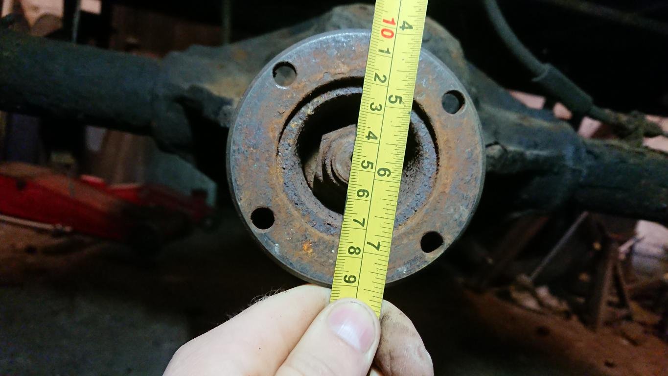

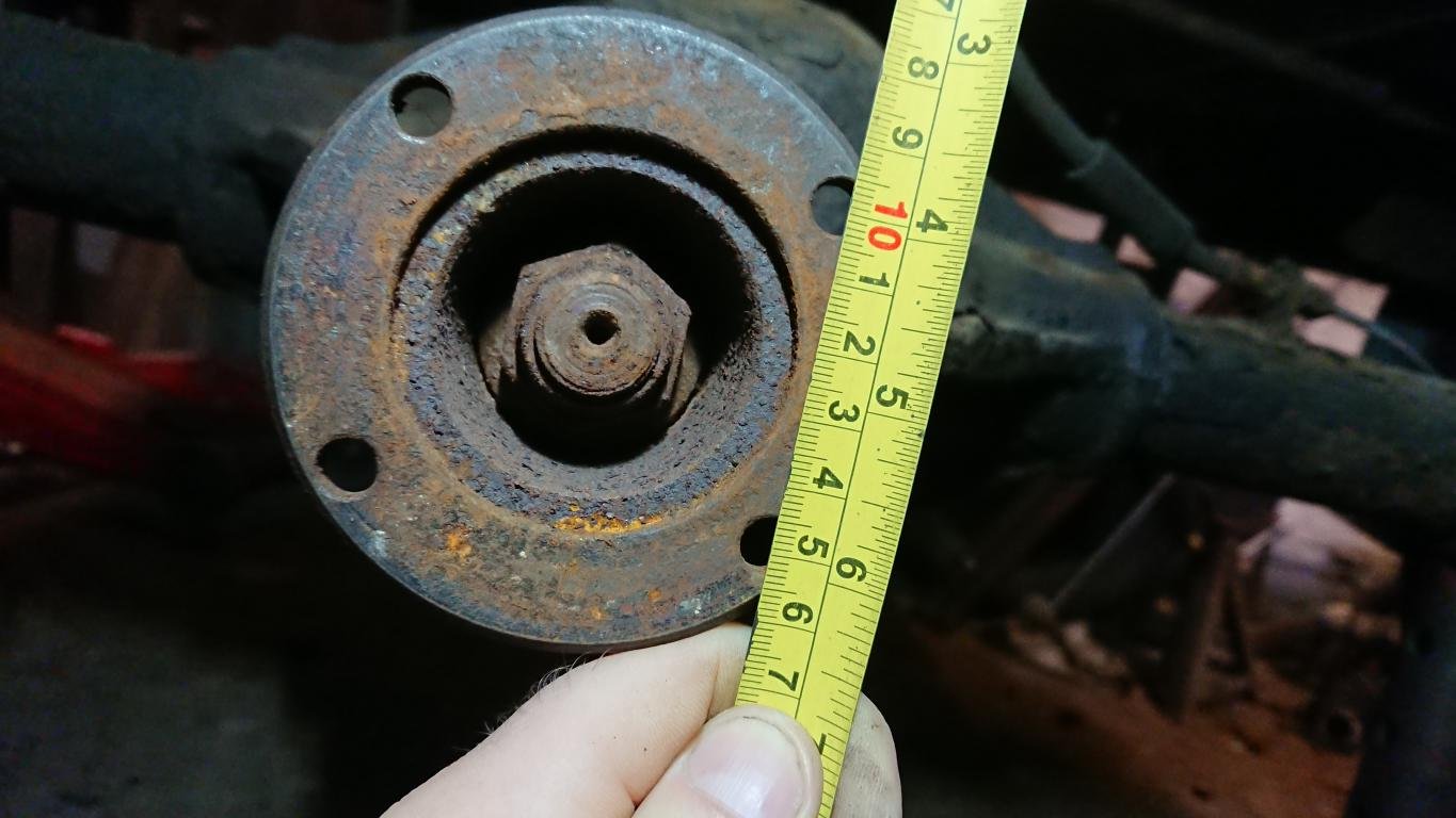

sheffieldcortinacentre 772 Posted January 27, 2019 (edited) Sierra p100 is transit based, Cortina p100 is a Borg Warner axle. Measured it at 77mm diagonal centre s. Cars are 92. Edited January 27, 2019 by sheffieldcortinacentre Share this post Link to post Share on other sites

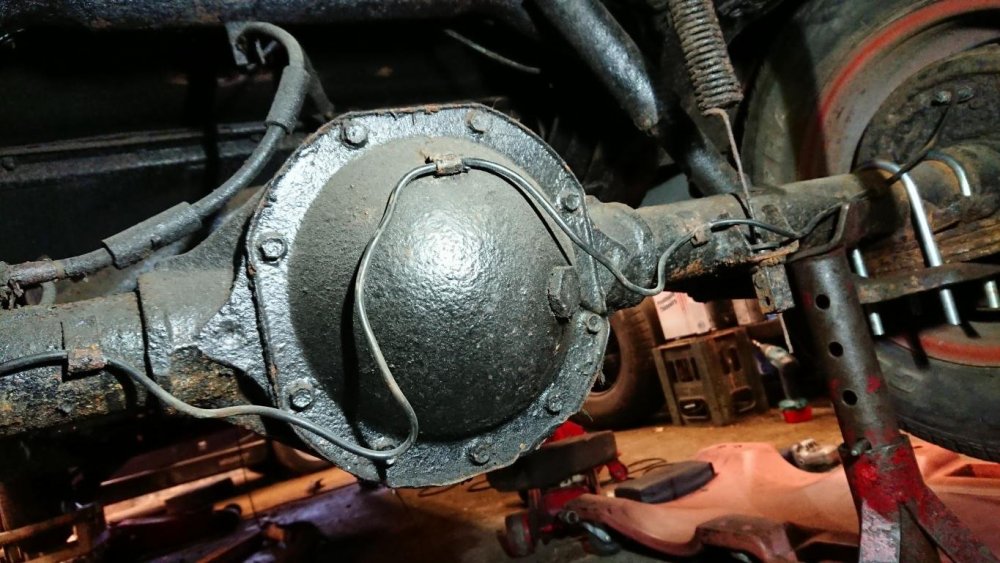

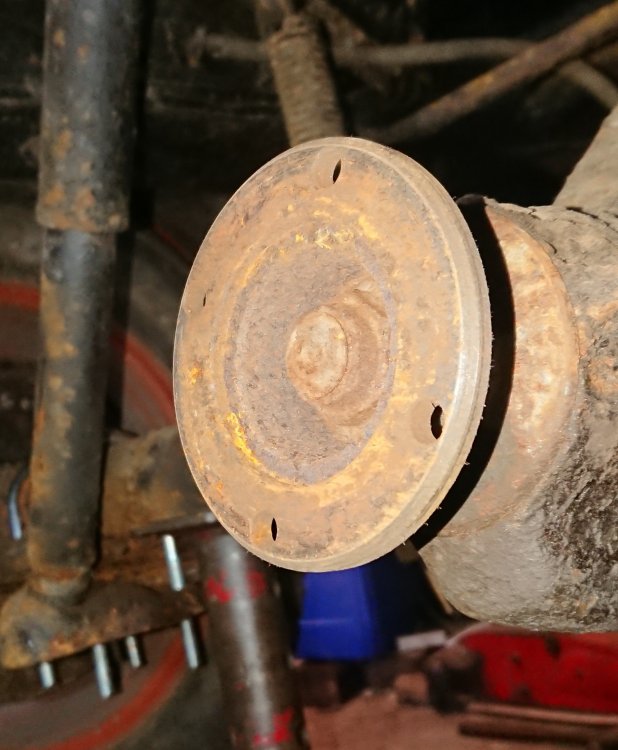

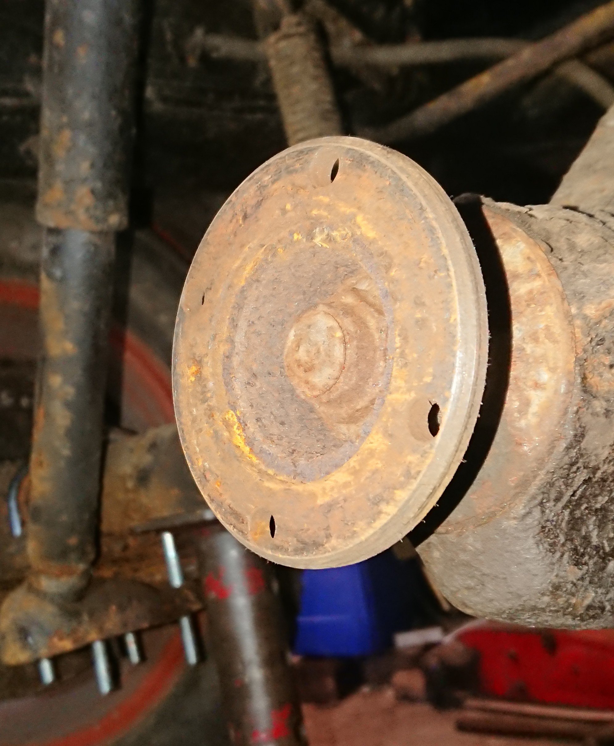

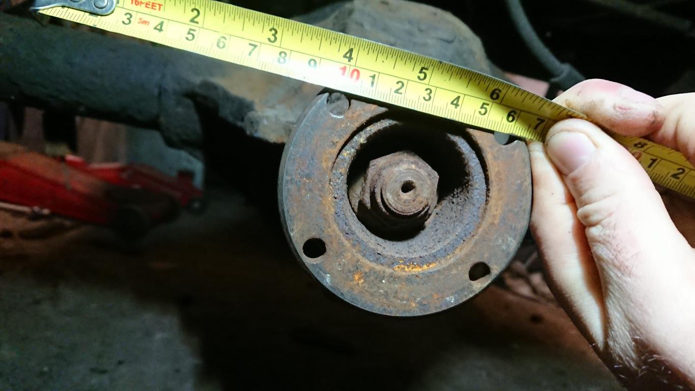

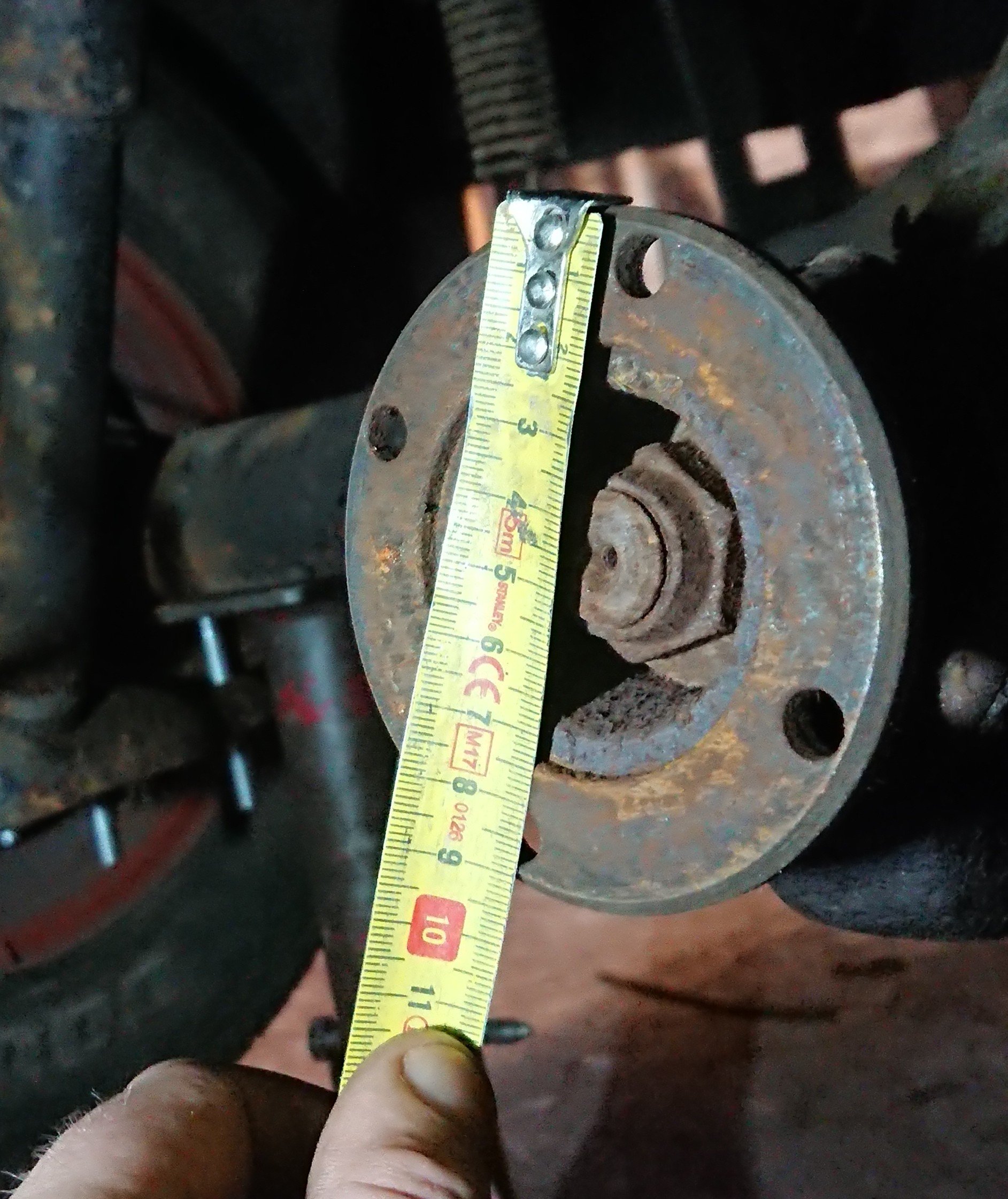

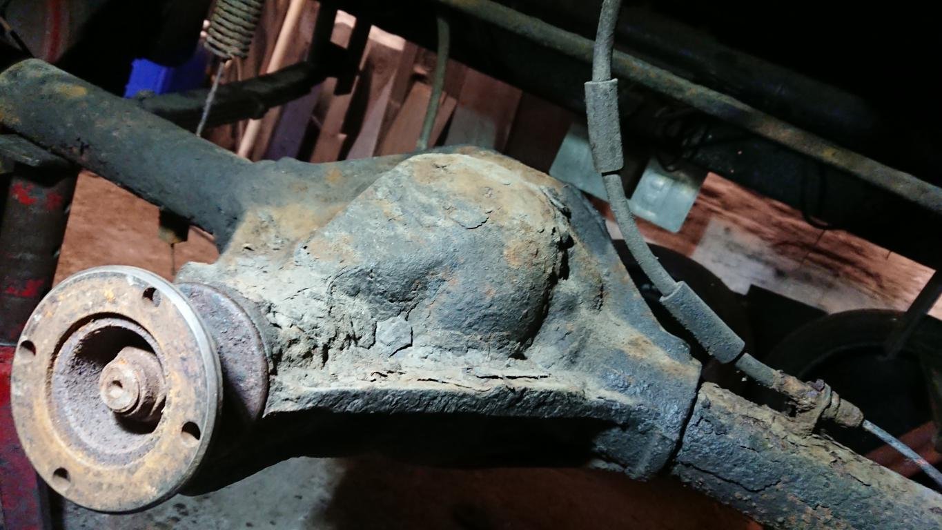

Smithaam 9 Posted January 28, 2019 Some more pictures of the axle! could not find any marking or names on it but it could do with a clean up. Share this post Link to post Share on other sites
sheffieldcortinacentre 772 Posted January 28, 2019 That's a Cortina p100 axle my measurements were diagonal. Share this post Link to post Share on other sites
Smithaam 9 Posted January 29, 2019 Cheers for all the info and help guys, just for future reference the flange is the same as Corsair V4 👍 can finally messure and get prop made up 😁. Share this post Link to post Share on other sites
Smithaam 9 Posted January 29, 2019 17 hours ago, sheffieldcortinacentre said: That's a Cortina p100 axle my measurements were diagonal. Just wanted to check that was all, the pickup has had so much work done to it was not sure what was normal and what's extra lol Cheers Share this post Link to post Share on other sites
