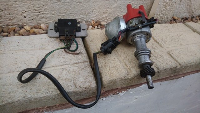

nmonkey220 23 Posted July 16, 2019 I'm pretty sure i have a full ford sierra set up loom module and dizzy, i will need to check PM if interested Quote Share this post Link to post Share on other sites
Gheko 0 Posted July 16, 2019 Sound nmonkey220 will you give a look when you get a chance, would be interested if not too expensive with postage and all, I’m in the rep ireland. Let me know what you got and price please when you get a chance. Quote Share this post Link to post Share on other sites
nmonkey220 23 Posted July 16, 2019 i've got the full electronic set up PM me your address and i'll get you a price with postage Quote Share this post Link to post Share on other sites
sheffieldcortinacentre 747 Posted July 16, 2019 I'd go for that /\ setup. Each to his own but not had much luck with the accuspark set ups on various makes & models I've come across while others have. The same goes for holley carbs had/having nothing but hassle with them. 1 Quote Share this post Link to post Share on other sites
