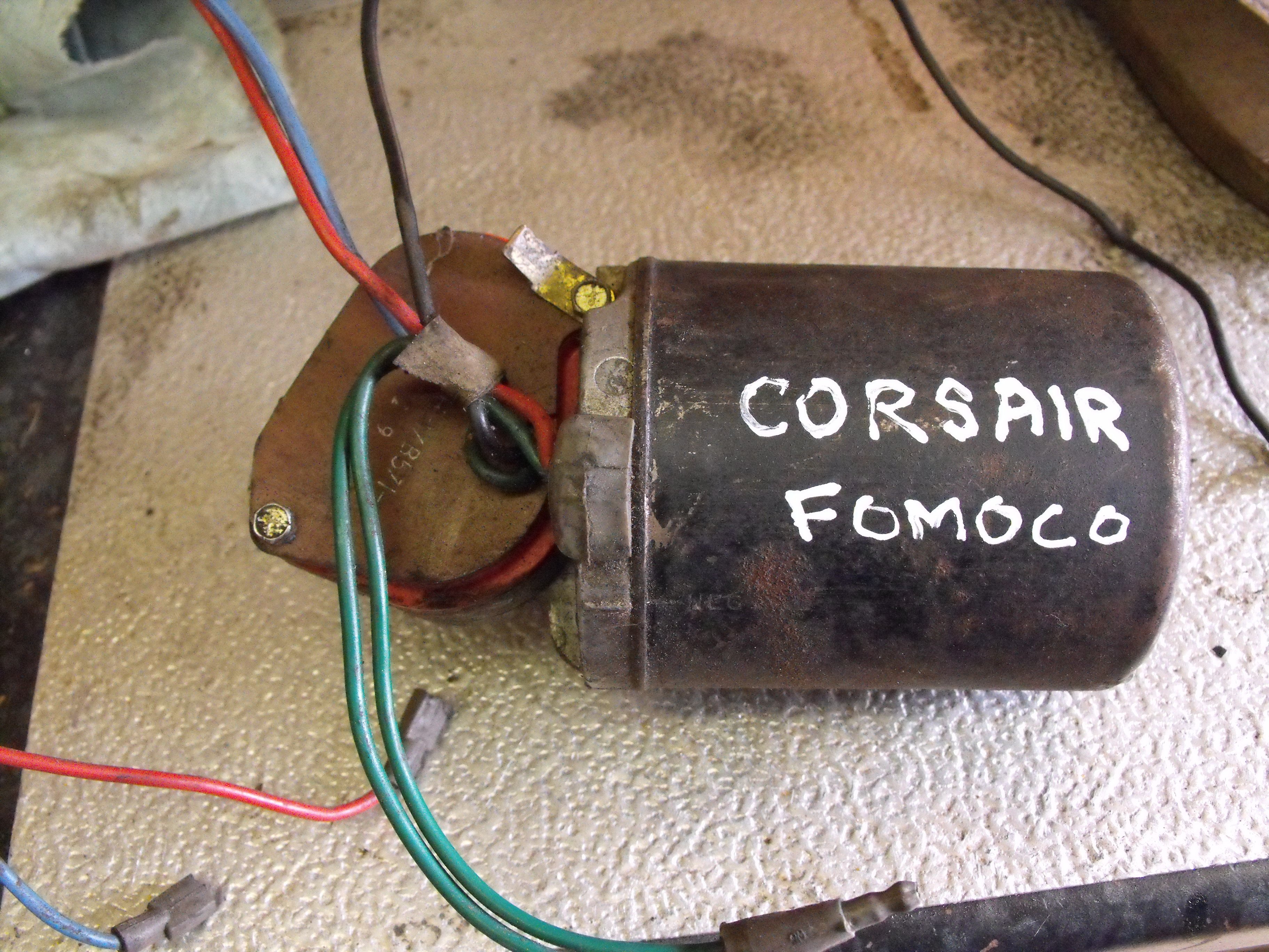

Dunno if these pics are any help to you. From my Corsair set up, I don't know if the colours are the same as mk2 tina.
Two speed switch.
Wires from left to right !  Thicker black wire goes to motor, red wire motor speed 1,  thin black wire body earth, blue wire motor speed 2.  Do not connect thick black wire to earth.
Green wire is power +  rest of wires go to the switch as listed.

Thanks for those pictures, I hope to have found a 2 speed switch stateside for a very reasonable price too.
