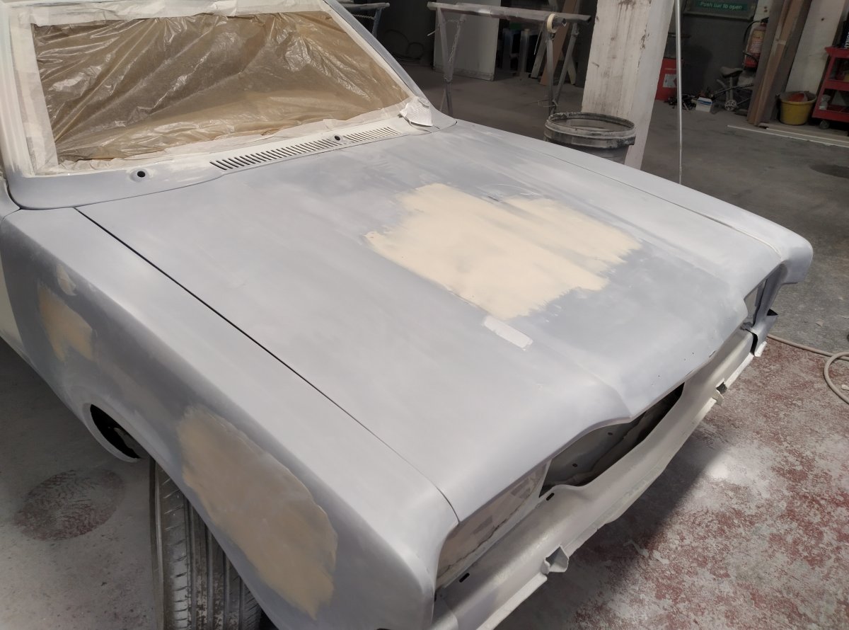

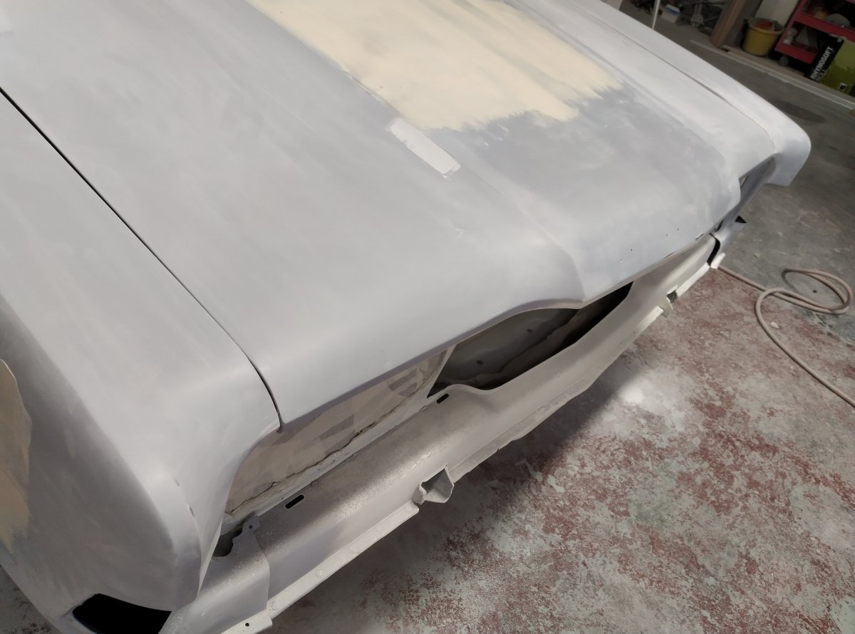

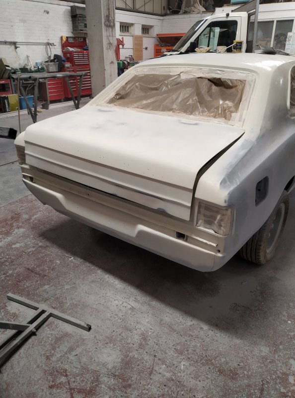

Quick visit to the body shop, bit more blending, lots of coats of filler primer onto the repairs, I'll flat these next week, then give the whole car a coat of white base , look for more imperfections and re flat

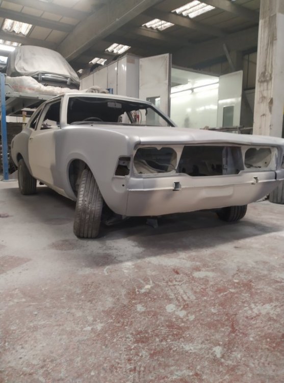

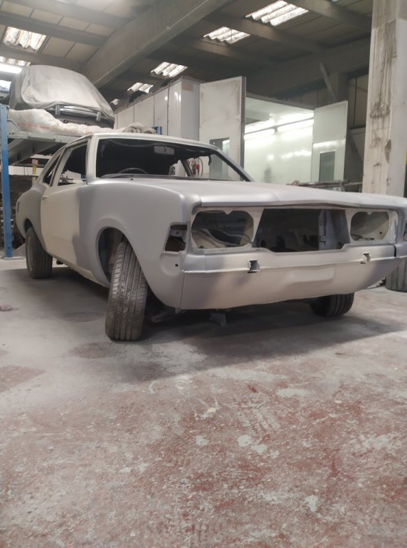

There's alot of camber on those front wheels!
  • Haha 1
Cause it's a race car Craig
That explains it all.
  • Haha 1

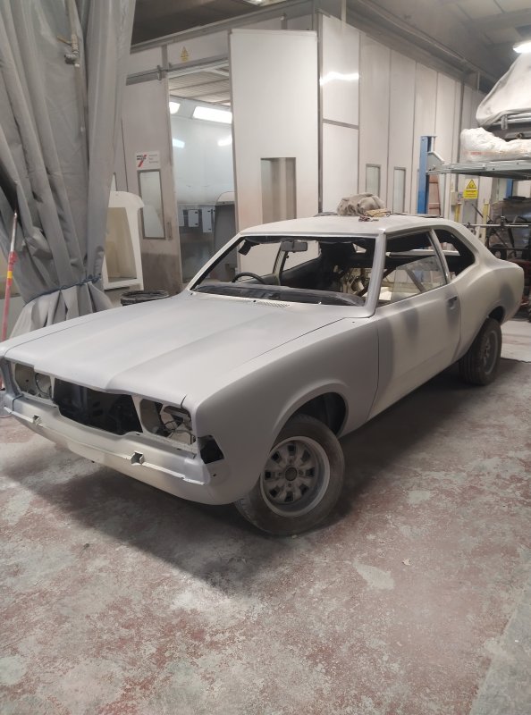

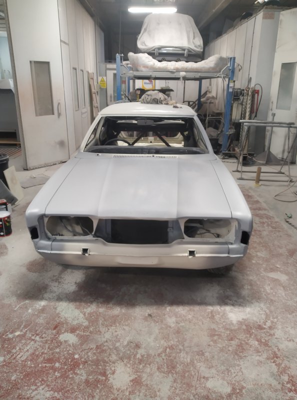

Bit more base coat and flatting done, few more panels to do before going for the final topcoats

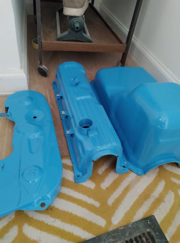

Body shop s closed, so cleaned out the garage ready for the Cortina s return, good time to paint the engine odds n sods

You got a colour for the outside ?
Looking good.
Is that a mk5 front subframe giving you the camber? Considering using a spare fl subframe on my pfl because I have a bolt stuck on stripping mine, the top wishbone pivot. Can’t get the f***er to shift. Maybe see if I can get it pressed out as a last resort unless anyone has any ideas.
Heat the tube up.
Brilliant progress, you've put me to shame, but I have painted 5 cars this year, just not mine.
Thanks lads, it's going Ermine white, it's a MK3 subframe, I just haven't got the tie bars on at the mo hence the race camber !

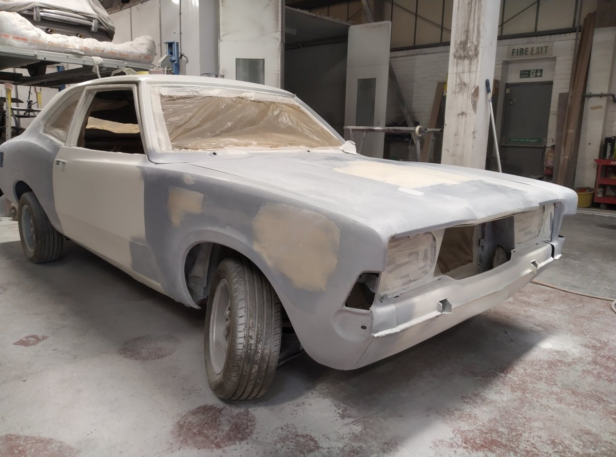

Few hours after work on the body, little skims of filler for the time served panelsIMG_20220606_171528.thumb.jpg.1a533ee4f55be7a116b2e911e1954550.jpg
