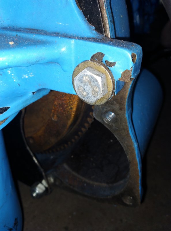

I've found one bracket but it's a made up junk lol sorry about that

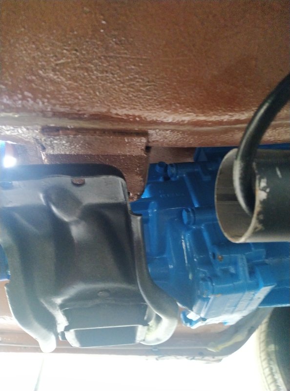

No worries mate, thanks for looking, Drilling the Sierra gearbox mount  today , tight but works

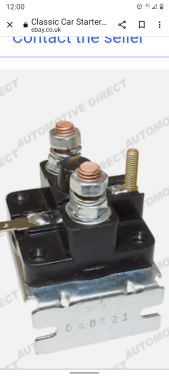

Looks like solenoid maybe wrong? Got this new one coming

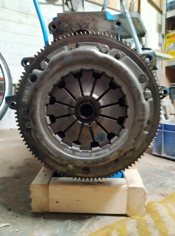

Plot thickens 110  teeth flywheel ,😌 know most are 132/135, been on eBay AA plodham list a 9 tooth starter for 110 flywheel which is a crossflow , I'm.hoping to try this , the one I have is a 10 tooth starter , could it simply be I need a 9 tooth instead of a 10 tooth?
Edited by chris mk3
Could be

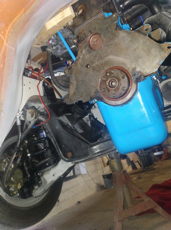

Didn't wanna go here, stripped gearbox, clutch n dreaded flywheel, but thought do it n get it done ,not the nicest of jobs on the floor under the car ,  going to source and fit the right flywheel
Edited by chris mk3
New Borg n beck clutch kit arrived, had to fit a 2.0 flywheel,(135tooth) so be changing the starter to a pre engaged starter(10tooth) , be able to see if the knacker runs soon, cheers Craig Sheffield Cortina centre for sorting me a fly wheel out 🥺😃😁
