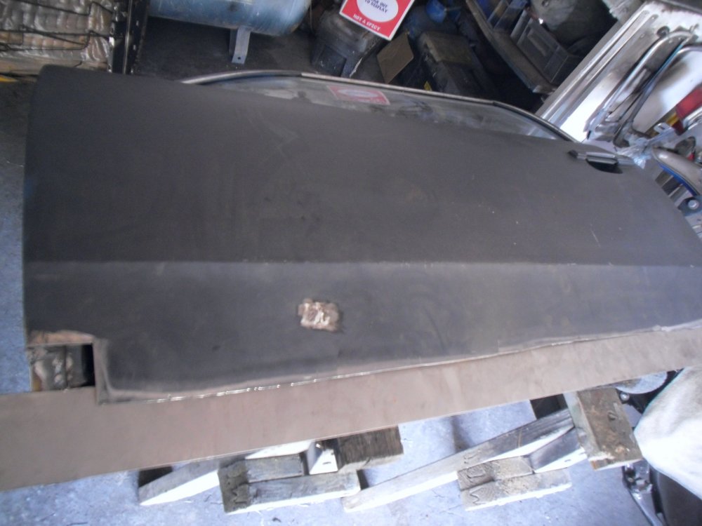

   Sliced the bottom of the doors off today , bare metalled the boor floor and doors, flicked over some etch primer

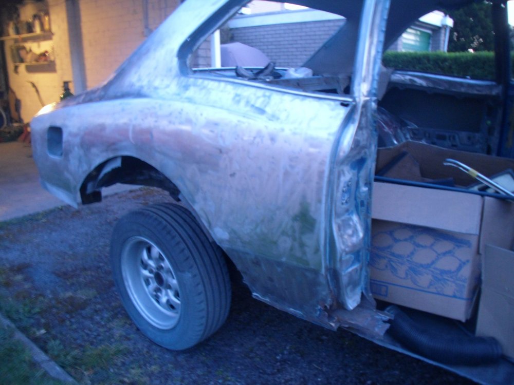

Bit more rust cut off the inner door lip, new steel welded in, im going to fit the door and tack weld the new outer repair panel on, hopefully getting a nice door to sill gap, then take it off, reweld and start to prep, skim of P40 then fill n blend, love it !
Bit more blending done on the n/s door, and a trip to Dudley i bought a really good secondhand o/s drivers steel wing for £80, was suprised how hard it is to get good secondhand wings now, smitten, that was the last panel i needed !

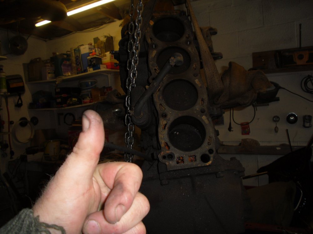

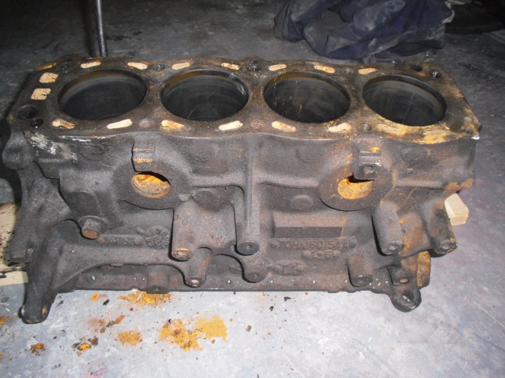

Thanks guys, finally got the Cortina home,cheeky cat nap after work ,and i got the engine out and and then stripped the bottom end, one slight score in no.1 bore, hopefully it  will hone out.
And the reason the Cortina wouldnt turn over? check out the very new looking flywheel. its been chewed up! Funny this is probably why it was parked up in 1991 and was left to rot
