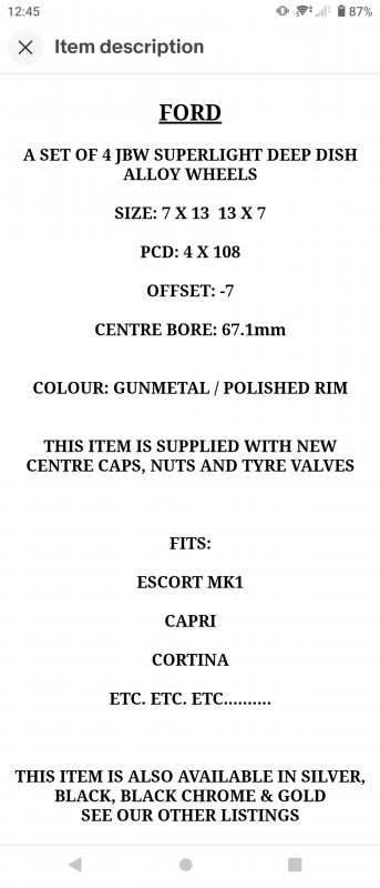

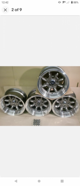

Rhys.cluett 1 Posted December 28, 2021 Can anybody tell me if these wheels will fit my Mk5 gls please ,without no issues sticking out the arches etc Quote Share this post Link to post Share on other sites

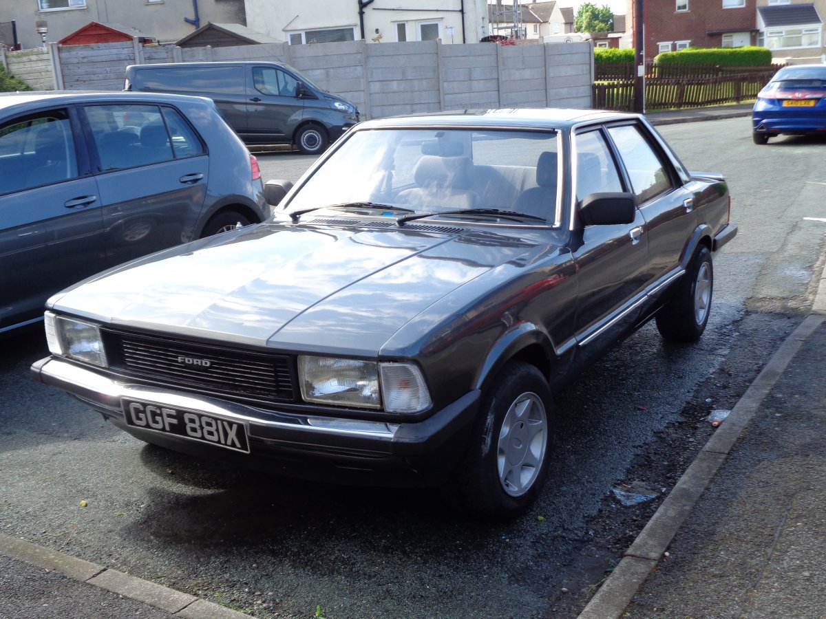

retro toe 117 Posted December 28, 2021 here mine with 7 inch capri wheels i thought they were to wide heavy steering they were sticking out a bit, Quote Share this post Link to post Share on other sites

GhiaMk4/5 207 Posted December 30, 2021 -7 offset should help, but what tyre size are you going for, I have a set of 8x15, they've been trial fitted to one of my mk5s, they fitted, can check the et on them and post you the answer in the new year, they also fitted my mk1 GT, there may be a picture of them on members cars, mk1 GT. Quote Share this post Link to post Share on other sites

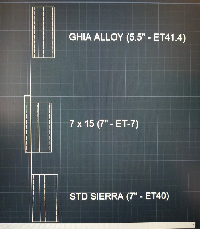

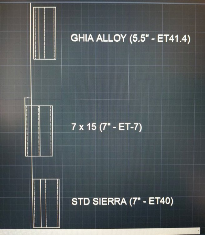

lowtina 2 Posted January 6, 2022 -7 offset is the bit that doesn't help; its the wrong way. Here's a cad representation. Those wheels would stick out 68mm more than a ghia rim. 47mm more than a 7x15 cosworth lattice. Mk5 geometry doesn't take small offset as well as mk1/2 cortinas and escorts. That said, it depends what you class as "fit". If it's not lowered, they'll go on..... Quote Share this post Link to post Share on other sites
