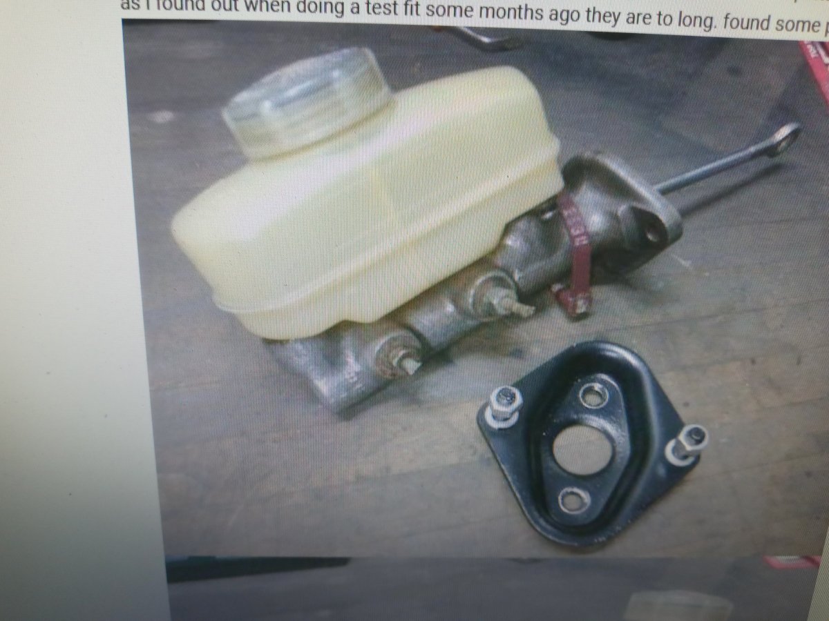

Yes , Escort one is similar/same but still horizontal . Found a pic of the adaptor .Some USA cars had a vertical mount but again , not easy to find !!
lLooks like it would fit and while searching , found a pic of one that was apparently used on a Mk2 but why it was taken off I dont know . You would have to check with Wilwood about the bore size as 1 inch is quite a bit larger than standard .
1 inch bore size will need the kick of a mule to stop it, it will be like stamping on a solid pedal...
Try to find a dual master from a 1968 "export" mk2 Cortina (it will have vertical bolt holes and will fit more or less straight on).
Or find a dual master from a 1969-70 "export" mk2 Cortina, it will have horisontal bolt holes, so you will then also need the 90 degree adaptor, from the same type of car.
Ideally, you want either 0.7" or 3/4" bore size, to avoid it beeing too heavy in operation (without a servo).
