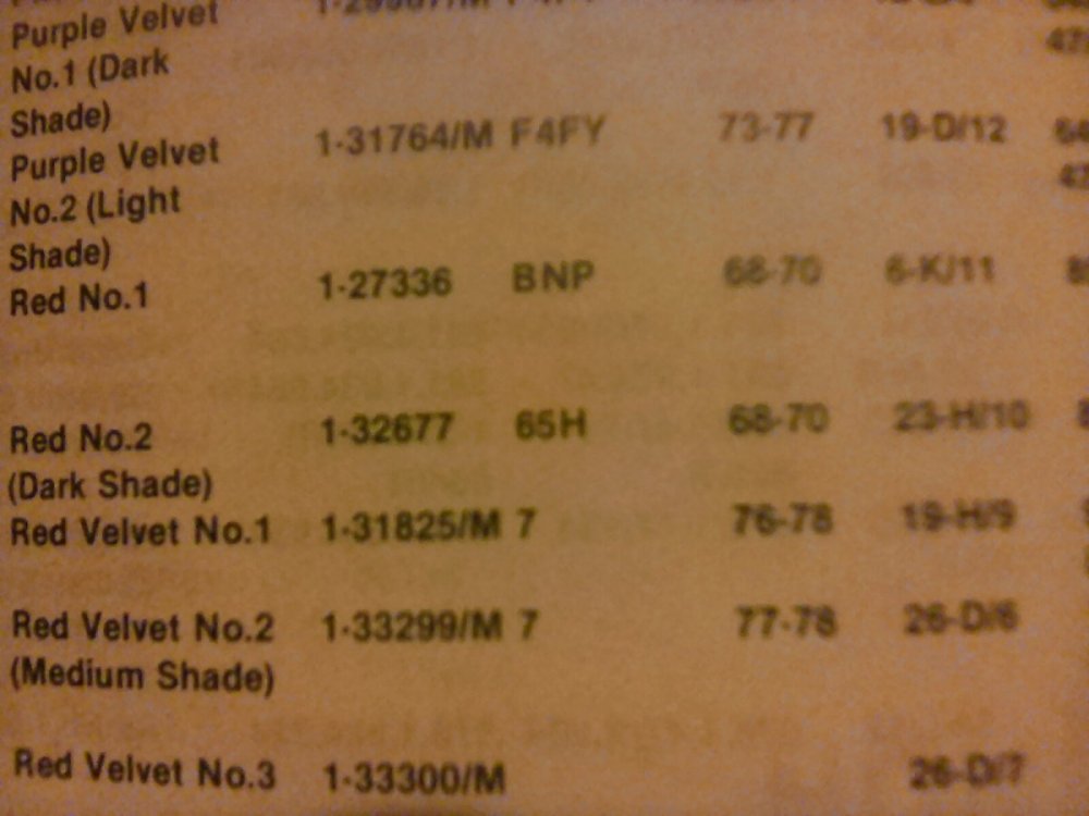

KKCortina 3 Posted May 8, 2022 Guys - the above Ford Red paint colour was used on Ford cars in 1969/70 - mainly on Mk2 Ford Cortina's and Mk1 Capri's ...... the paint code was BN or probably BNP. I am having problems trying to get a paint shop to identify and supply this paint colour from their colour match databases on their computer systems.... Does anybody have any idea of a manufacturers OWN code or reference for this Ford Red paint ....e.g. Maxmeyers/Nexa etc ....or a link to a manufacturers colour match/reference website? Quote Share this post Link to post Share on other sites
sheffieldcortinacentre 764 Posted May 9, 2022 All I can find is as follows BN = red ll 65 ( no date but in 60's ford). BNP In valentine paints edition 4 (circa 1984) Colour name RED ,year 68-70, (their ref number 31456). In AW (adult & wiborg) 1981 catalogue Name RED No1, year 68-70, (their ref number 1-27336) models escort, cortina (exc 1600E), Corsair, zephyr. Index 6-k/11, tinters gipgloss 856.855.1.47, gipgast60 851/R.934.774.1 Hopefully this might help. Quote Share this post Link to post Share on other sites

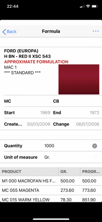

J2S 169 Posted May 9, 2022 Most old Ford colours are listed as xsc Quote Share this post Link to post Share on other sites
KKCortina 3 Posted May 10, 2022 Thanks Craig - that's a help and a start - something to go on! JS2....can you send me a link to that Ford (Europa) page..... this looks good as that is the shade of paint I think I'm after....... Thanks to all.... Quote Share this post Link to post Share on other sites
J2S 169 Posted May 10, 2022 That’s all you need there it’s from the Lechler mixing scheme Quote Share this post Link to post Share on other sites
