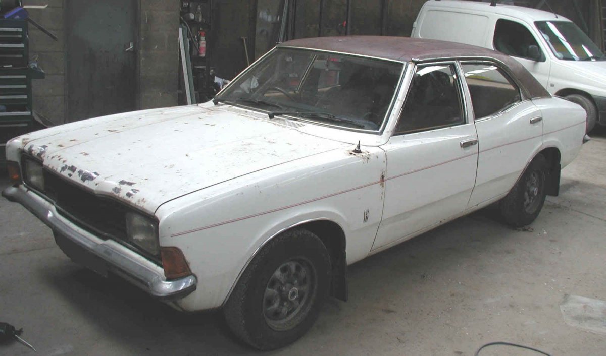

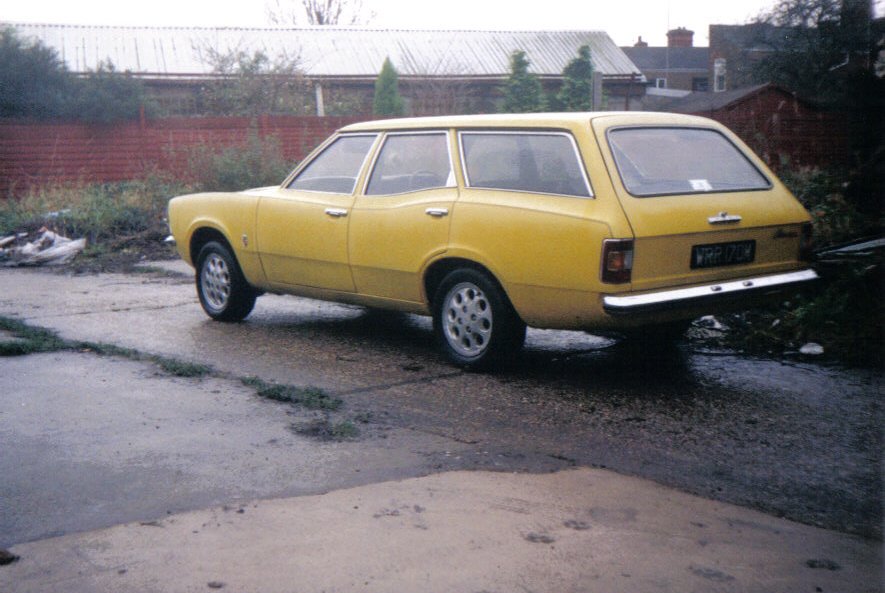

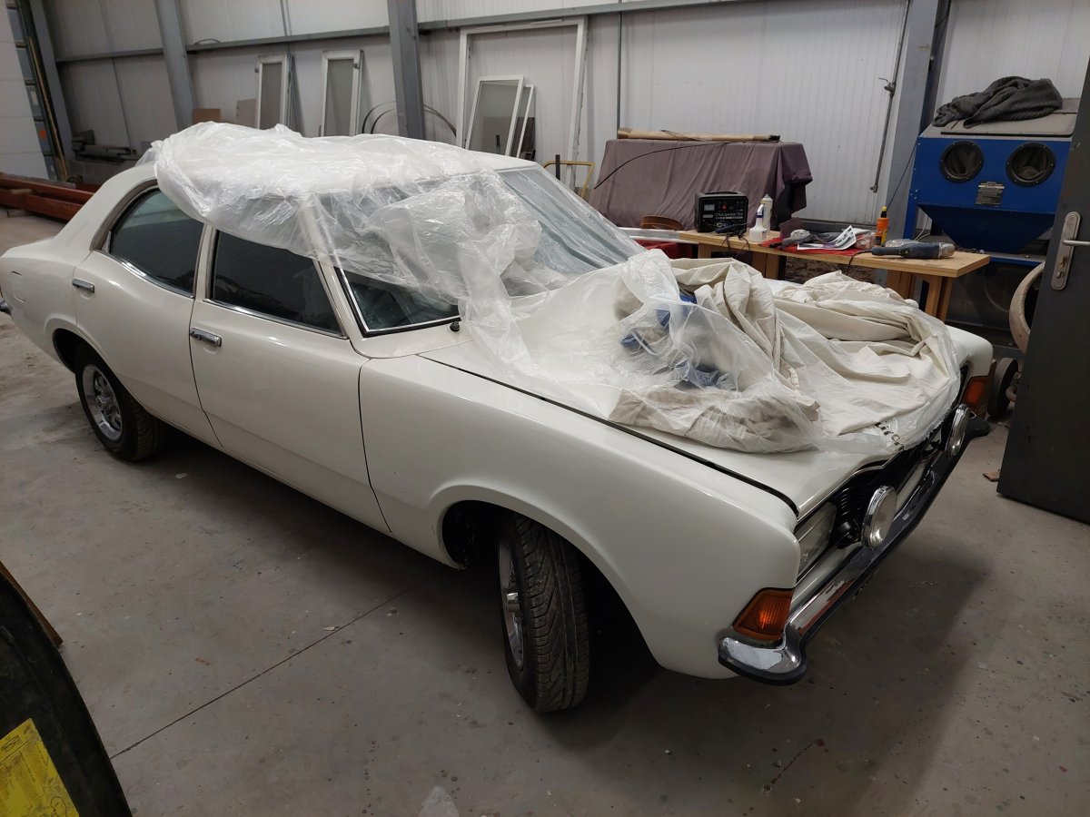

Cortina1975 29 Posted June 2, 2022 Hi all, Getting close to finishing this Mk3 just have a few little jobs to do. Does anyone know the spec of the factory coachlines (presume these were fitted at the factory and not the dealers?). I'm unsure of the exact position (should have taken measurements only have an old photo to go on when i bought the car in 2006). Presume it should follow the line of the trims fitted to the E and GXL? . Anyone fitted one of these..hints and tips gratefully received :) Quote Share this post Link to post Share on other sites

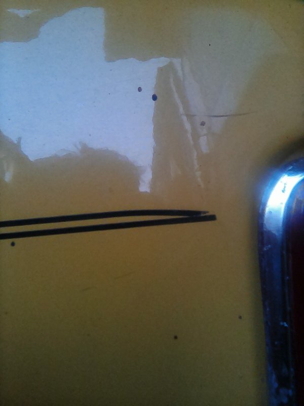

sheffieldcortinacentre 767 Posted June 3, 2022 Yes same position as GXL/E preface-lift GT is a thin pair with the top one coming down at each end to meet bottom one ( will get pic of mine tomorrow. Facelift GT is a triple stripe thin outer coming to a point at each end with a thick centre again coming to a point. 1 Quote Share this post Link to post Share on other sites

sheffieldcortinacentre 767 Posted June 3, 2022 Quote Share this post Link to post Share on other sites
Cortina1975 29 Posted June 4, 2022 Thanks chaps. I like the look of the curved stripe but it looks tricks so will practice with a bit of spare tape first. I can't see an obvious swage line so im convinced its going to look dog legged ..just going to aim for about an inch above the front indicator and the corner of the rear lamp. Quote Share this post Link to post Share on other sites
GhiaMk4/5 207 Posted June 5, 2022 I would only fit on a really warm day, and on the ends I would dab a bit of clear coat to stop the pin stripe from lifting or peeling. Lay a line of extra fine 3mm masking tape as your guide, as there is nothing worse that a stripe as straight as a donkeys leg. 1 Quote Share this post Link to post Share on other sites
Deano66 254 Posted June 5, 2022 When i did mine,i followed the shape of the body line, as i thought a straight line along a curved body didn't look right. I am thinking of a 3 or 5mm single silver stripe when it is finally finished. As GhiaMK4/5 said, a warm day,or garage & use a bit of clear lacquer on the ends to stop peeling. Quote Share this post Link to post Share on other sites
Cortina1975 29 Posted June 5, 2022 11 hours ago, GhiaMk4/5 said: I would only fit on a really warm day, and on the ends I would dab a bit of clear coat to stop the pin stripe from lifting or peeling. Lay a line of extra fine 3mm masking tape as your guide, as there is nothing worse that a stripe as straight as a donkeys leg. Thanks ghia that's a good idea about the masking tape ..I'm convinced it's going to grab and look crooked and then it will annoy me forever. I was even thinking of borrowing my brother in laws laser level Quote Share this post Link to post Share on other sites
Cortina1975 29 Posted June 5, 2022 2 hours ago, Deano66 said: When i did mine,i followed the shape of the body line, as i thought a straight line along a curved body didn't look right. I am thinking of a 3 or 5mm single silver stripe when it is finally finished. As GhiaMK4/5 said, a warm day,or garage & use a bit of clear lacquer on the ends to stop peeling. That looks like a good idea thanks Deano. Was it difficult to get the tape to bend around the curves ? Quote Share this post Link to post Share on other sites

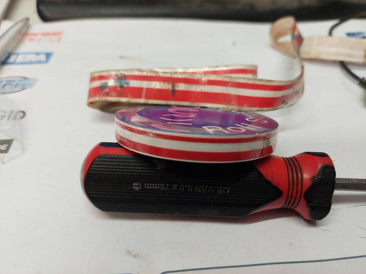

Cortina1975 29 Posted June 5, 2022 On 6/3/2022 at 1:23 AM, sheffieldcortinacentre said: Yes same position as GXL/E preface-lift GT is a thin pair with the top one coming down at each end to meet bottom one ( will get pic of mine tomorrow. Facelift GT is a triple stripe thin outer coming to a point at each end with a thick centre again coming to a point. Thanks Sir Craig, Would the facelift Gt have something like this ? https://www.ebay.co.uk/itm/275152017968 Can't decide if it would look right on an XL ..was there a 4 door facelift GT ? Quote Share this post Link to post Share on other sites
sheffieldcortinacentre 767 Posted June 5, 2022 Yes that's it, with a sorta arrow head at each end. 2&4dr same as prefacelift. 1 Quote Share this post Link to post Share on other sites
Deano66 254 Posted June 6, 2022 22 hours ago, Cortina1975 said: That looks like a good idea thanks Deano. Was it difficult to get the tape to bend around the curves ? No mate,just take your time,it was fairly straight forward. Quote Share this post Link to post Share on other sites
