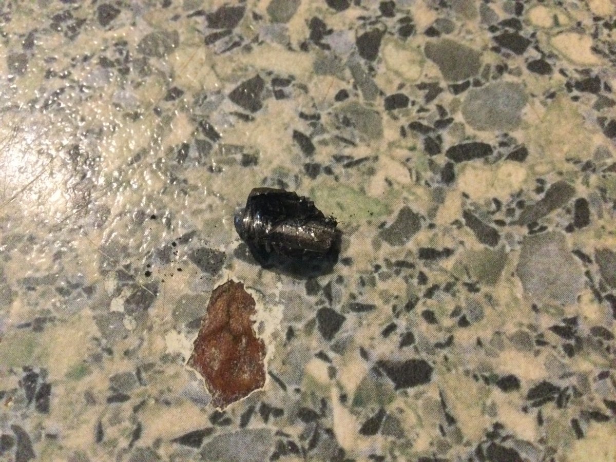

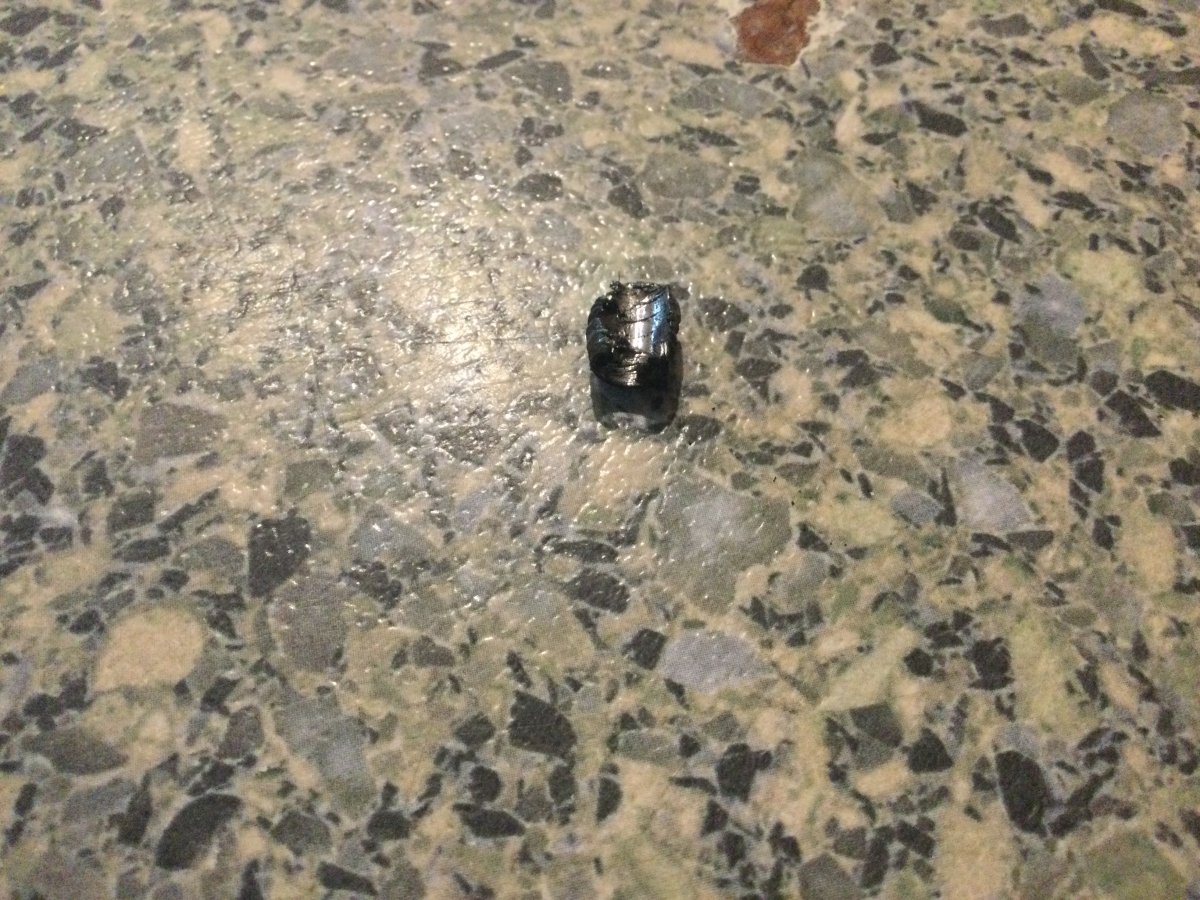

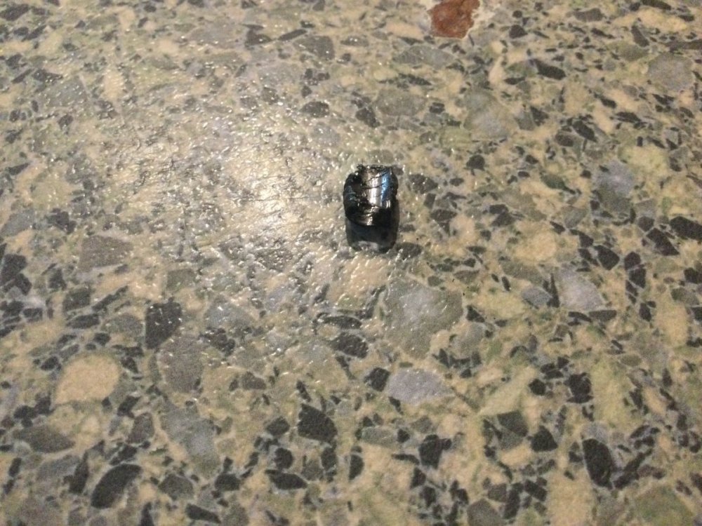

Pardon the French but I only fkn did it :). With the use of a Dremel,drill,screwdriver and hammer I got the remains lose then managed to get a pair of modelling long nose pliers on it and pull it out. Next I need to replace a hose and then see if she still over heats but so relieved.
