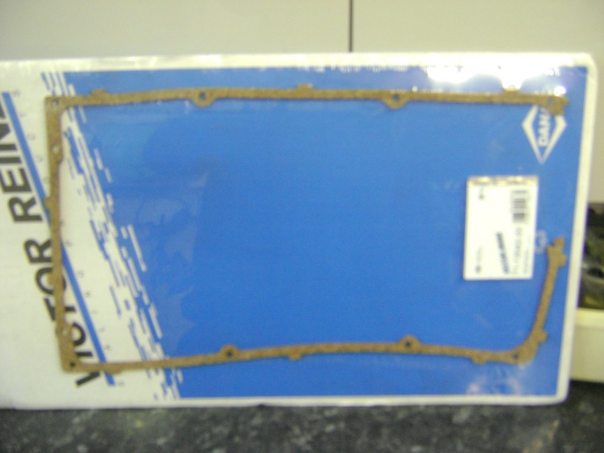

bugsntinas 29 Posted October 25, 2022 Can I ask you guys what is the gasket meant to look like. One of my local factors has ordered me one but it is one piece it has one corner cut out ,is that right,I never changed one before. Quote Share this post Link to post Share on other sites
Steve Walton 130 Posted October 25, 2022 (edited) 5 hours ago, bugsntinas said: Can I ask you guys what is the gasket meant to look like. One of my local factors has ordered me one but it is one piece it has one corner cut out ,is that right,I never changed one before. Hi, The cam cover gasket dhould look like the one in the picture. It does have what looks like a corner missing. It joins up when you fit it into the cover. Be careful the gasket will only fit one way due to the locating tabs been different on both sides. You could get a set of these after market "Washers" They do help to seal the cam cover better than the Standard Ford Ones https://www.ebay.co.uk/itm/254389273068? Good luck. Edited October 25, 2022 by Steve Walton Added to 1 Quote Share this post Link to post Share on other sites
bugsntinas 29 Posted October 25, 2022 3 hours ago, Steve Walton said: Hi, The cam cover gasket dhould look like the one in the picture. It does have what looks like a corner missing. It joins up when you fit it into the cover. Be careful the gasket will only fit one way due to the locating tabs been different on both sides. Good luck. Cheers for that Steve I really hadn’t a clue :). Will have to wait for some decent weather now. Quote Share this post Link to post Share on other sites
