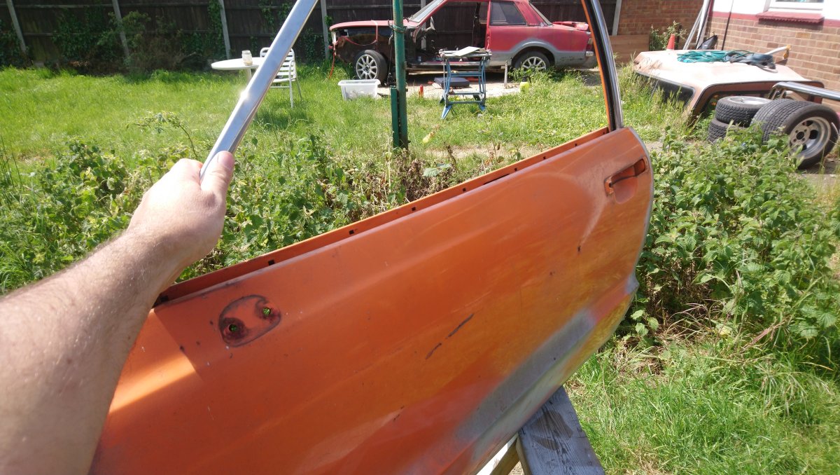

I picked up some replacement doors. Anyone know if this awesome orange was a Ford colour, or a custom job? They have been very well painted (unlike my car).
Apologies for the messy garden.

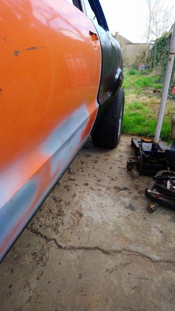

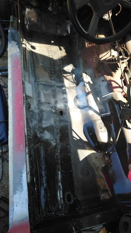

The inner wing, sills and a-pillar are done on that side, and the floor will be finished this afternoon. Then I need to turn it round and start on the other side...
looks like "signal orange" to me:
Edited by consul315

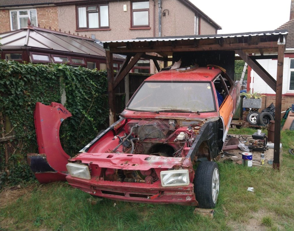

Floor in... Now to repair and refit the cross brace
P. S. My welding may not be pretty, but... I needed to raise up the far corner of the new footwell to meet the trans tunnel. Easy, I thought, just stick the trolley jack under it. Except it just lifted the car by my new panel. So I don't think it's going anywhere...

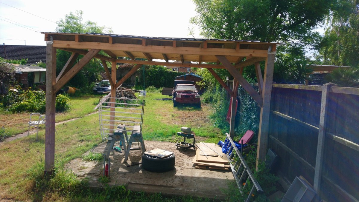

Annoyed by the rain stopping play, I spent some time over the winter making this as a quick stop-gap until I can get the proper workshop built...

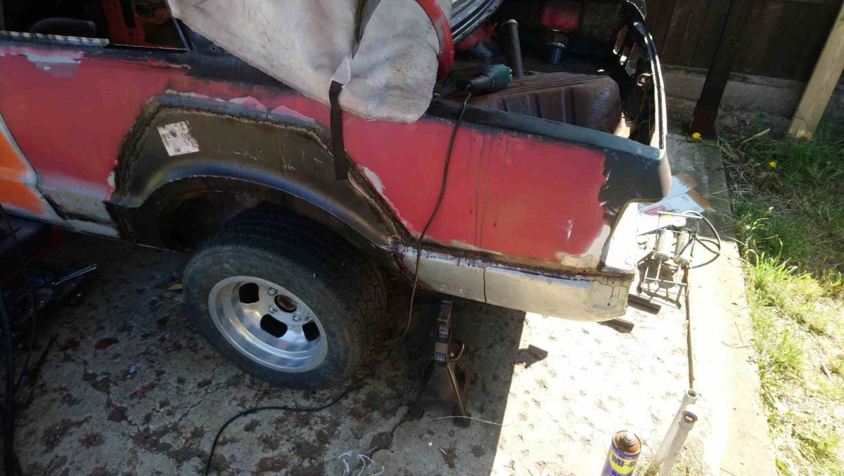

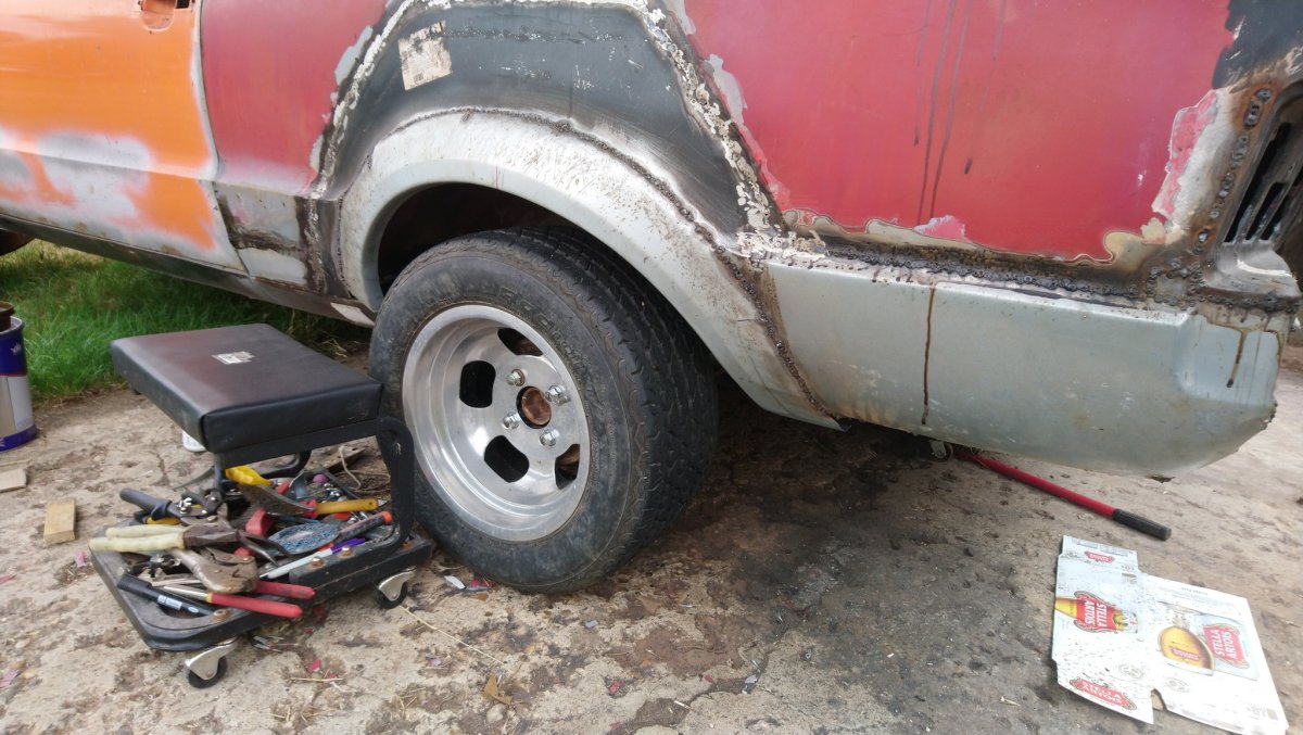

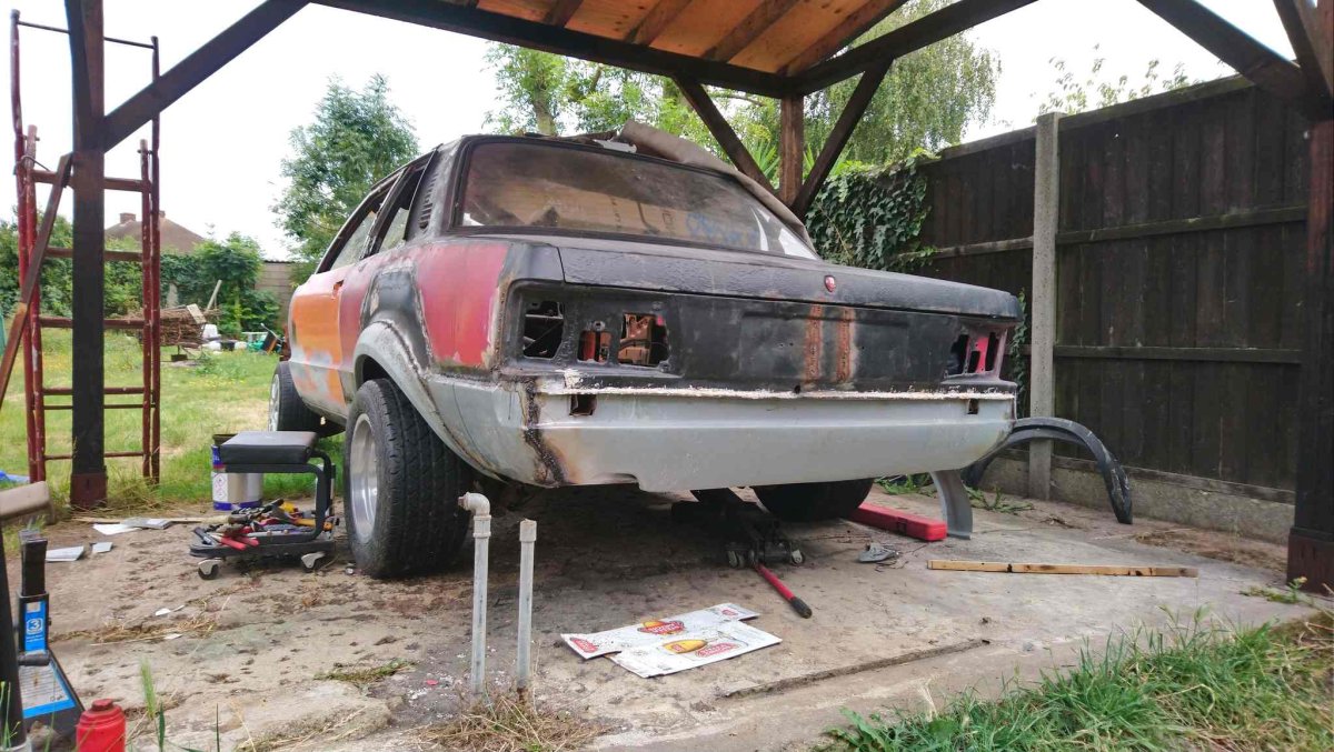

The workshop will be across the back of the garden, but lots more work needed first. But then I got feeling guilty about having not touched the car in 2024, so I cracked on with the inner and outer rear valances, inner and outer lower quarters, and the rear arches. I then popped the new wheels on to see how it would look.

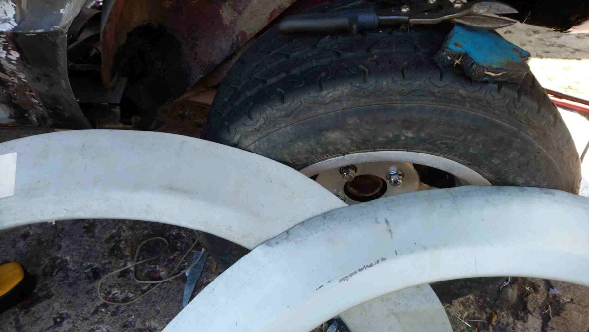

A bit pokey-outey I think is the technical term. I had some wheels wider than the arches on an old truck and all that got me was an advisory at MOT time. But as I live 2 streets away from the police station, I don't really want to invite any unnecessary bother. So...
Mk3/4 Escort arches. They are concave as standard, but I re-worked the top edge so it's convex. The one on the right is quite early in the process - it had a bit more work before fitting. Bu it got me to this...
The very bottom on each side of the arch needed a bit more work to fit , and they came down too far but all got chopped and hacked in to shape..

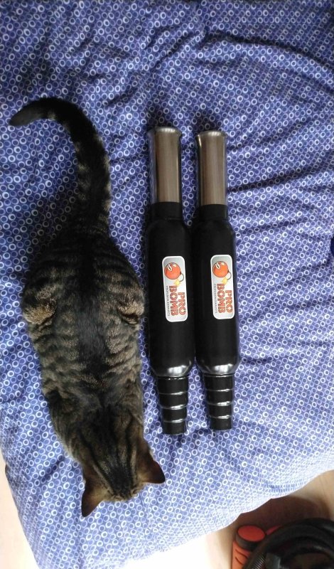

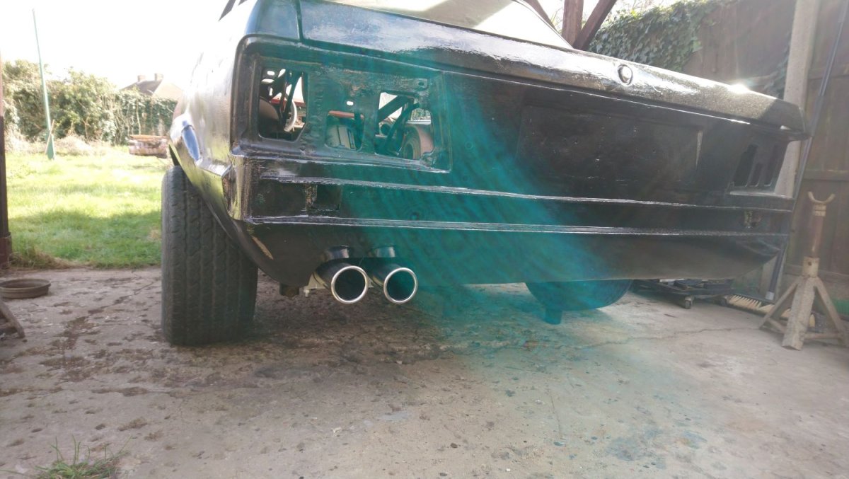

I am sure you hawk-eyed lot will have noticed that the valances aren't finished at the exhaust cut-out. I am going to fit twin pipes, so that will be widened in due course. Then it was time to jack it right up and sort the inner arches
I hope to finish welding the back end this weekend. Then I can slather the underside in paint, and re-fit the fuel tank and axle, and turn it around to attack the scabby front end.
Back in the late 80's (dinosaurs hadn't been extinct for long) I made a matching cut out on the opposite side ( fuel tank was a MK1 Capri item under rear shelf) so I could fit a slightly modded MK3 Capri system to match the 3.0 V6 I'd fitted.
I hadn't thought of re-siting the tank, but I want to LPG it at some point so that will probably go where your capri tank went.
Using a carboard template, these should fit OK side-by-side. I didn't think I needed a cat on a '79 car, but the guy in the shop insisted...
:laugh:
Fit that cat and the animal rights mob will be onto you.
Be purrrrfect.
Yep similar idea did that on MK3 facelift V6.
.torpedo tubes fitted, and valance finished. Ignore the awful paint job, it's just to protect while I am working on the car. I will worry about prettying it up later
