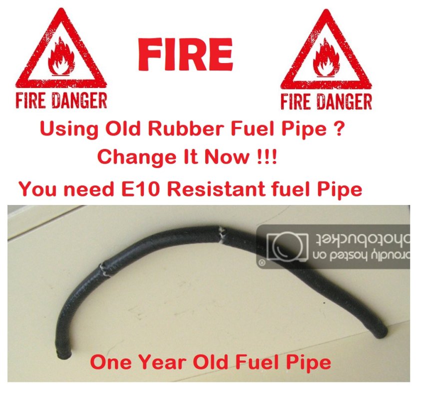

* * * WARNING SAVE YOUR CORTINA Fuel fires * * *
Just replaced it on my Mkl, it's very clever of these intelligent people to put an additive in that actually does this to fuel pipe rubber and associated injection parts.
I'm surprised Fuzz didn't talk about removing ethanol
When I store my classics, I put fuel in to clear containers, add a cup of water, give a good shape and leave upside down due 24 hrs
Then, drain the water and ethanol that settled at the bottom and pour the neat fuel in to the tank
