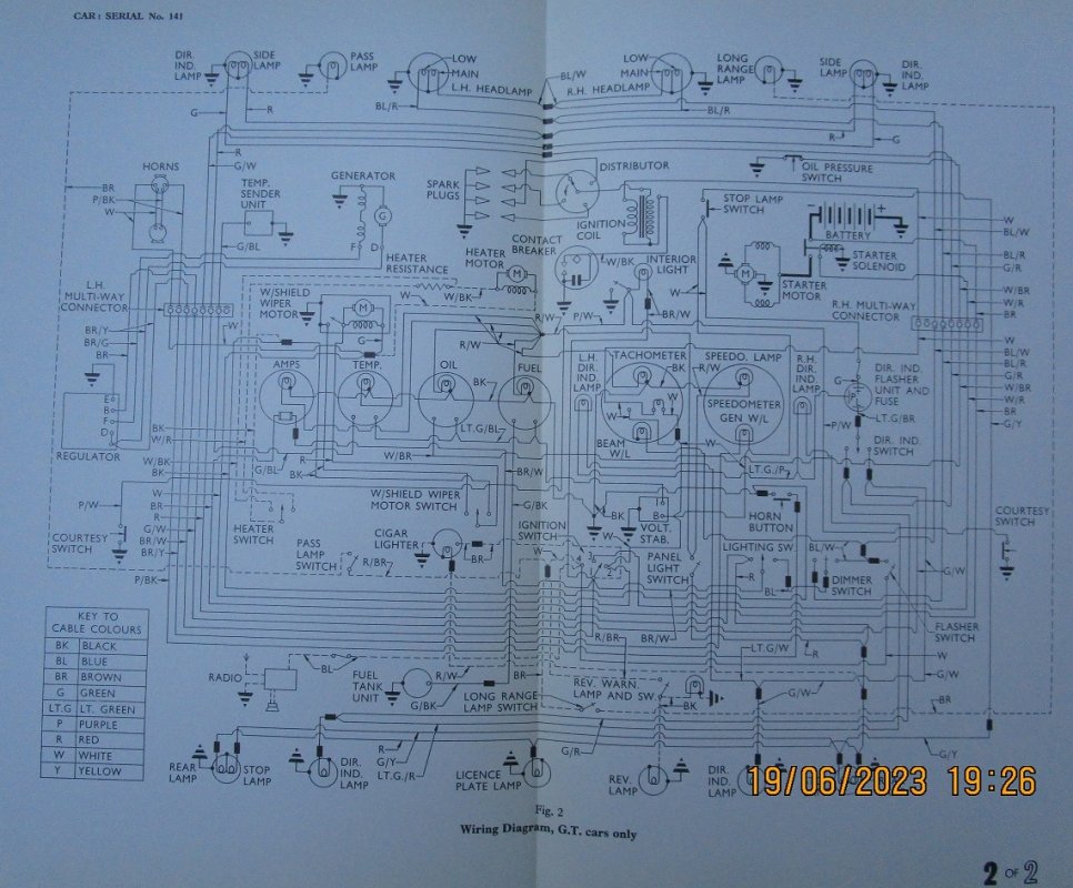

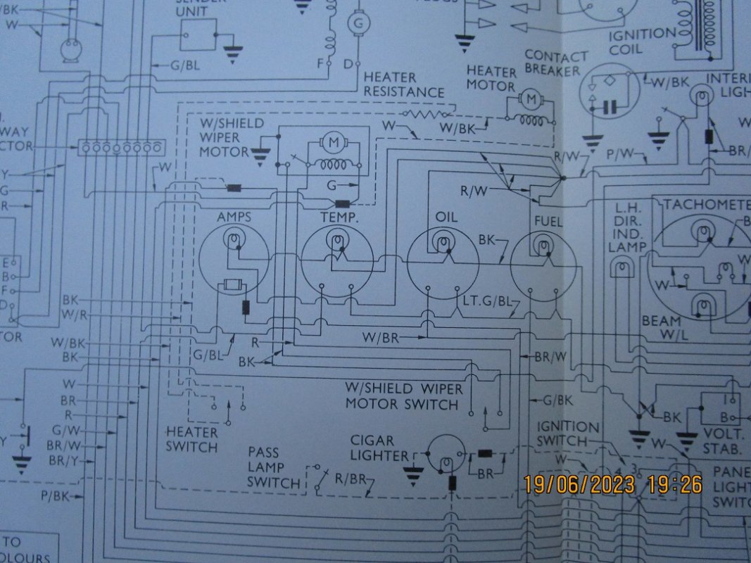

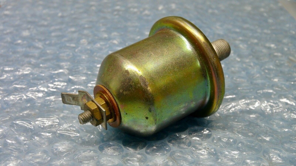

The Oil is fed by a specific sender screwed into the block on a 1/8 NPT thread.

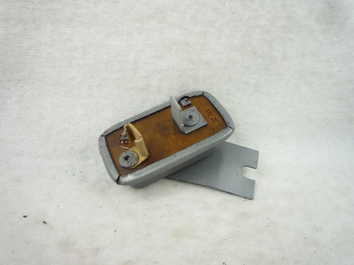

The Fuel gauge has a feed from the 5v voltage stabiliser on the back of the speedo. The other side goes to the tanks sender.
Temp gauge has a feed from the voltage stabiliser and the other side goes to the sensor in the head.
Amps is standard wiring with heavy cable.
