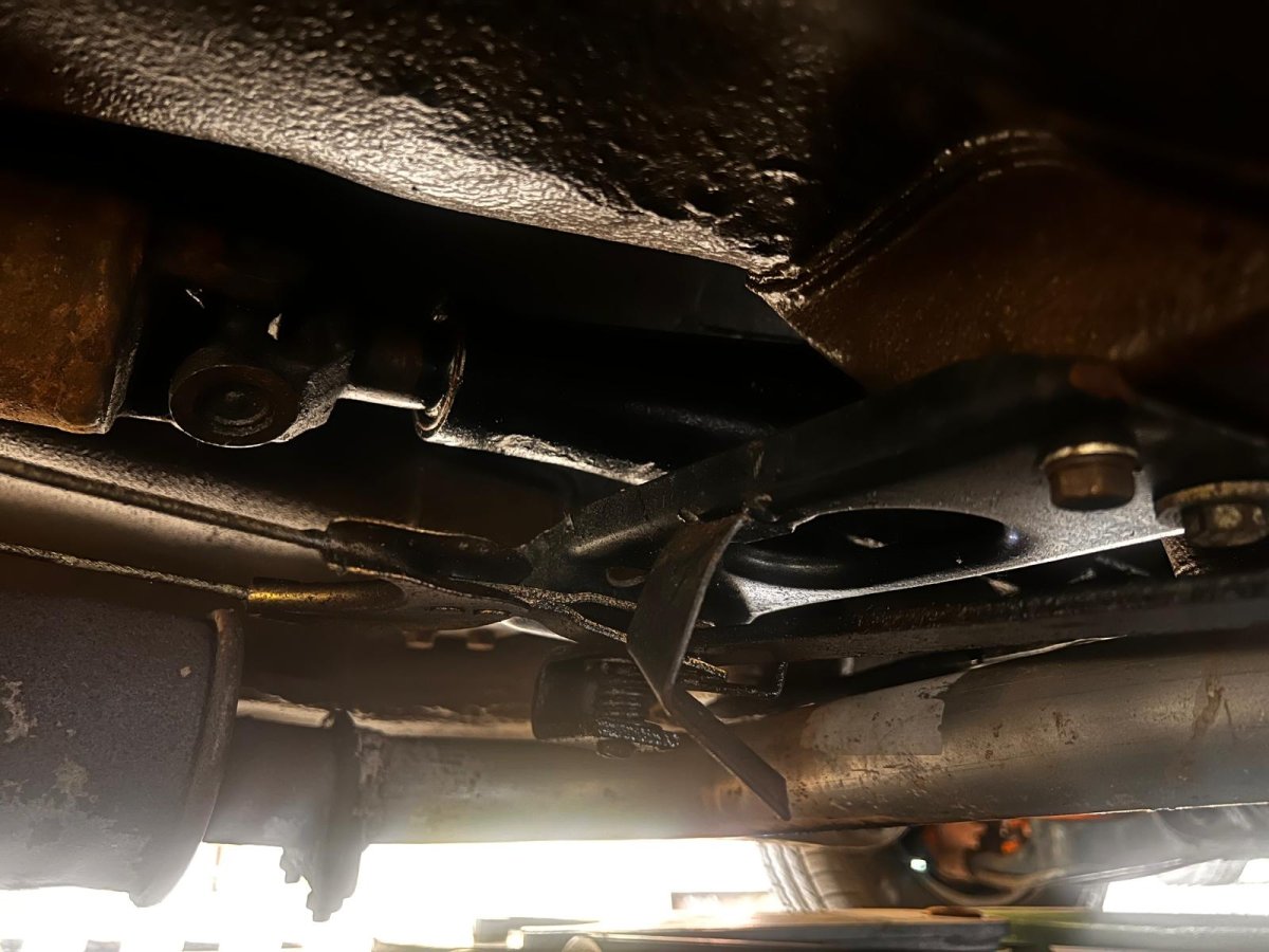

Has anyone got an Umbrella type Handbrake to work with Sierra Rear Discs/Calipers ? I have made a bracket with a pulley wheel to give it a straight pull but there there is no leverage with this type of Handbrake in its standard form.
You need to make a sprung lever system under the car but I was told the disc brake conversion didn't work with dash handbrake.2085888686_WhatsAppImage2025-03-22at14_14.15_0715bef1.thumb.jpg.0f32635e2c227ab3beedfaa8e109a69d.jpg
