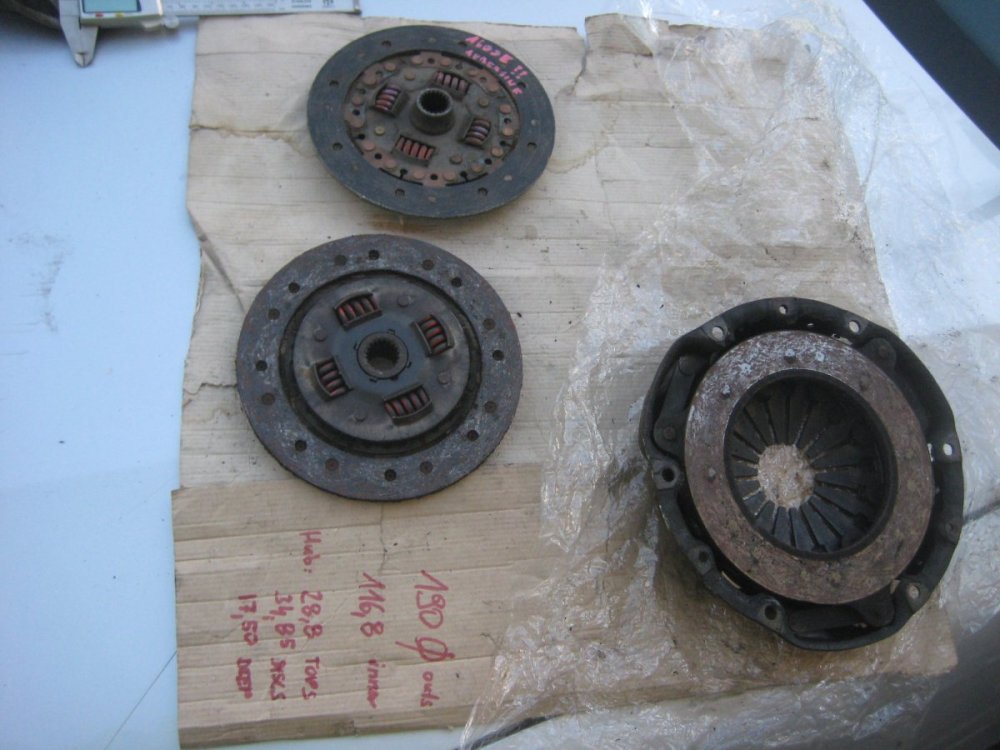

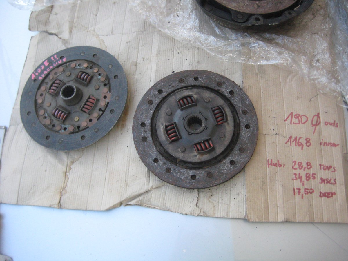

consul315 180 Posted January 26, 2024 does the cylinder look like this? Share this post Link to post Share on other sites

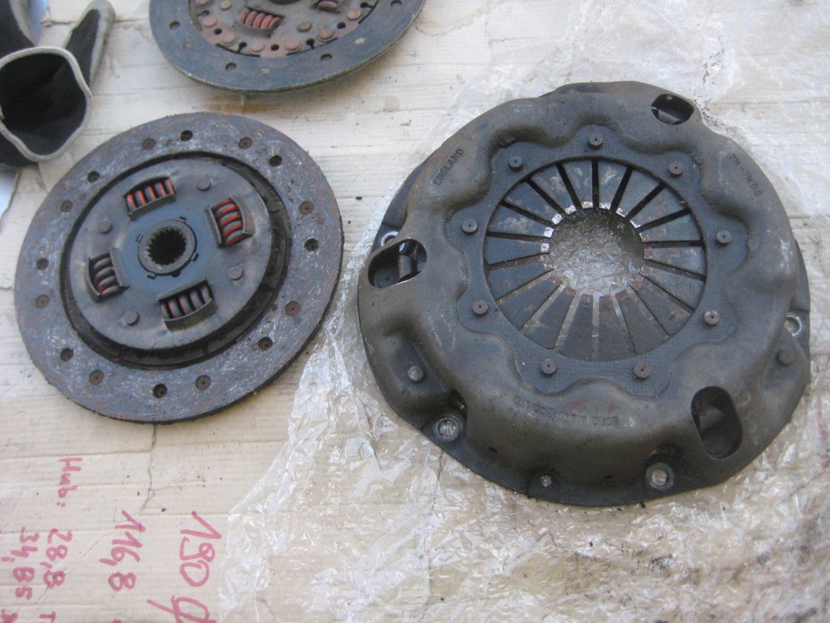

consul315 180 Posted January 26, 2024 and teh clutch like this? Share this post Link to post Share on other sites

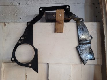

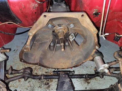

DMT 1 Posted January 26, 2024 Hi Guys, thanks for all the great info. My clutch parts look the same as the pictures the only difference being that I have yellow springs on the friction plate with the same 20 splines. The only ID I can find is the number 47238 on the friction plate which ties in with various old MGs and Triumphs. I have a replacement plate part No. CL1 from the club it has no markings on it.. I can't confirm the bell housing number but it looks like the photo, I note that this has internal ribs that are not present on the ones illustrated in the parts list book or manuals, so the larger standard driven plate would probably foul. I found a picture of a Mk1 Lotus housing which has ribs and a diaphragm clutch but the slave cylinder mounting is different. The slave cylinder looks the same as in the supplied photo, with the code G7F stamped on the body, it is very much the big brother of the Mk1 cylinder I have bought. The plate between the back of the engine and the gearbox is as per the photo which is different from what I expected on a Mk1, might this be a MK2 part as well? Share this post Link to post Share on other sites
